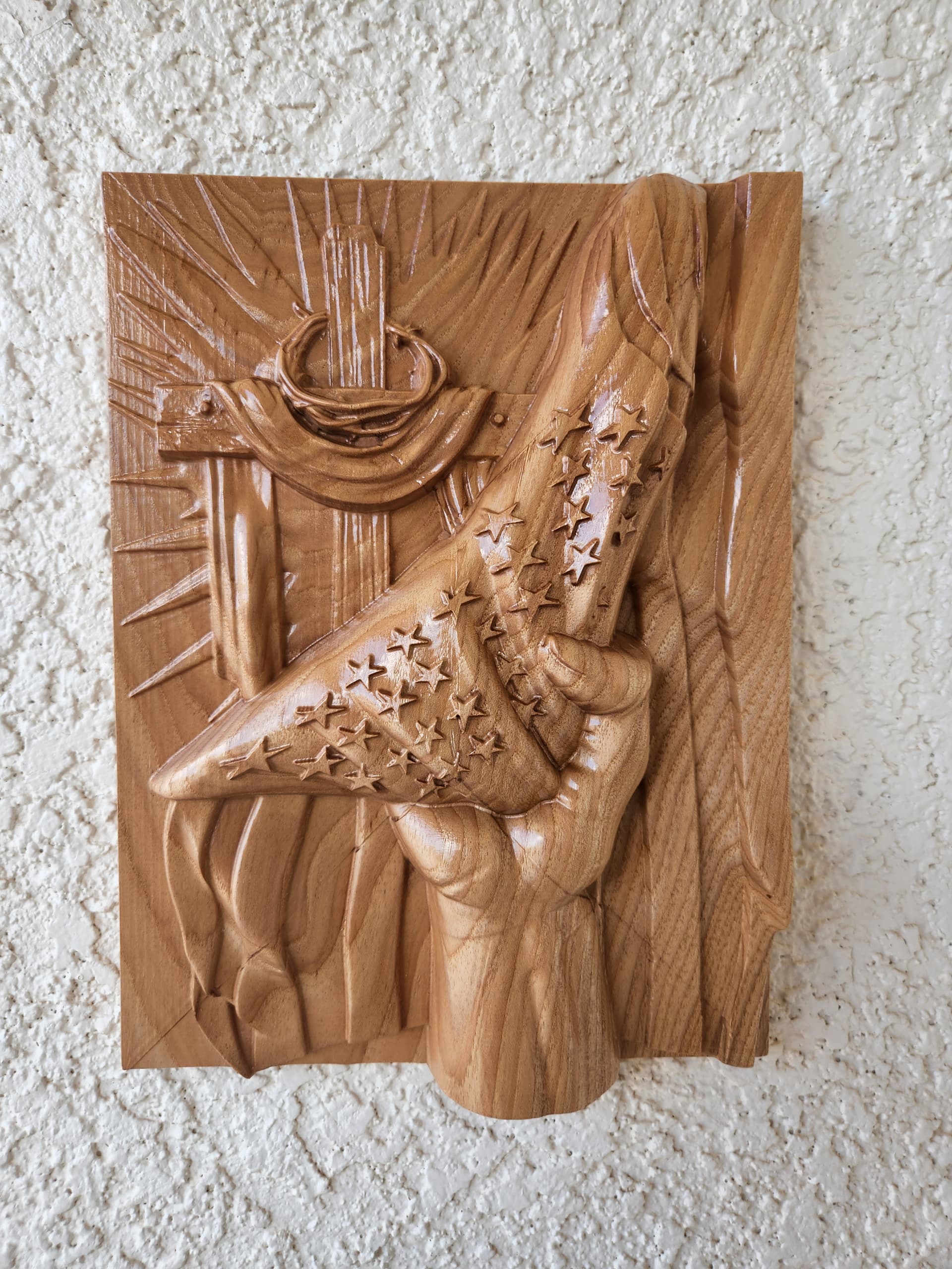

I’m a fan of cherry…
I have also used mesquite, hickory, maple and mahogany.
Cherry is my fave (heart)
Mahogany was really stringy and difficult to and. (Cross)
Hickory was a piece of firewood i saved (flag pulled down cross)
Maple came out well (bible quote)
Mesquite came out awesome, especially given design choice. (Tattered flag)
 ![20230104_120551](https://us1.discourse-cdn.com/flex022/uploads/onefinitycnc/original/3X/d/6/d6efb8b80f701fa4abbf1c23b03b8290d61f5d34.jpeg)
 ![20230216_181540](https://us1.discourse-cdn.com/flex022/uploads/onefinitycnc/original/3X/0/3/0309113a4fd9972e24662d241bbfc6fbdfd12cf2.jpeg)
 ![20220706_161819](https://us1.discourse-cdn.com/flex022/uploads/onefinitycnc/original/3X/d/3/d3e9daad17fe7733efda2b9caca06179e0807c2c.jpeg)
 ![20220509_084723](https://us1.discourse-cdn.com/flex022/uploads/onefinitycnc/original/3X/d/b/dbf80ee2992702e5ccfde3634024d469f6f861ca.jpeg)
 ![20220207_170859](https://us1.discourse-cdn.com/flex022/uploads/onefinitycnc/original/3X/8/5/85c2015d4c381cc6d1fe40b85321ce8632543455.jpeg)
**Author:** ![ChrisS](https://sea2.discourse-cdn.com/flex022/user_avatar/forum.onefinitycnc.com/chriss/32/22864_2.png) [@ChrisS](https://forum.onefinitycnc.com/u/ChrisS)\
**Post date:** [March 6, 2023, 3:19pm UTC](https://forum.onefinitycnc.com/t/wood-types-for-3d-bias-relief/19222/3 "2023-03-06T15:19:44Z")
> [@Hobbyist](#):
> All I see on Etsy are darker wood, but maybe they just photograph better
That’s probably because there’s not many hardwoods that are light and they all get darker when finish is applied… maple is all i can think of, that is lighter.
