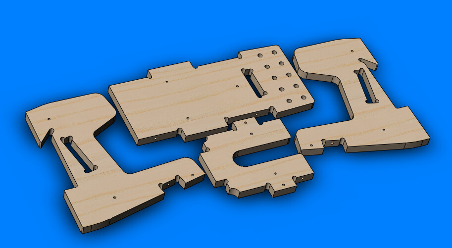

Let’s say I want to create a program to cut these 4 shapes in a single program.

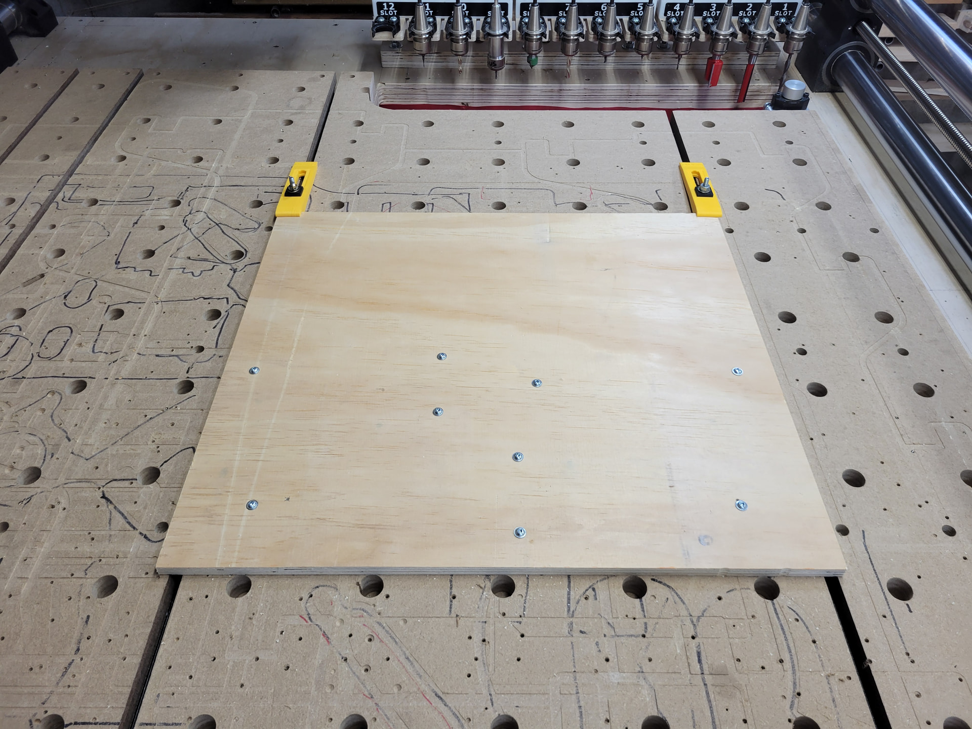

I will load a piece of material on the spoilboard, clamp it down with plain old t-track clamps, and start the program. Right from the start, the program will drill a bunch of 1/8” holes.

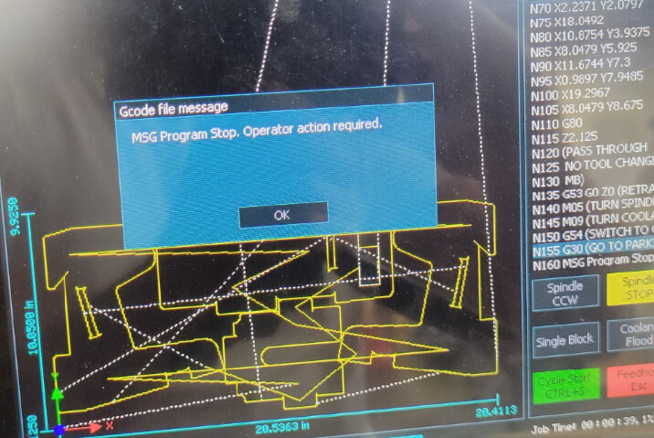

 ![image](https://us1.discourse-cdn.com/flex022/uploads/onefinitycnc/original/3X/5/0/50fc45d85e2152714b4860e309b067daf5a15c06.png)
The spindle retracts, stop spinning, then heads over to the parking position I’ve set on the Masso F4 screen. Then it displays a message on the Masso screen, and waits there.
 ![image](https://us1.discourse-cdn.com/flex022/uploads/onefinitycnc/original/3X/9/6/96efec39071e5c77c9040f5e734ccba3d133fa07.jpeg)
While the spindle is sitting idle at the back of the machine. I will put a screw in each of the holes the machine just drilled, and I’ll remove whatever clamps might get in the way of the rest of the program.
 ![20251016_123056](https://us1.discourse-cdn.com/flex022/uploads/onefinitycnc/original/3X/b/1/b15592be74df39a3b1f3187001bd4a311f4d0efe.jpeg)
Then I will press the green “cycle start” button on the controller, the message will disappear from the Masso screen, the spindle will spin up again, and proceed to start cutting again. The screws are strategically placed to hold all the individual parts down as they are cut and separated from the rest of the stock.

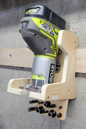

Parts are done, in a SINGLE program, and can be assembled!
**SHAMELESS PLUG** : These parts are for a trim router holder available as a digital download on my [Etsy](https://stingraydandm.etsy.com) page. A great project to try this technique.

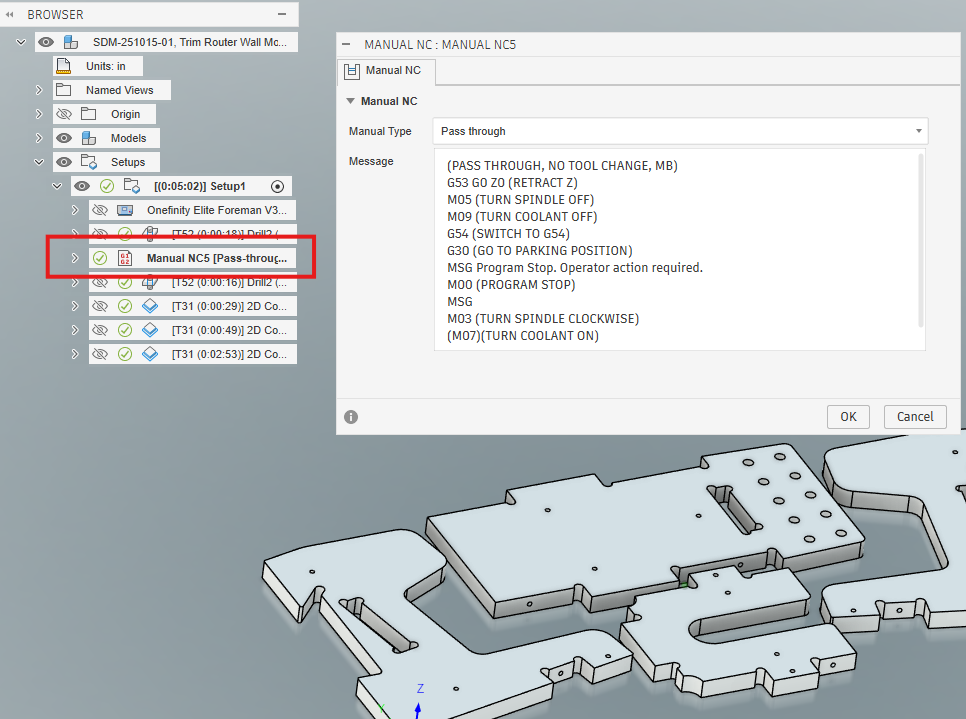

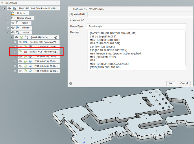

**How do you insert lines of G-code in?**
Fusion has a super handy “Pass Through” feature that will allow you to type out the lines of G-code into fusion. Fusion will directly send those lines into the toolpaths when you post.
You can even store the entire block of code in as a template and paste it all in just a few clicks. No need to memorize the code.
 ![image](https://us1.discourse-cdn.com/flex022/uploads/onefinitycnc/original/3X/1/e/1e5f63b3c1c0a03f20b21bf4c2a8c87fa4978365.png)
I’m not sure if Vectric or other CAM programs can manually insert G-code through the program or not. You can always insert the added lines manually in a text editor after it’s posted.
