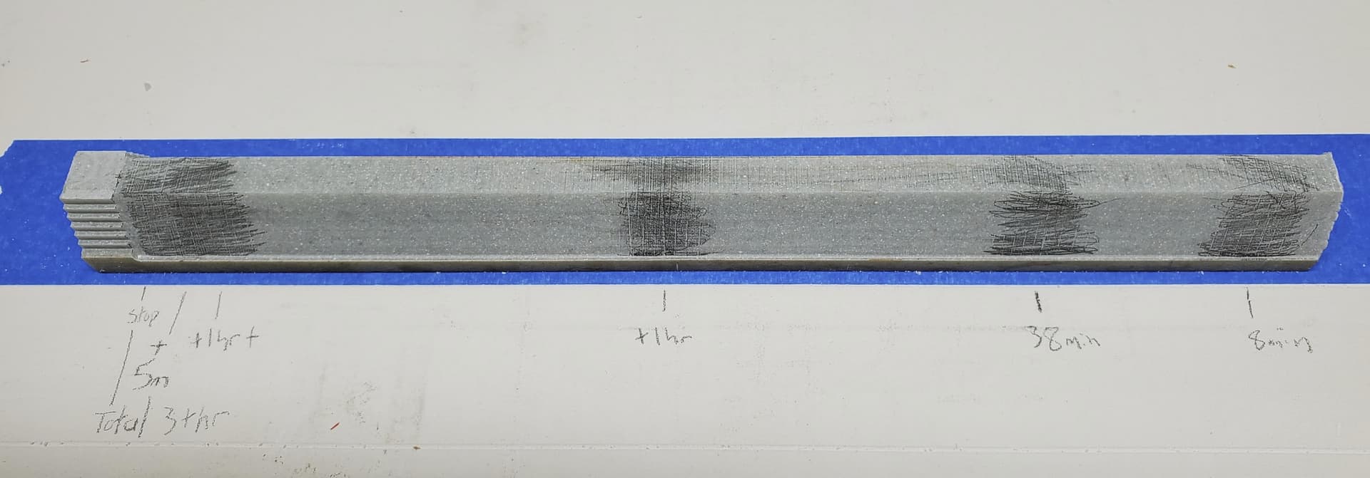

Ok, I did everything suggested and made a basic test tile to run from right to left. Part of why this is so tricky is that it only seems to be detectable after the machine has been running for around 4 hours or so continuously. Did this test last night, stopping and resuming 6 times over the course of about 3.5 hours, and noticed almost no height change at any of the stopping points. One slight change in the middle at about 1hr 38min run time, but only about 1/32” or less. Very minor, and no detectable changes at any of the other points where I stopped and resumed.
 ![3.5hr test](https://us1.discourse-cdn.com/flex022/uploads/onefinitycnc/original/3X/a/c/acb2debe9d6139a2d79061040696a44157b18f8b.jpeg)
Then today I ran a similar test, but let it run for a little over 4 hours before I stopped and resumed. And here we have the same problem I’ve been dealing with, a significant drop, only this time in the opposite direction, as I expected from a right to left toolpath.
 ![Screenshot 2025-10-25 171838](https://us1.discourse-cdn.com/flex022/uploads/onefinitycnc/original/3X/2/4/24759ede4f63d1b3a0681779593c7f7b4ab0ab1e.jpeg)
 ![Screenshot 2025-10-25 171829](https://us1.discourse-cdn.com/flex022/uploads/onefinitycnc/original/3X/7/e/7ef6eed4a1c9c5118270c8aedc825192a1ed9aff.jpeg)
Any ideas?

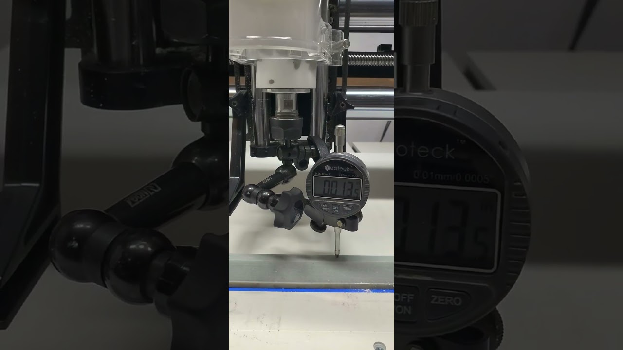

Here’s some dial indicator action. Seems very conclusive as to what’s going on. Should have tried this a long time ago…
Looks like it’s constantly slowly gaining height in z as the program goes along until stopping and restarting the program which initiates a new tool touchoff which brings it right back down to the actual zero.
[![](https://us1.discourse-cdn.com/flex022/uploads/onefinitycnc/original/3X/b/2/b279957ae0fb6447aab63d80bd4cd7549781645e.jpeg "Onefinity Journeyman Z Height Changes Part 2") ](https://www.youtube.com/watch?v=H1ZDhfoWQEs)
**Post date:** [October 25, 2025, 10:23pm UTC](https://forum.onefinitycnc.com/t/z-differences-when-resuming-long-programs/35936/21 "2025-10-25T22:23:59Z")
What are the indicator units?
