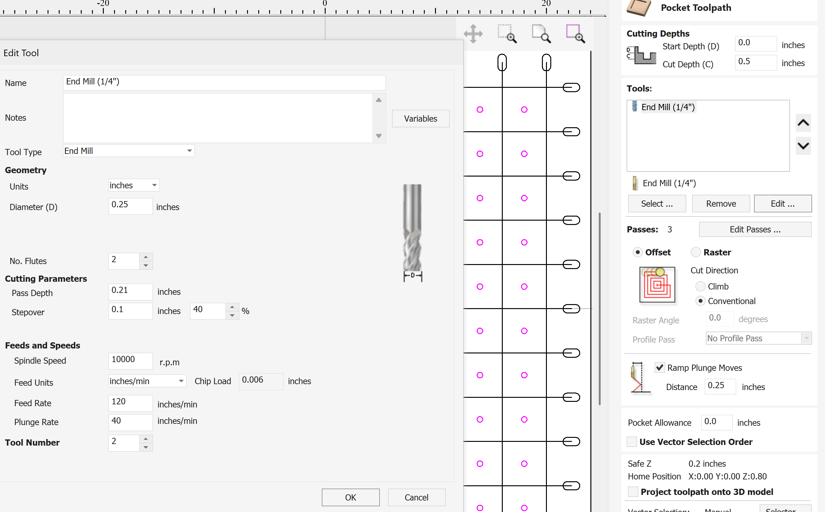

Hi all, progress has been made. The tracing, surfacing toolpaths have been run. Next is #3 Locating Pin Holes. The bit I have I have a message on the Masso I don’t understand. I then realized the bit for this toolpath appears rather generic. Google hasn’t found a website for the manufacturer or a tool database to import into V-Carve. Two questions:
  • What is the message on the Masso mean? “1/16”? note the 2nd image shows tool #2 is 1/4" as expected.
  • Is the generic V-Carve tool database setting appropriate for this tool?
Is it OK to run this toolpath? If not, what do I need to change. Thanks all!

I would check what tool you have entered in your masso tool Database. Obviously your vectric tool database shows tool #2 is a 1/4" endmill. Do you have a 1/16" endmill listed as tool #2 in the Masso tooldatbase?
Correct. Was unaware of the MASSO G3 tool library. There are a few entries. I removed them. Too bad it doesn’t read the needed tool from the gcode. Moving forward. Thanks.

Try this Youtube Video from Mitchels Woodworking. He has great information about the Masso and Onefinity. It’s important that the Masso tool database and the Vectric tool database match. https://www.youtube.com/watch?v=cvVy2r7kcvs&t=545s
