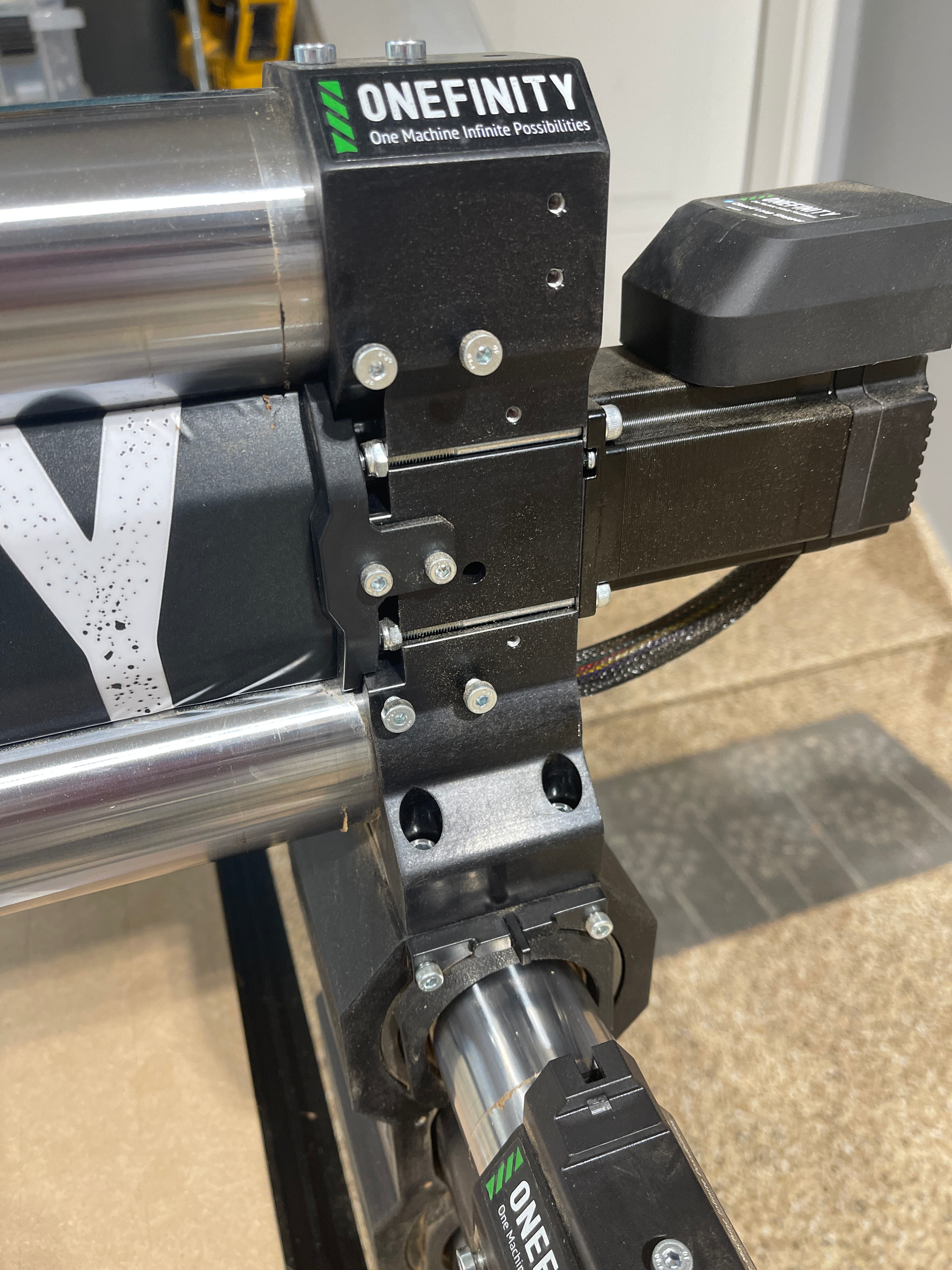

Does the gen 2 not have the z front to back tramming screws on the x axis rails?
I think there are a few improvements that could/should be made on the @OnefinityCNC side based on my Gen 1 Elite:
  1. Improve the documentation on how to tram the machine in, there is no mention of how to do this in the manuals. There should be a specific section that shows where the tramming adjustments are.
  2. Add jack screws to adjust the z tram in the left/right plane (inline with the x axis)
Gen 2 has quite a lot of screws
I have not seen anywhere directions of how to use those screws for tramming. I would definitely use the screws instead of putting aluminum foil, if I knew how. Now it is late for me but the others will benefit from an instructional video.
Really the AltMill simply connects
Looks like they doubled up the screws and moved to set screws on the back, I might put up a video in the next few days discussing it
