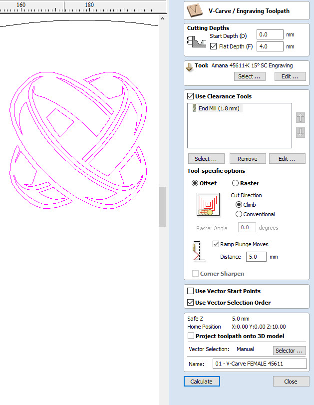

I would suggest not going so deep with the carve. I found 4mm to be the max before the side of the V-Bit starts knocking down the tips of the lines. From the images below, you can see this is a charcuterie board made from oak with a walnut inlay (I don’t like the way it turned out BTW). Vectric is showing the minimum distance of a couple of the lines to be just over 1mm. I am also including screenshots of my toolpaths.
Lastly, the type of wood made a difference for me. The harder and more dense woods stood up the best for the male carving, and if I didn’t mention it before, for the male carving, I always cut the V-Carve path FIRST, then the clearing. This gives extra support to the thin lines.
EDIT: For testing, I think I ran either 3 or 4 tests to get the depth and speeds to work and to find the Amana 45611 bit which had a notable contribution to the success. I too have access to Illustrator/Photoshop, but did all of these vectors inside V-Carve Pro. I did have to get into node editing to make the text not overlap, but did not really touch the graphic for the rings which I just found online somewhere.

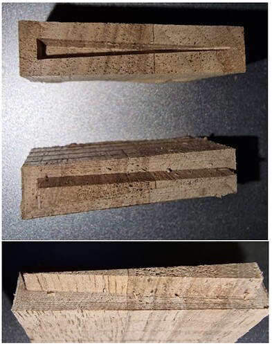

The male (Plug) is not correctly done, extra material is not removed, I guess it’s too flexible. Starting with Carve could be a very good solution. I’ll test it soon, thx

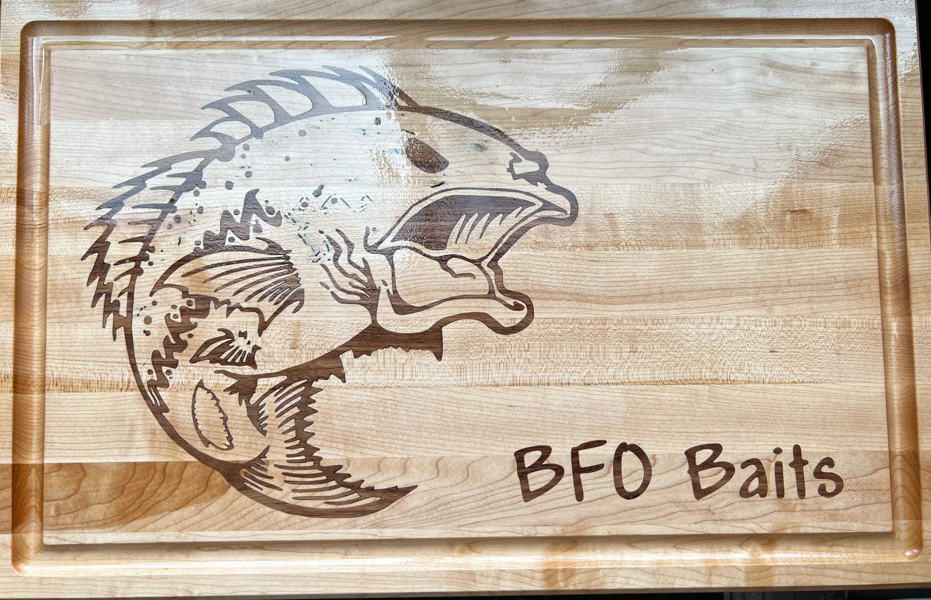

@Matticustard sorry it has been awhile for sharing the results. But here they are. Overall I am happy with it. There are a few things that I wish I would have known prior. One, what @Stefano had mentioned is the very narrow portions. Either adjust them to work or remove them all together if it can be afforded.
If you recall our initial conversation as you gave me guidance. One thing that was concerning was how I had the male inlay tool paths set with the 3 different SD and flat depth. With the method that I did, it seemed to be very rough on the bits. Ended up snapping a 1/16 DC. Luckily it was towards the end of its carve. So I was able to get away with it. But the Amanda tool (46280-K) seemed to struggle as it was cutting on just the tip (no pun intended) the entire time and I’m pretty sure I ruined the bit. Not sure if there is a way sound it or not. In any case. I really appreciate your help and input!

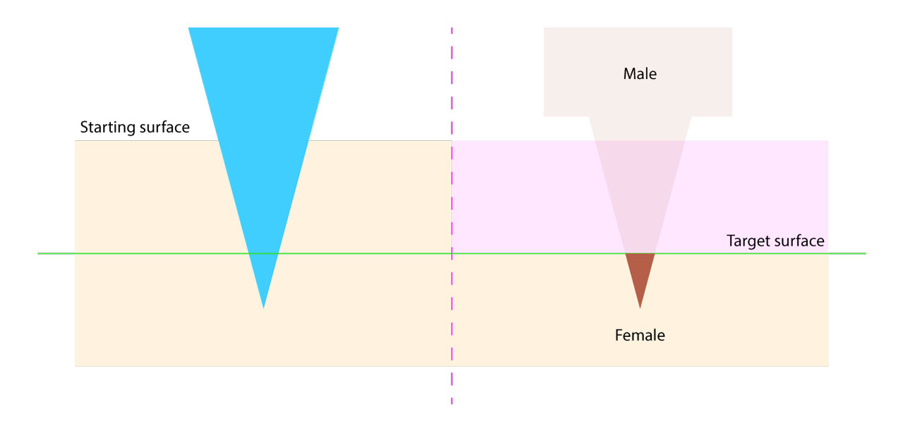

I am surprised, however, to see multiple people in this thread using tapered ball-nose tools instead of V-bits for inlays. I don’t see how you are able to get a perfectly matched set [male/female] with a ball-nose tool — sharp outer corners don’t fit into round inner corners. Perhaps this isn’t such a big deal at the scale we’re talking about and since wood is relatively soft, but it’s new to me.
Very fine details can be accomplished with a V-bit. Not saying it’s always easy, but it can be done. I like to leave extra material on the work surface and “over-carve” it, then plane everything down to the final thickness after the glue-up. This gives you more substance to work with so the material is less fragile. But this method may not be possible if the fine details are too tightly packed, and design choice and preparation goes a long way.
A visual example of over-carving the female portion. Not to scale:
But I’m sure as with anything, there are a million ways to skin this cat. Doing more projects and figuring out what works best for you is probably the best medicine.

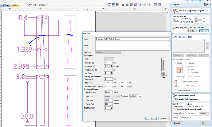

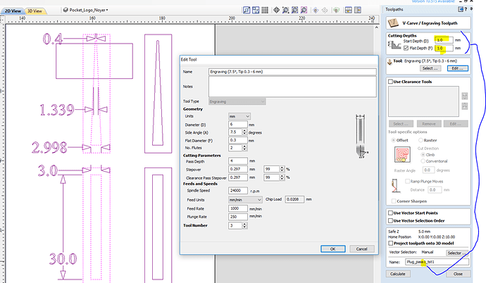

I did a test to view if thin lines are better when starting with the carve toolpath and for this example no clerance bit, and no way, it’s not better at all, here is my process :
Material : walnut end grain
Bit : Engraving bit, 2 flutes, 15 degres, tip 0.3mm, got it from amazon : https://www.amazon.fr/gp/product/B08R6S8QSX/ref=ppx_yo_dt_b_asin_title_o00_s00?ie=UTF8&psc=1
With this bit according geometric calculation, the surface width when it plunge at 4mm depth should be 1.35 mm
Pocket settings
  • Blue mark is where the pocket depth leaves 4mm and start to ascend (I’ll come back to it later)
Plug settings : I did it in 3 passes (no clearance)
Pass 1 SD 1mm / FD 1mm
Pass 2 SD 1.5mm / FD 1.5mm
Pass 3 SD 2mm / FD 2mm
Then a profil toolpath to detach the 4 parts from materials.

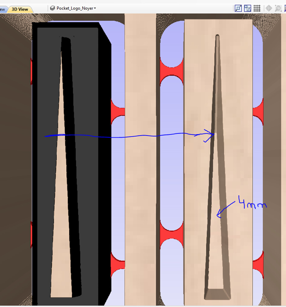

3D view shows where depth is 4mm and where above. Using X, Y position from 3D and located it in on the 2D, I found the blue mark on my first img and horizontal dim there is = 1.339 mm which correspond to calculation value.
Here, I expected to also view on the plug that the material is below the surface, and it’s not … the gap between the pocket and plug is 2mm so i twill help but very close to the tip, no way I won’t goes in.
The physical result for the PLUG is close the 3D and doesn’t fit correctly into the POCKET.
Do you have any guidance to help me understand where I’m mistaken ??
Nothing stands out as particularly wrong with your methods.
How confident are you in your Z-probe accuracy? You’re dealing with very small dimensions. A small discrepancy could have noticeable effects.
I would try pushing your plug carve to SD 3mm / FD 2mm, or even SD 3.5mm / FD 2mm. Sometimes, you have to finesse it a bit.

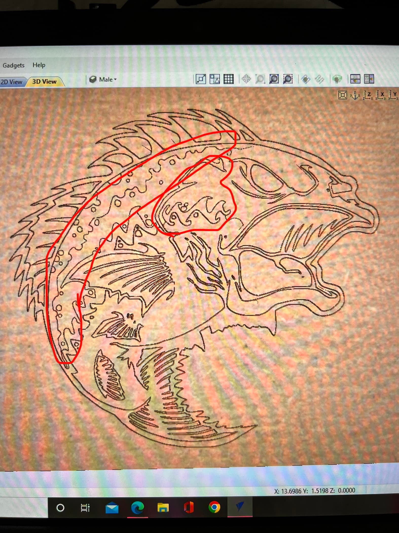

@Stefano not particularly. Those parts didn’t turn out to bad. They did seem quite shallow in the female but I think there was just enough meat to get a good glue up. The problem areas I ran into where on the spine of the fish. On the 3D render it showed to seem what would have been enough material cut away but there was hardly any.
Maybe because there is a wider portion that tapers to the point? My suggestion. And this could be way off. But maybe open up those vectors slightly ensuring your bit gets some good depth on the cut.
I do think the pocket is rambling like that is due to the size of your bit. With that DOC and the size of the bit it is unable to maintain the doc at that narrow potion without running into that sections wall. If that makes sense?

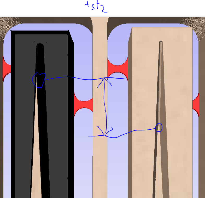

I’m playing with Aspire to dig that further, the 15deg tip 0.12mm ordered will arrive next wednesday, here is what I found, any suggestion is most welcome :slight_smile:
Viewing on the 3D view the position of these 2 points :
Pocket where FD leaves 4mm
Plug where Z leaves 0mm
If 3D view rendering and mesures are not too bad, this is highlighing the distance between 2 points are the lowest
  • With SD 3.9 instead of 2.0 – the gap is then only 0.1 —warning
  • With a bit 15 degre and tip of 0.12 instead of 0.3
To be confirmed with real results … I’ll feedback when tests are done.
