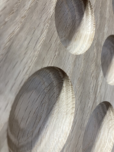

Very successful this time with oak
Did not XYZ when tool bit change only Z
Slowed roughing from 120 in/min to 80 in/min
as you can see perfect
I know I dropped a lot in speed but the bit seemed quite happy with the speed nice and smooth so I can wait a few extra min
I have watched hundreds of videos but it is amazing the little things a guy can pick up here
Thanks for your help guys, makes my day a little brighter

Simply beautiful!
And the carve ain’t bad, either. :sunglasses:
It is good the hear it did work out and, I can testify there is much this forum offers in the way of help and ideas for me too.
