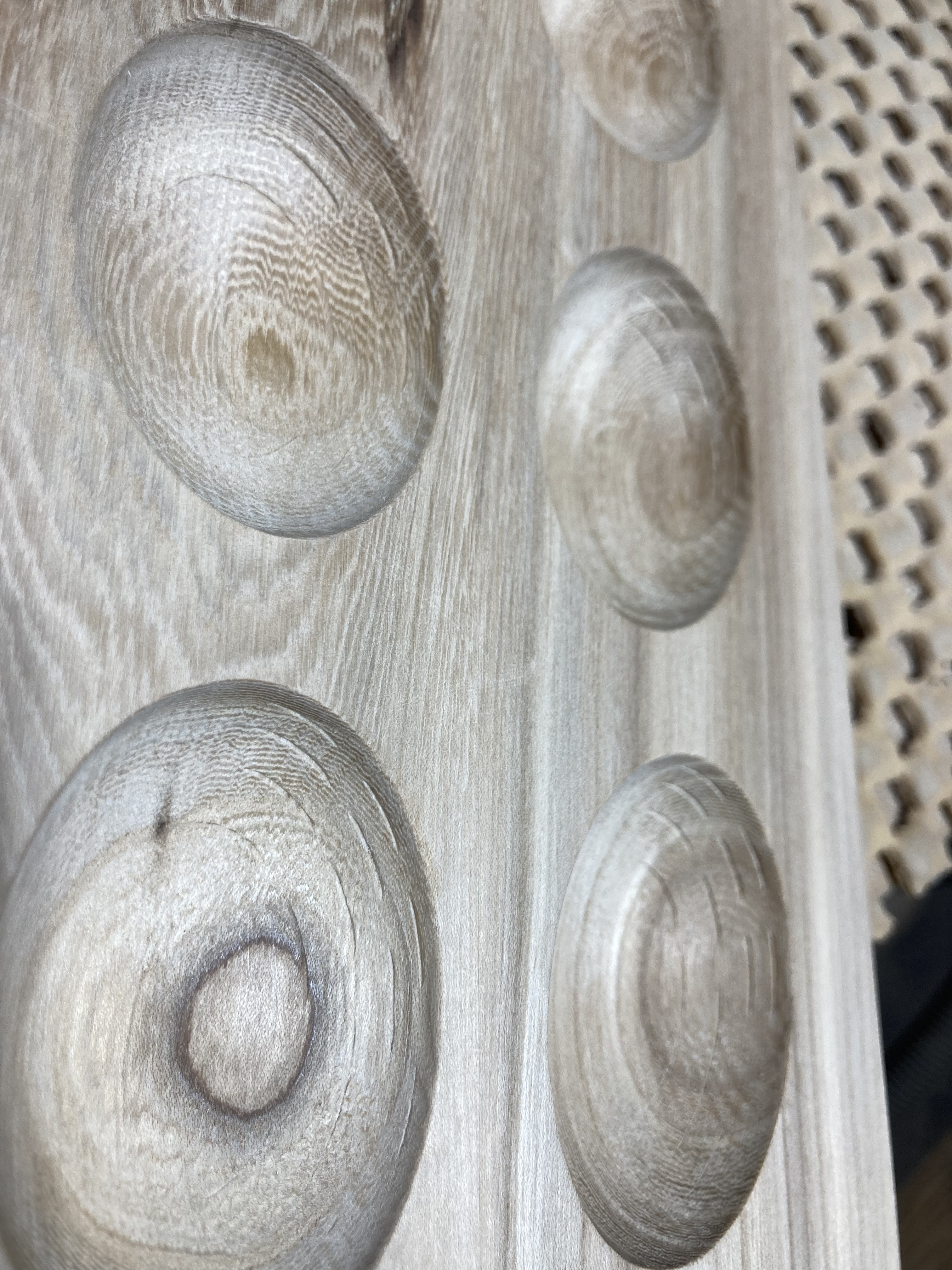

I have done this finish relief many times with no problem this time there consistent marks on the side of the relief as shown in the picture. The marks are deep enough that they will not sand out without great difficulty
I used a 1/4" Jenny ball nose with
step over .02
step down .100
feed 100
plunge 40
X35 and carveco maker
the material was rock elm wood
wondering if it was the wood? I figured I was going slow enough for the wood
any thoughts
I’m not familiar with Carveco and have never used Rock Elm, but can you tell if the gouges are consistent with the carve direction? You would probably agree they appear to not follow the wood grain.
they don’t follow the grain and each one is consistent with the other. Each relief has the exact same markings. I will be using a different wood shortly, hopefully they won’t reappear
Zooming way in on the marks, they don’t appear to have been made with a ball-nose bit. Did you use a square-edged bit for roughing, perchance?
The marks are in the same sector on all of the pockets, which makes me think that something may have shifted laterally between roughing and finishing passes. Perhaps a workpiece shift, or maybe a few missed steps.

The axis motors on the Original/Pro (Buildbotics) controls are open-loop stepper motors. If they encounter a cutting load that exceeds their maximum output torque, they will stall. Then, assuming that the stall is temporary / transient, the motors will resume moving, but with a position-offset error that is an integer multiple of the motor step size. Hence the term “missed steps”.
The motors have no position sensors, and thus the controller has no way to detect that missed-step error. But any features subsequently carved into your workpiece will be offset by the cumulative step error.
The rock elm, being hard, will likely require more cutting force than softer woods, which may make missed steps more likely. Ditto for a dull bit.

the marks were carved with the first rough cut with a standard 1/4 end mill
As I watched the second pass it revealed the marks, but didn’t cause them, I was wrong they were created in the first rough pass which coincides what you are saying which makes sense now.
I checked some oak that I had previously done and there were marks but almost un-noticeable
I am assuming that my feed rate should be slowed down considerably I was roughing at 125 in/min and plunge at 60 I am thinking for the harder wood 100/40?? or slower??

If steps were getting missed on the roughing pass, you should still have the same position offset on the finishing pass (assuming that you’re not re-homing or re-zeroing X & Y between the passes). So the finished pocket might be slightly mispositioned, but would probably still clean up ok.
The cutting edge of a ball-nose bit has zero radius at the very tip. So when milling the bottom of a pocket, you’re essentially just dragging the tip across the wood to shear it. I would expect that to require some pretty high axial forces for hard wood. So slowing down the finishing pass, and/or reducing the stepover distance, would be good experiments to try.

Good question. It appears to me that a position offset appeared sometime after the machine finished roughing the sides of the pockets, but before it completed the finishing toolpaths. And then the offset never changed afterward. Ergo, the offset between the final roughing pass and the final finishing pass is the same for all pockets, and so leaves exactly the same amount of rough-cut grooving exposed on every pocket.
Without knowing the details of your toolpaths, I can’t even speculate as to exactly when the offset may have occurred.
I’ve been assuming that you are not re-homing or re-zeroing the X & Y axes between the roughing and finishing toolpaths, when you change bits. Is that in fact the case?
every time I change a tool bit I re zero X Y & Z because I was told that not all bits are created equal. right or wrong?
Z does need to be re-zeroed after bit changes, as the bit stickout is unlikely to be repeatable.
X&Y do not need to be re-zeroed. The software always references the central axis of the spindle, and thus of the bits. Collets are very repeatable radially, which is why there is no need to re-zero X&Y after bit changes. If you do, you run the risk of introducing offset errors within a carve.
