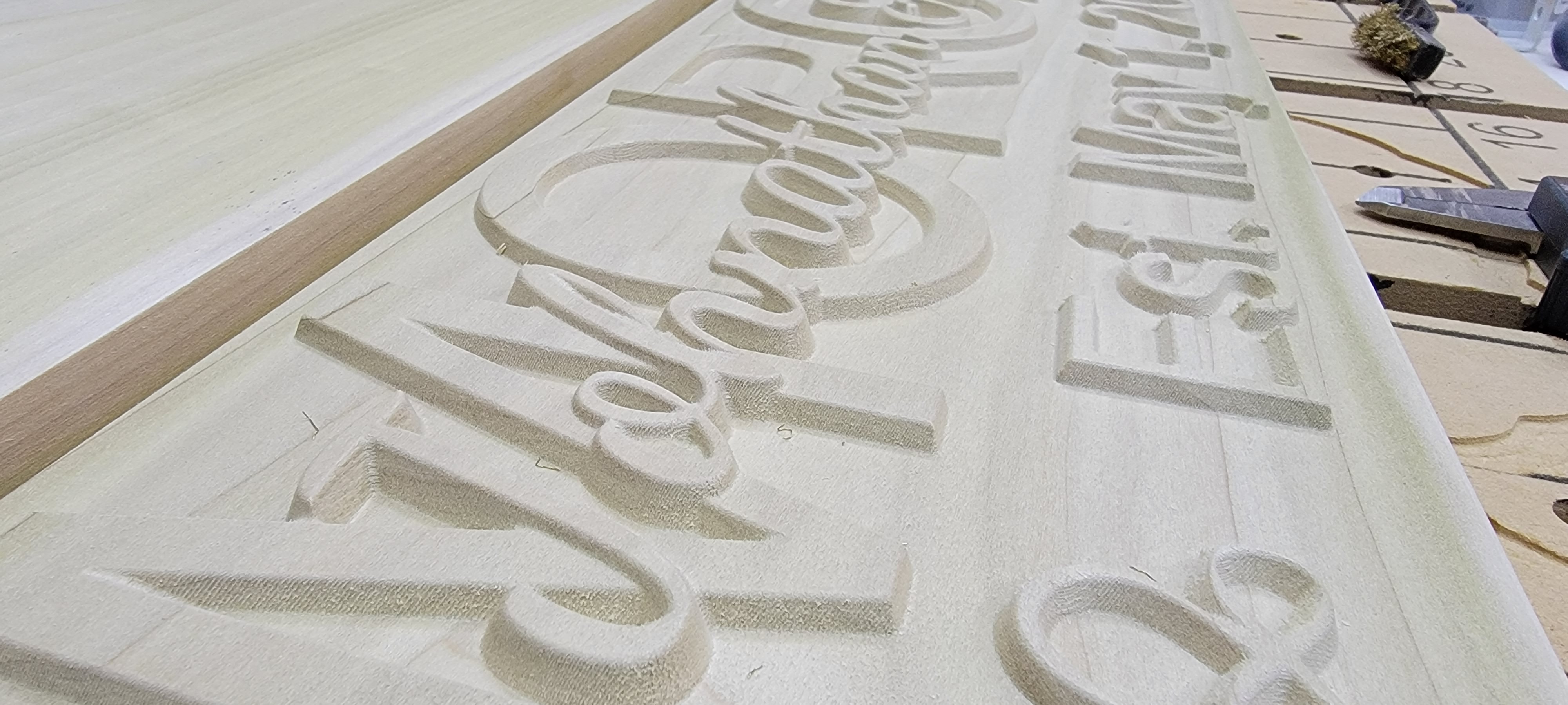

Another Wedding sign:
Text 3d modeled in Aspire
1/16th tapered ball nose finish pass only (no roughing pass)
300imp & 150 Plunge.
Poplar wood from Lowes & still finishing it up with Odie’s Oil
~ 9"X20"

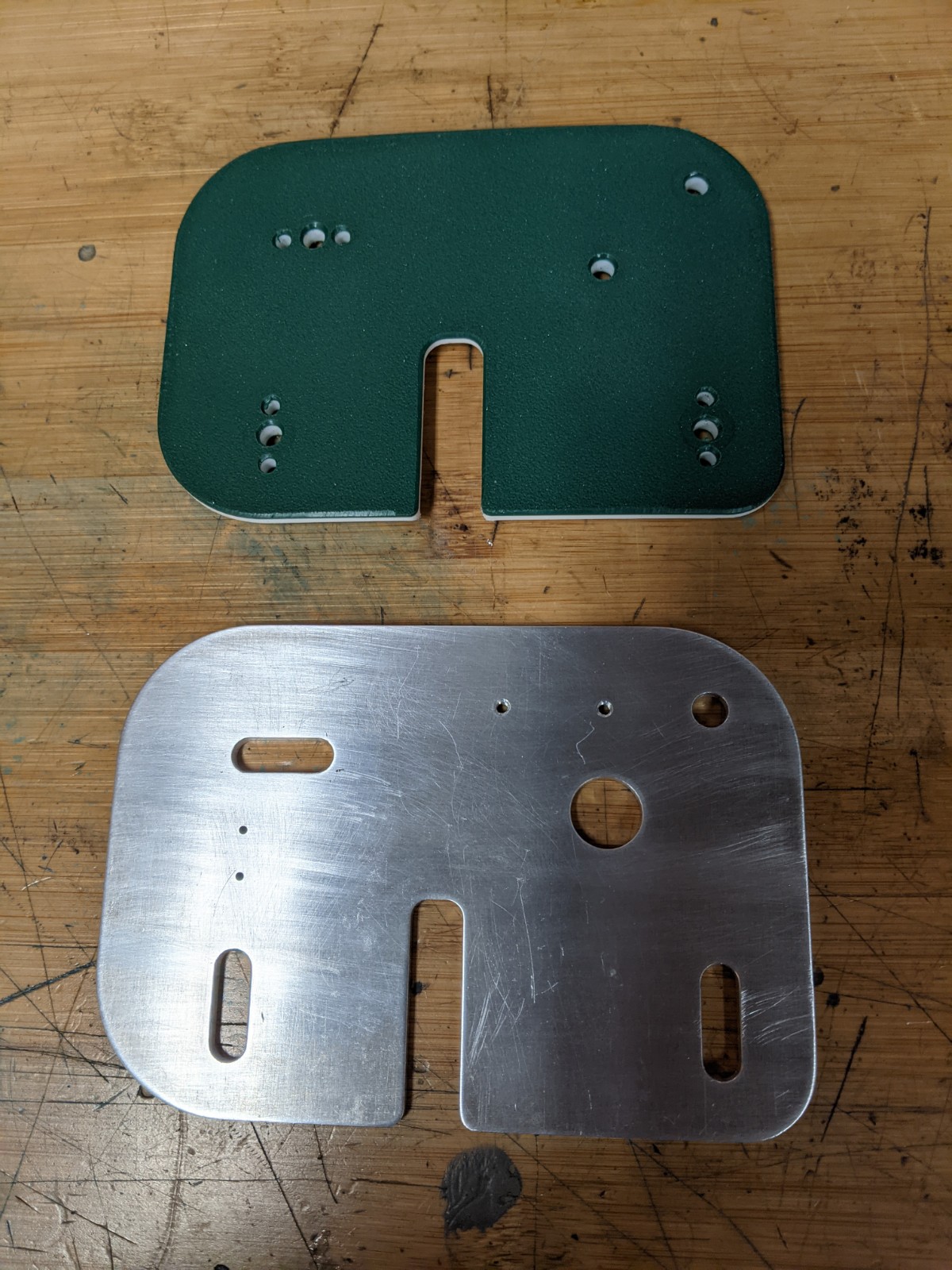

I just did this as a test part for Xometry. Still waiting on their CMM report, but the FOS (features of size) I could measure with calipers were all within .002". Their requirement is +/- .005"

What spindle are you running @Machinist ?Those tolerances seem really good!
@AndrewBrown I’m just running the standard Makita. I also ran finish cuts after the initial cuts.
Awesome stuff. Good to see the Makita can hold reasonably tight tolerances. I’d be interested to see what the QC results are.
@Machinist How did you hold the hole tolerance of .062 +.0005? Different machine? EDM?
@Techrise Yes, different machine. On the initial setup, I plunged the hole locations with a 1.0mm end mill. Once the part was complete on the router, I took it to the mill (I have a small X2 type mill) and drilled them with a 1.5mm drill (0.060") and the reamed with a 0.0620" reamer. With the small drills, reamer & tap I had to buy, I have about $45 in tooling costs, not to mention some fixturing I had to make. Hope it was worth it! If the part checks out, they will add me to a qualified supplier list & pay me $100 for the test part.
Other than the location measurements which I couldn’t do, those holes are the only feature of size I couldn’t measure. Just blindly trusting in the reamer on those.
LOL! I know the feeling. Hope the inspection goes well. Gage pins are not very helpful at those tolerances.
Thanks @Techrise, I’ll report back when I get their verdict.
Here’s some pics of how I processed it. The material they provided was just large enough to get 2 pieces out of, but just had to send them one.
On the initial setup, the material was carpet-taped to the wood with 1 screw in the center of the material. Once the holes & slots were done, I placed the plastic fixture pieces on top & secured with 5 screws each, then proceeded to cut the profiles. Using cutting oil, I didn’t have enough trust in the tape alone to hold them in place for the profile cuts.
UPDATE: Xometry didn’t send the CMM report as I was led to believe, but I just got an email from them that the part passed inspection. Yay!
