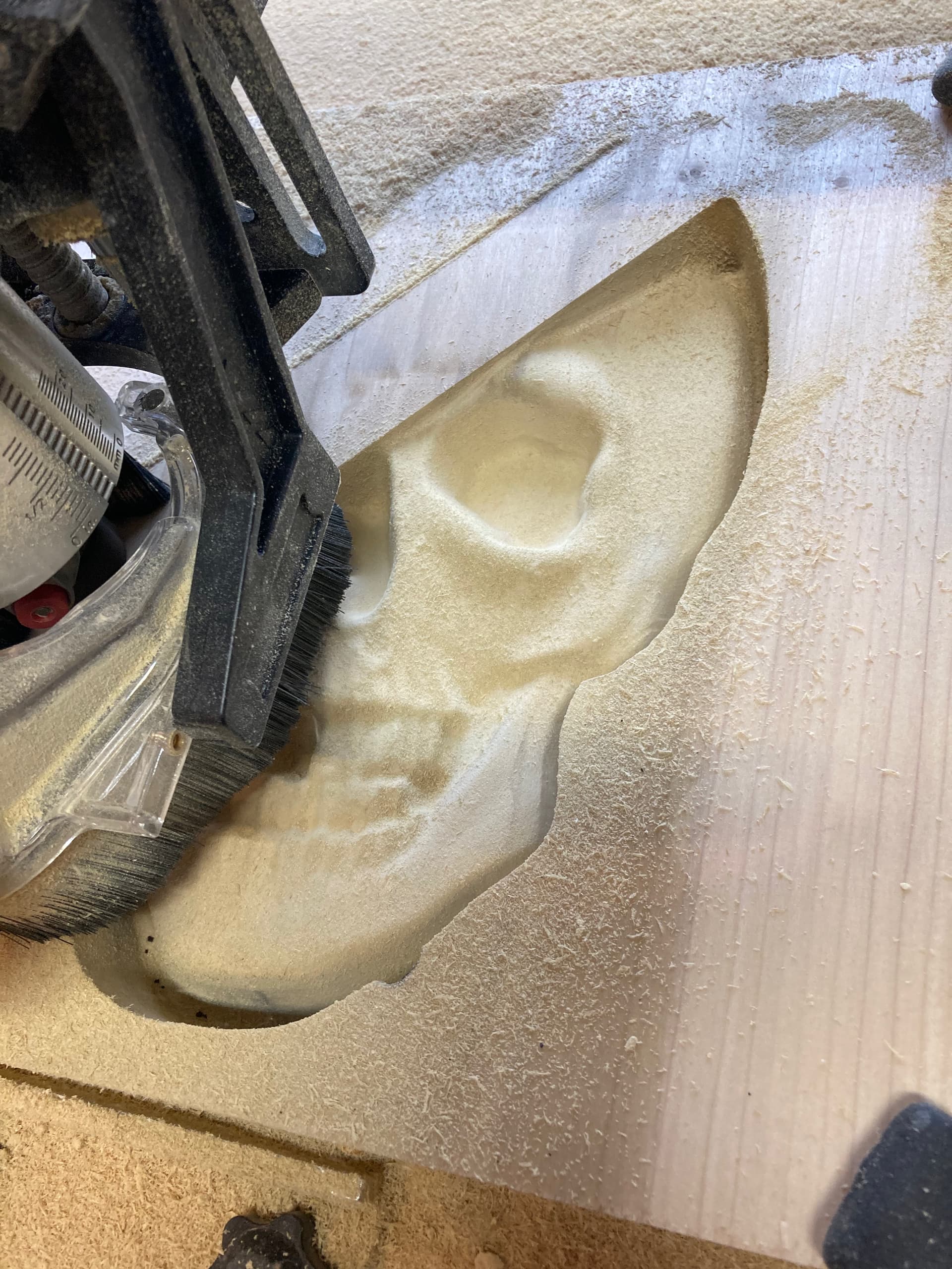

My first 3D project. Made a skull for my grand daughter out of ash wood.

Nice carve Dennis. Looks like it’s maybe poplar wood to me and could you tell me which ball nose bits you are using to get that smooth finish?
Thanks for the smooth finish complement.
The tag said it was Ash, but I agree it looks like poplar.
I used a 1/4 Amana Downcut which I am really impressed with and was cutting at 150 ips. However,I found the trick is to cut 3D finish pass only and cut at a 45 degree raster. Additionally, I add a 15 degree taper to my 3D images before programming the tool path.
Seems to give me smooth finish.
Could cut even faster on these soft woods, but I do a lot of hickory and slow it to 100 ips.
