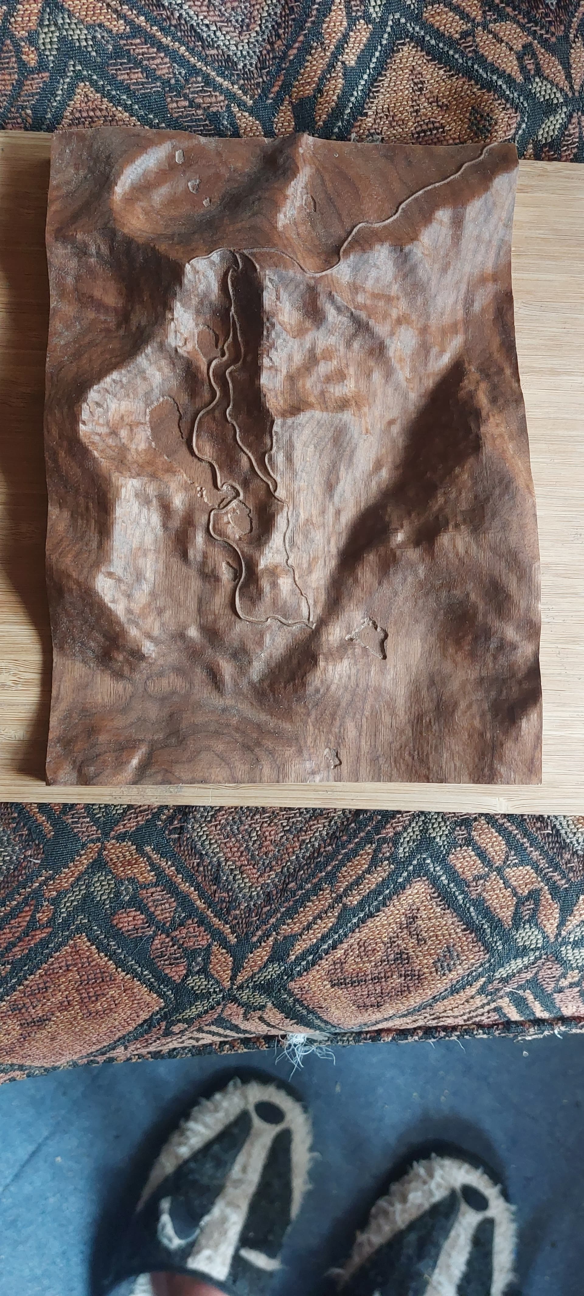

3D scan and inlay.
A topographic 3D relief of Snowdon (A mountain in Wales).
Software Used:
  • Modelling: Blender3D and GIS Addon: BlenderGIS Addon - Blender
  • Toolpaths: VCarve
    Machining: Amana 1/32 Tapered Ball Nose. 170 IPM, 24k (probably way too much), 10% stepover
    Material: American Walnut
    Dimensions: 230mm x 165mm x 30 mm
Even Better If:
  • I wanted to show the paths to get up Snowdon. To do this I modelled the paths as 0.5mm diameter tubes. Whilst they technically worked, they look too much like a worm casts
What Worked Well:
  • The detail on the profile worked well with grain of the walnut (fluke)
  • Lakes and various puddles were modelled by outlining the regions and flattening the surface and then pulling the surface down 1mm

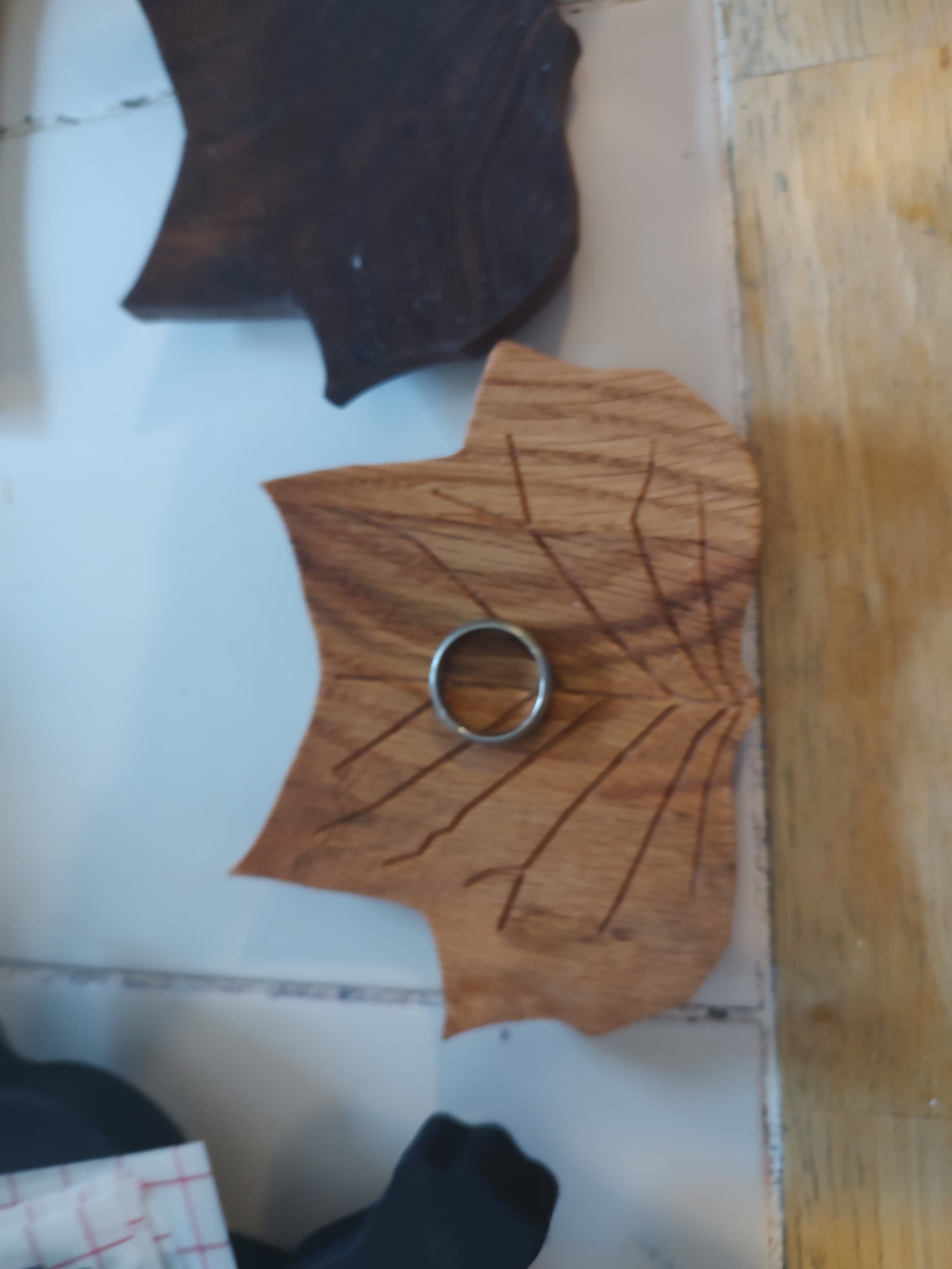

First 2-sided, 3D work totally of my design. It’s a tulip poplar leaf ring dish. It’s 1/4 thick, slightly convex; the corners are 3/4 high at their peaks. Veins are v-carved into the surface following the concave surface. Have some tooling updates to make to improve precision if I plan to make a bunch of them, but not a bad first go.

Love the slippers…oh and the topo map looks great too!

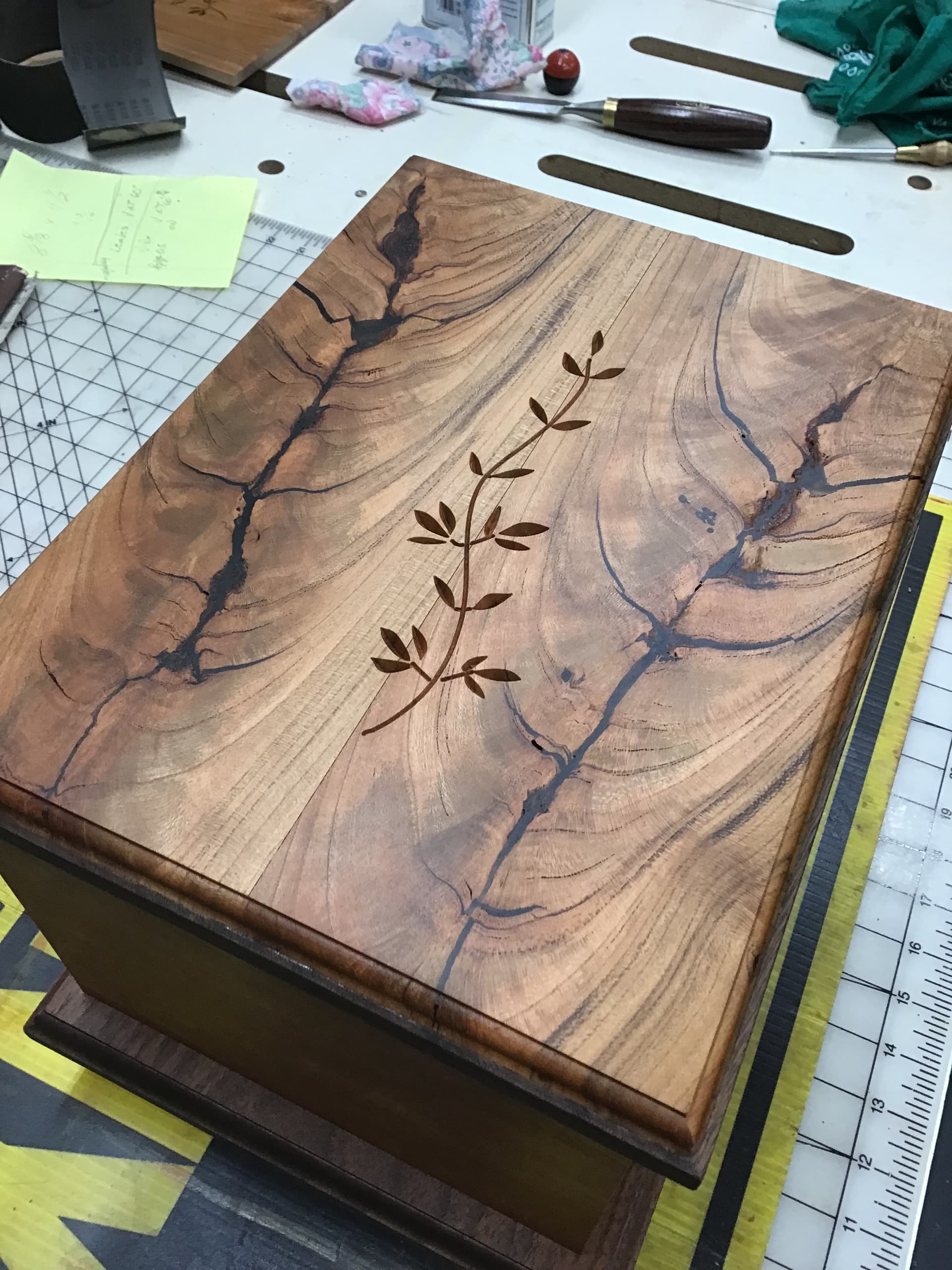

Cremation Box

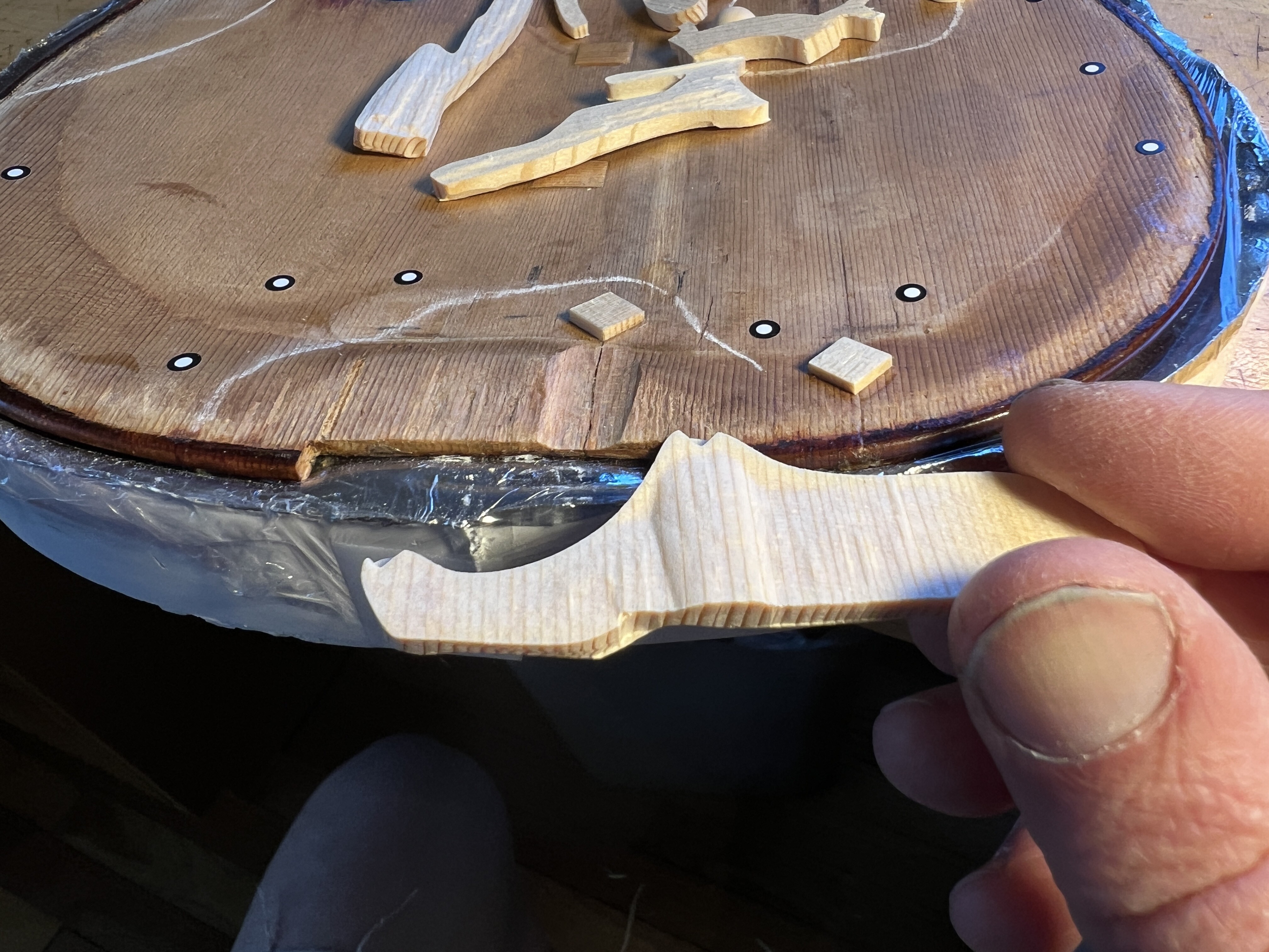

Obviously, not all cnc…but handles, yoke, etc.

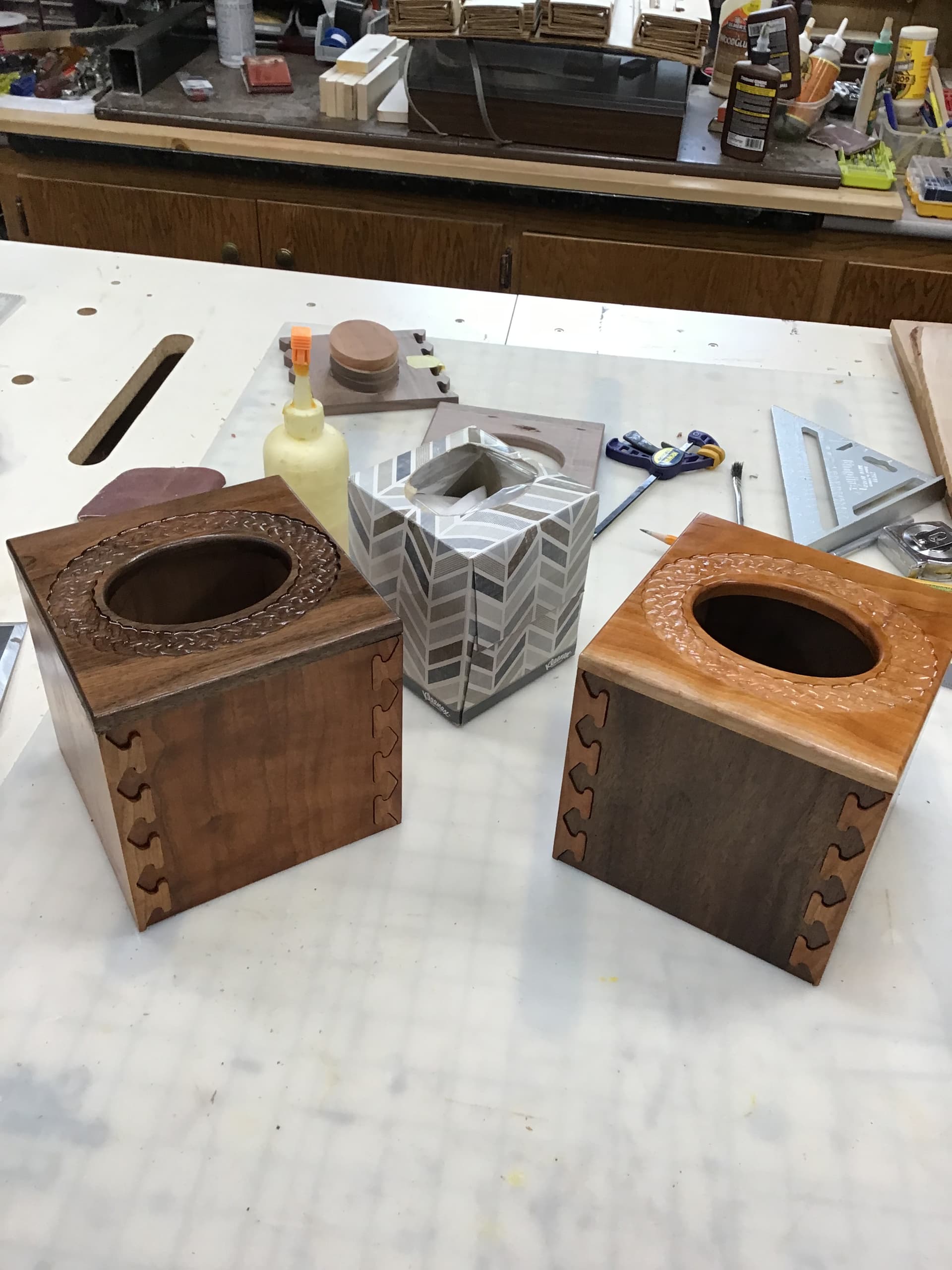

Kleenex Box

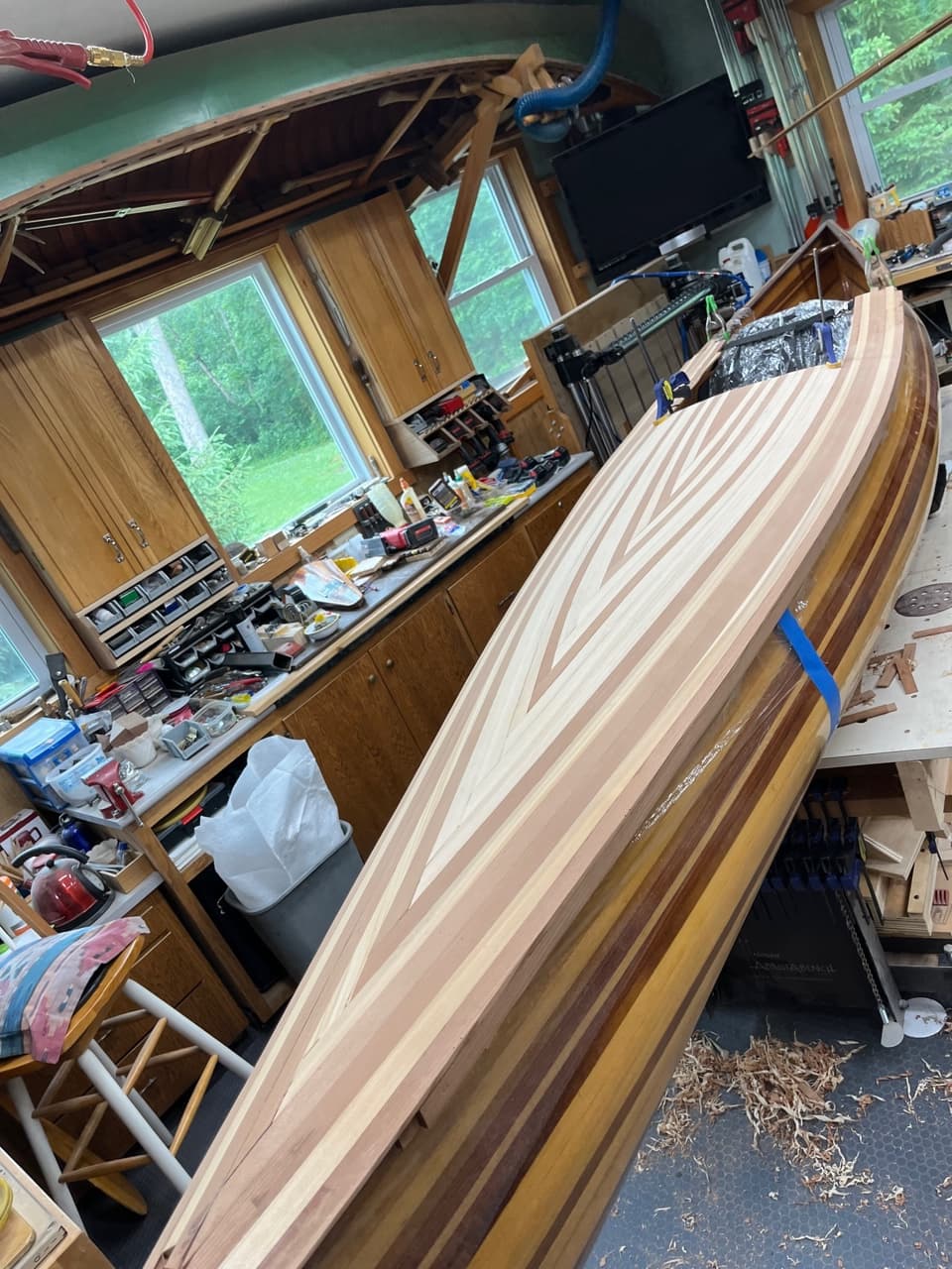

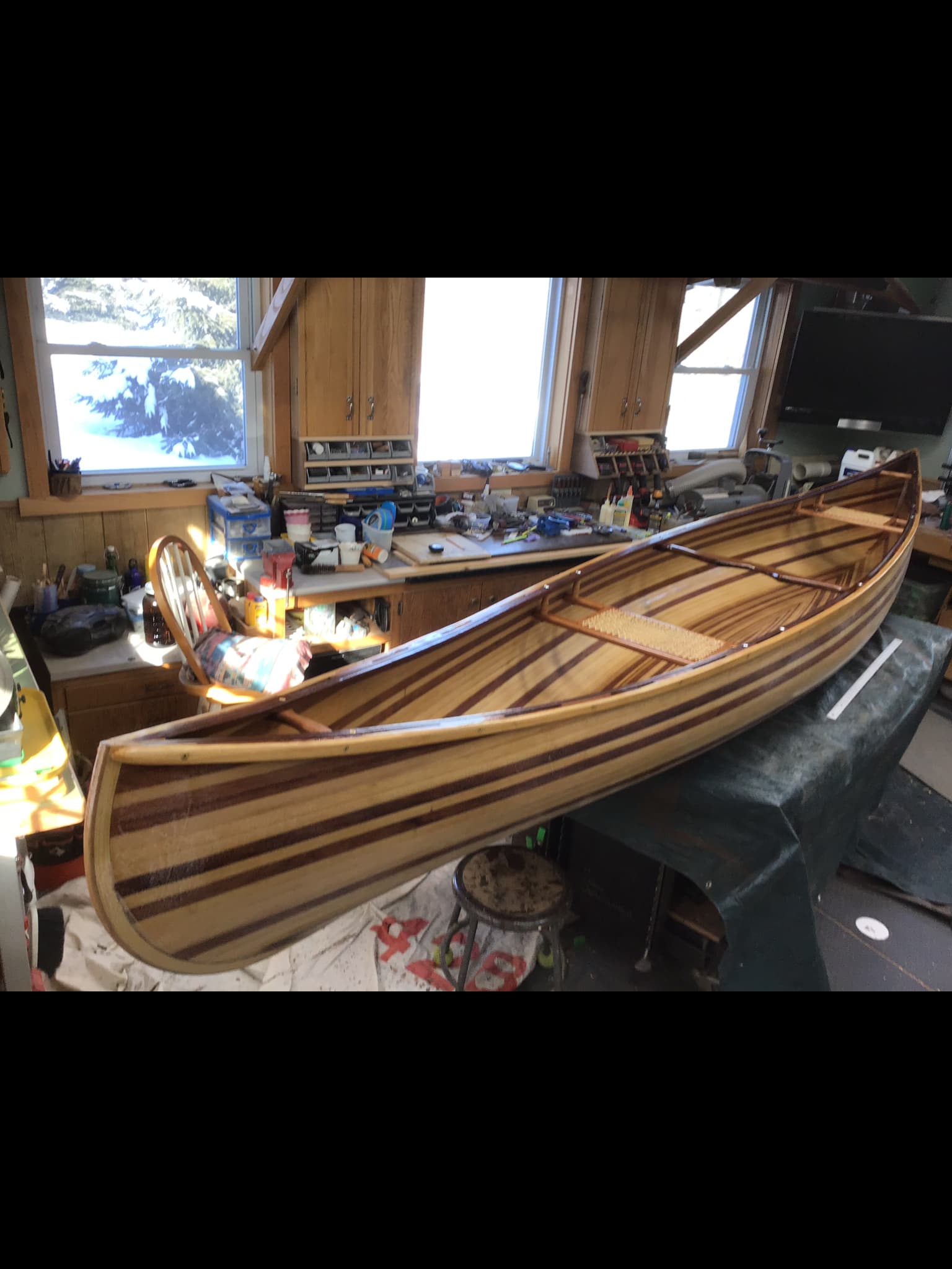

Hey William,
I envy you :slight_smile: Did you make it?
Yes, starts out as rough sawn cedar. Using the CNC for accessories. Good example as to why I need a fold down CNC for space. The other canoe is a Canadian Peterborough design. This is a solo canoe, of my own design. Adding a front cover that hinges open.

I love that joinery! I really need to figure out some vertical clamping method on my table
