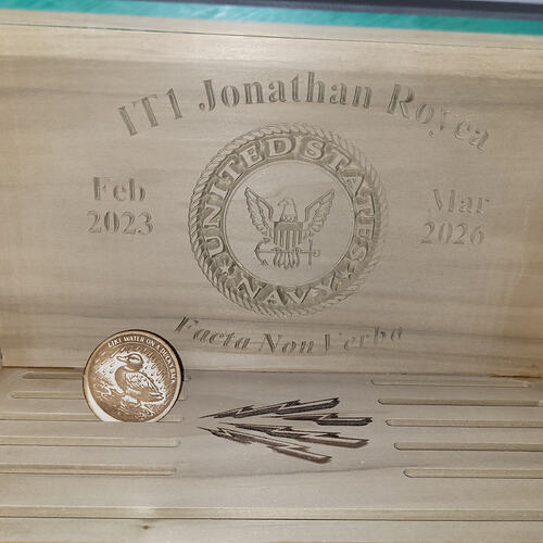

Challenge coin box. Material used was poplar. Utilized the dovetail gadget for the first time, still have some fine adjustments to get perfect.
That’s a great way to present the challenge coins.
I like the joinery and really dig the engraving on the front panel (I’m assuming acrylic done on the 1F? Though I could see it done w/glass depending on what equipment you have access too).
Cheers.
@L.M yes the front panel is acrylic. I just used a 90 degree vbit and cut the mirror image so you get a smooth surface on the outside.
The dovetails gadget is really cool, but I am super happy I did it on a test piece. What I did was cut the pin, dovetails and profile first. I orientated my pieces, built a jig (just a 90 degree stop corner, this saved me time from probing each piece) and then cut my pockets for the other pieces. Backwards from what I am use too.
The reason was due to the piece with the pins was backwards. A hiccup, but I over came.
Thanks for the love on this project. I always try to get the ‘wow’ factor out of people and I couldn’t do it without 1F!
