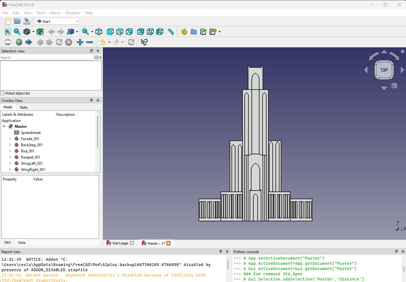

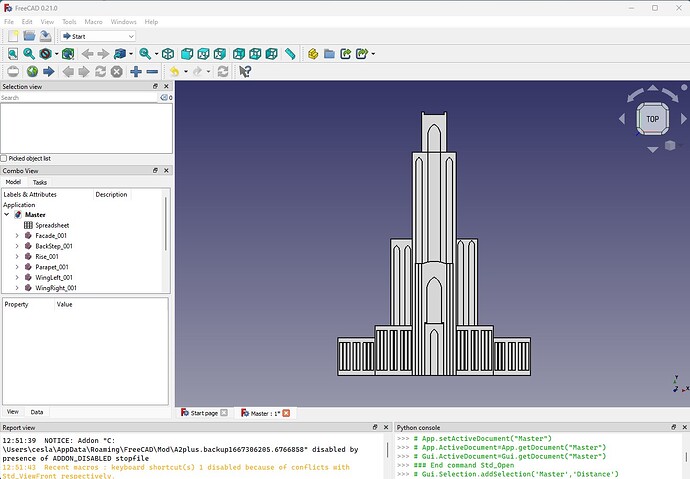

The workbenches I use primarily are:
  • Spreadsheet ( usually start here as all my models are driven by desired length)
  • Part Design (Part Design & Sketch go hand in hand)
  • Sketch
  • A2Plus ( for assemblies)
  • Path ( to generate GCode)

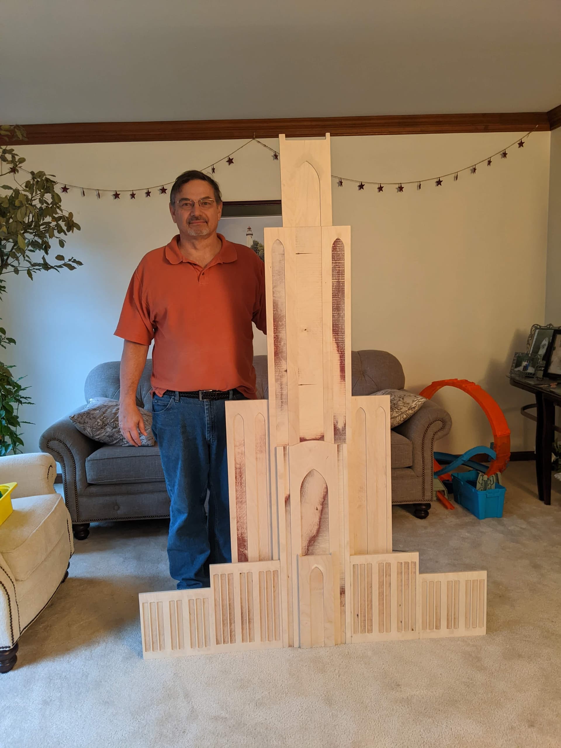

The last project was a 6’ tall model of “The Cathedral of Learning” in Pittsburgh. I am a PITT alum (H2P!) The model:
  • was scaled from a picture
  • had 5 depths of layered plywood
  • had 10 parts (had to ship to Pittsburg from Cincinnati)
  • was cut on a Journeyman.
  • hung on a wall (french cleat) OR was self-standing
  • the customer wanted to paint it herself
  • Got to pay myself $3 hr for labor … did I mention I need to improve my business savvy?
