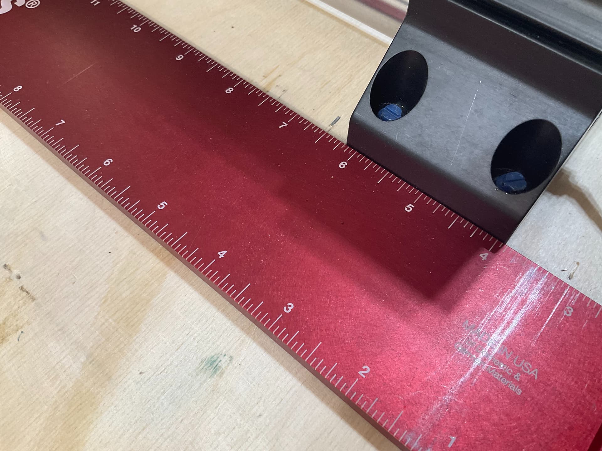

You write your machine is perfectly square. May I ask, how do you measure the squareness of your machine?
Actually, referencing the end of the table IS of help to me, since I’m starting off with a perfectly square piece of MDF, that puts the MDF perfectly square with the end of the table, and to answer your second question, the machine was squared up in the beginning to the table with that 26" Woodpecker’s 2616 square you see in the storage tray at the bottom of the table - accurate to .001", so yes, the table is square, the machine is square, and the machine is square to the to the table as well. All are reference surfaces.
And as to the question of the permanent fastening method, this IS the permanent fastening method. The T-Tracks are permanently mounted, and the clamps keep the waste board in place just fine, which makes for an easy replacement when it’s time to, and I don’t have to keep hogging out previous mounting holes every time I replace the waste board using this method.
The machine was squared up in the beginning to the table with that 26" Woodpecker’s 2616 square you see in the storage tray at the bottom of the table - accurate to .001", so yes, the table is square, the machine is square, and the machine is square to the to the table as well. All are reference surfaces.

The reason I asked is because your end of your table has multiple saw blade marks. There’s no way it’s square. I can see those from here. There’s no advantage to asking questions and getting defensive when someone offers suggestions or questions your methods (right or wrong).

As far as the saw marks go, you’re looking at the wrong reference. There is a 30" t-track screwed to the front of the table, and the saw marks are incidental and small and have no bearing on the overall squaring up that I’m doing.

Perhaps these pictures will help.
The X-Beam foot is exactly 7/8" further in than the front foot of the Y rails. What you are looking at is a very precise square referenced on the front from the aforementioned T-Track, then at the rear, you see two Veritas setup blocks put together to make a 7/8" spacer. Hopefully you can see that the machine is square and it is also square to the table.
