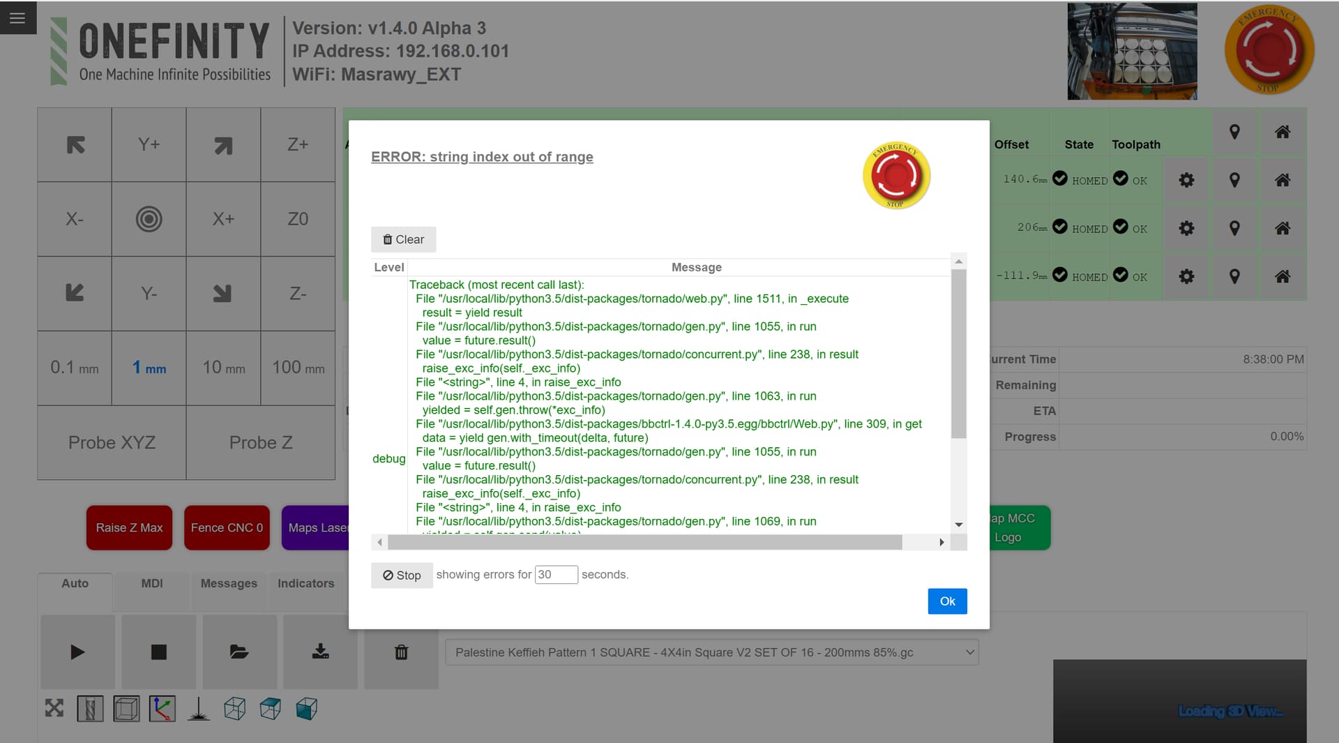

V1.4.0a3 Macros have issues.
After creating a macro where G-Code is entered, can’t delete macro if it’s no longer needed. The stored code should be deleted and the macro button should return to it’s default (unassigned) state and color.
The image below tells all
When deleting loaded GCode files, Macro Gcode is appearing in the Gcode area.
Can we get that area to be clear after we delete all loaded GCode files?
