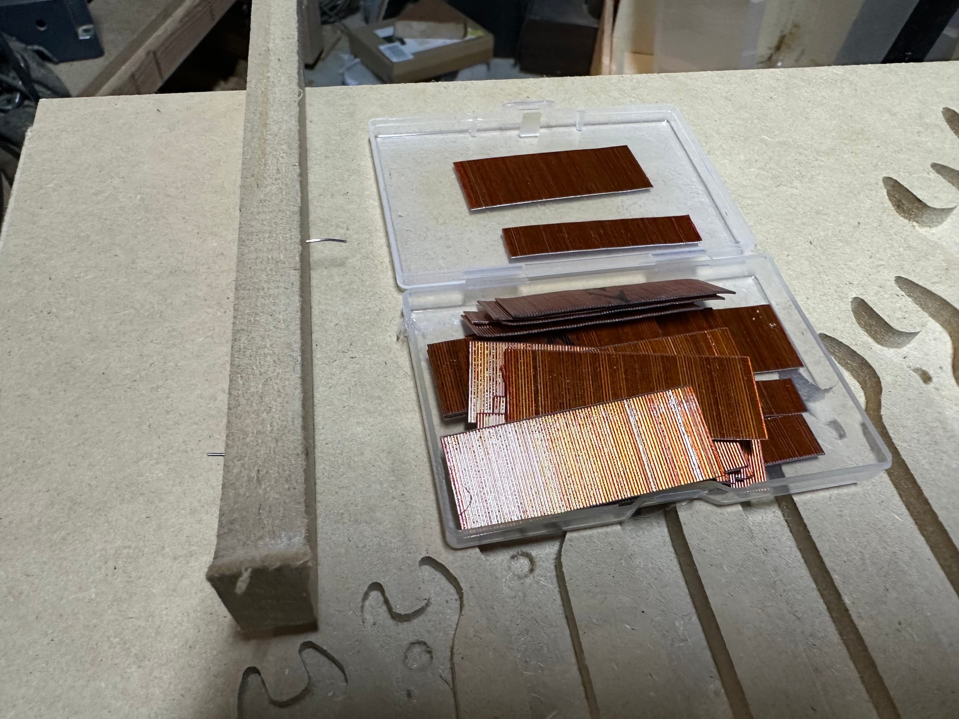

He has since given me a 23 gauge “pin nailer” (I guess brad nails are standard 18 gauge). I was surprised to see on Amazon that they sell 23 gauge copper pins. That sounds ideal. Now if I run into the pin, it won’t be much of a problem. And it should leave less of a bump in the waste board.

I always thought the 18ga steel ones would be too hard on bits. I did try 23 gauge but found they broke off when removing the piece and you’d get not just a bump but a sharp bit of metal left in the spoil board to scratch the next work piece or your hand. I never knew that copper pins existed. That’s got my interest.
I can only find copper plated ones on Amazon.com and Amazon.ca. Can you share a link or product name for full copper ones? Copper plated would still be steel inside. Thanks.
https://www.amazon.com/dp/B09X9ZB6BL?ref=ppx_yo2ov_dt_b_product_details&th=1
This is what I bought.
Thanks. Have you tried them yet? How well do they work?
It states they are copper plated in the images in the description

You’re right. I read the whole description, and nowhere does it say copper plated. But down below in the image, is DOES say copper plated.
Well, I’ve already purchased. And I have run into an 18ga brad nail. It didn’t sound good, but the endmill survived. My guess is 23ga will shear off - even if it’s steel. But I haven’t actually tried yet.
