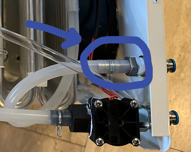

Hi Andreas. Can you tell me the name and part number to the fitting that connects to the push fitting. I circled it in blue in the pic. I would search for it myself but I’m not sure what they’re called. Thank you
Hey Jussi,
I’m afraid “Gewindetülle Gewinde NPT 3/8” - 9 mm, 16 bar Edelstahl" is not the answer you’re looking for. :joy:
But with the link below, you might be better able to identify what you need to buy.
BTW: I also removed the internal hoses by this one:
https://www.amazon.de/gp/aw/d/B09FDMMHRQ?psc=1&ref=ppx_pop_mob_b_asin_title
