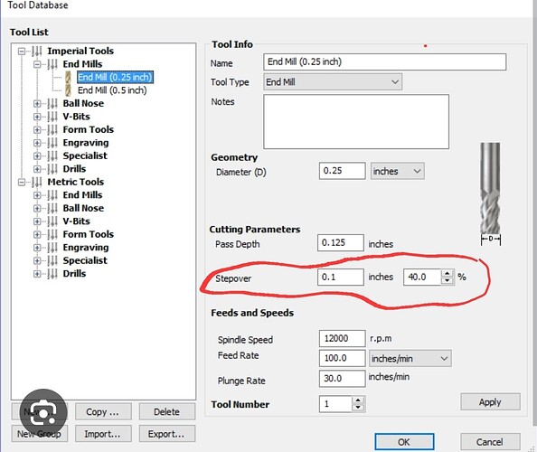

@JDog I’m trying to adjust my stepover and for the life of me I don’t know where the setting can be found on the OF. Can you tell me where it is… I do appreciate it.
Stepover is set up in the CAM software (f360, vcarve, …). It will be a % (of cutter diameter) or a mm/inch dimenson.
