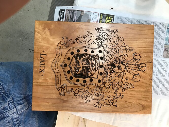

Coat of arms first attempt
This is my first attempt at this.
Photo to bit map to vectors
Carved with 90 degree v bit.
Used lacquer 2 coats
Mixed a black glaze and a copper metallic glaze
I will add three coats of lacquer sand as needed 320 grit
Final coat will be semi gloss
It measures 3/4”x12”x16”
Wood is black cherry
Vcarve pro software

Very nicely done. Lot of details
