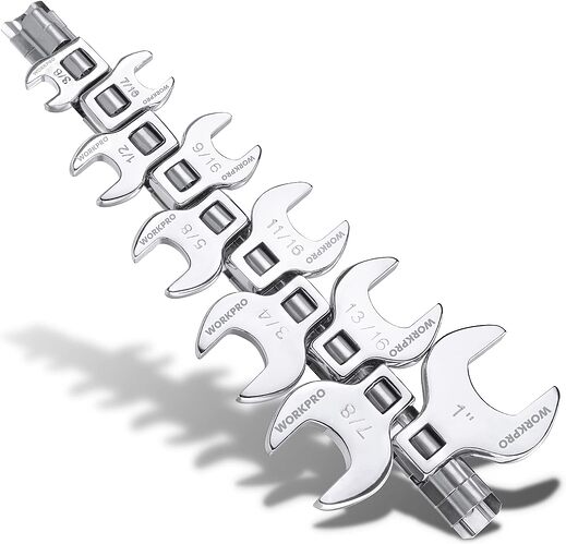

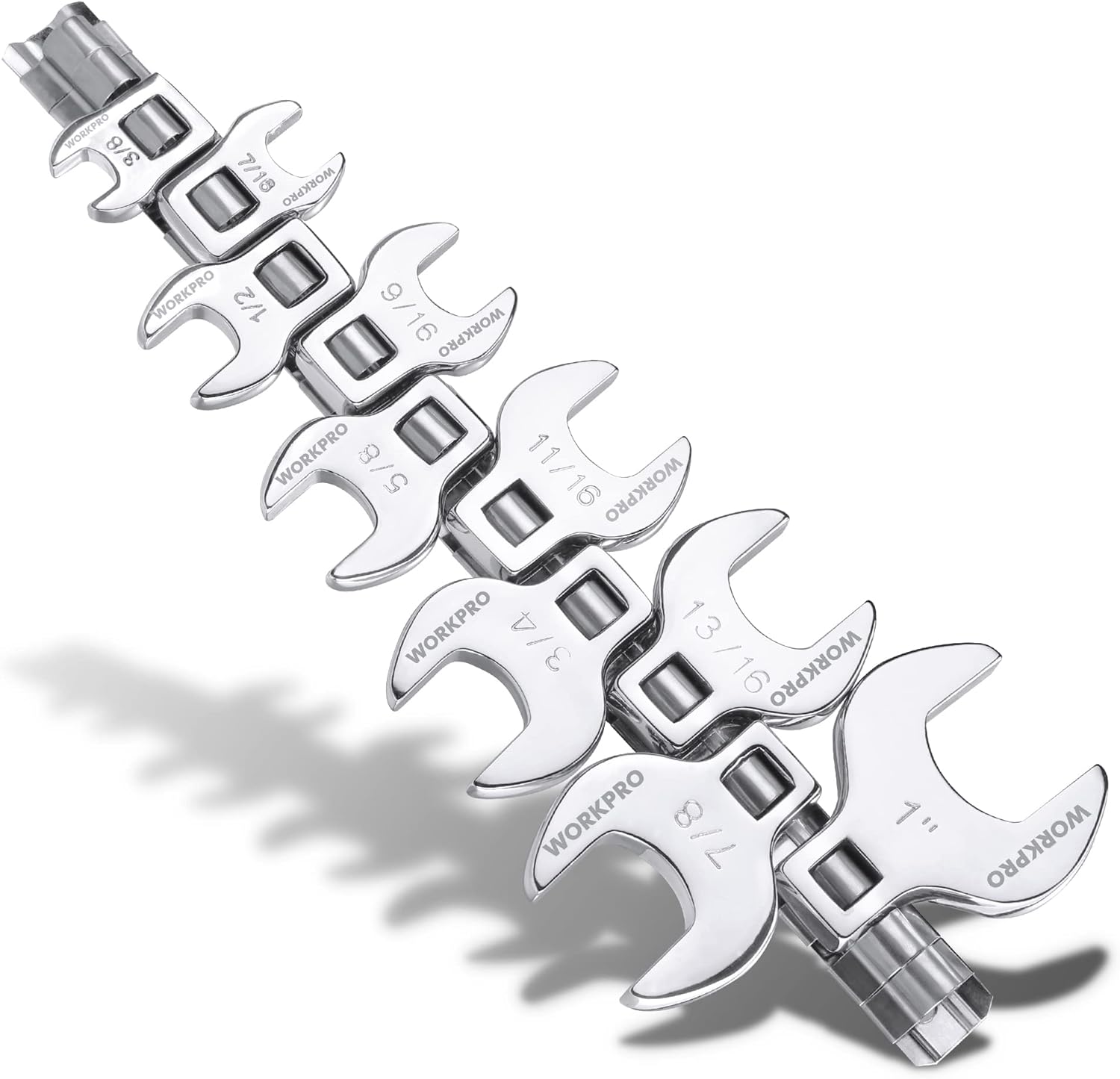

You could use a crows foot open end wrench with a socket drive torque wrench. But, I’ve never seen anyone do anything more than “tight but not monkey tight” which isn’t highly specific but works.

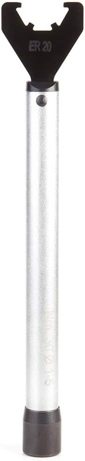

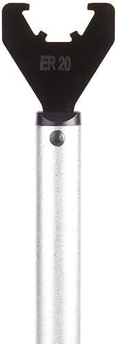

Thanks for the link to this tool. I was looking specifically to tighten the collet on the spindle. Something like this Amana Tool ATW-20 Adjustable Torque Wrench for ER20 Collet 35mm Dia x 13-3/8 Inch Length - Amazon.com.

If I want to go the torque wrench route, is this what I need? Thanks for your reply.
Whoa, that’s a tool. But no, I was thinking more a long these lines:
A standard ratchet head torque wrench fits into the square hole and operates like a socket.

The torque wrench in that amazon link is used for the “castle” style collet nuts.
I used one for many years on an industrial machine. They have 2 torque settings depending on which direction you turn. (Not to be confused with a tightening torque being different than a loosening torque. You flip it over to tight at either torque setting.)
I used ER32 collets for years with the small wrench supplied with the machine. I would have argued the small wrenches were fine. Occasionally tools would creep in or out of the collet and parts would come off the machine with defects. The tool length would be recalibrated and I didn’t think much of it. After getting the torque wrench and using it, I realized the small wrenches were not applying nearly enough torque. ER32 calls for 100 ft.lbs with a 1/2" shank.
Sources vary a little, but our ER20 collets call for about 25 ft.lbs when using a 0.25" shank, and about 60 ft.lbs on a 0.5" shank.
