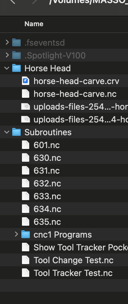

I try to load the carve, it says "ERROR ** Sub program file not found
In the carve file I see these lines:
N270 (Change to tool BnB - DNC250 - 1/4" Down-Cut Spiral - 425)
N280 M98 P631
And the Subroutines folder contains file 631.nc
So I am at a loss, and cant find anything in searching related to this issue.
Any ideas?
Mine do not have the ._ before the file name. I would remove the ._ and try again.
The files exist without the _ as well. thats just a file thing since Im using a Mac I think. Both files exist.
USB Directory:
the error

Try moving your project files into the root directory for the USB drive.
A limitation of the Masso system is that it doesn’t have a “search path” to go find files in other directories so your project and the Subroutines folder need to be on the same level.
This is one of my little irritations with the ATC…I like to organize multiple projects on the thumb drive into folders so they’re easier to find but I got the error message you did unless my projects were in the root folder.
