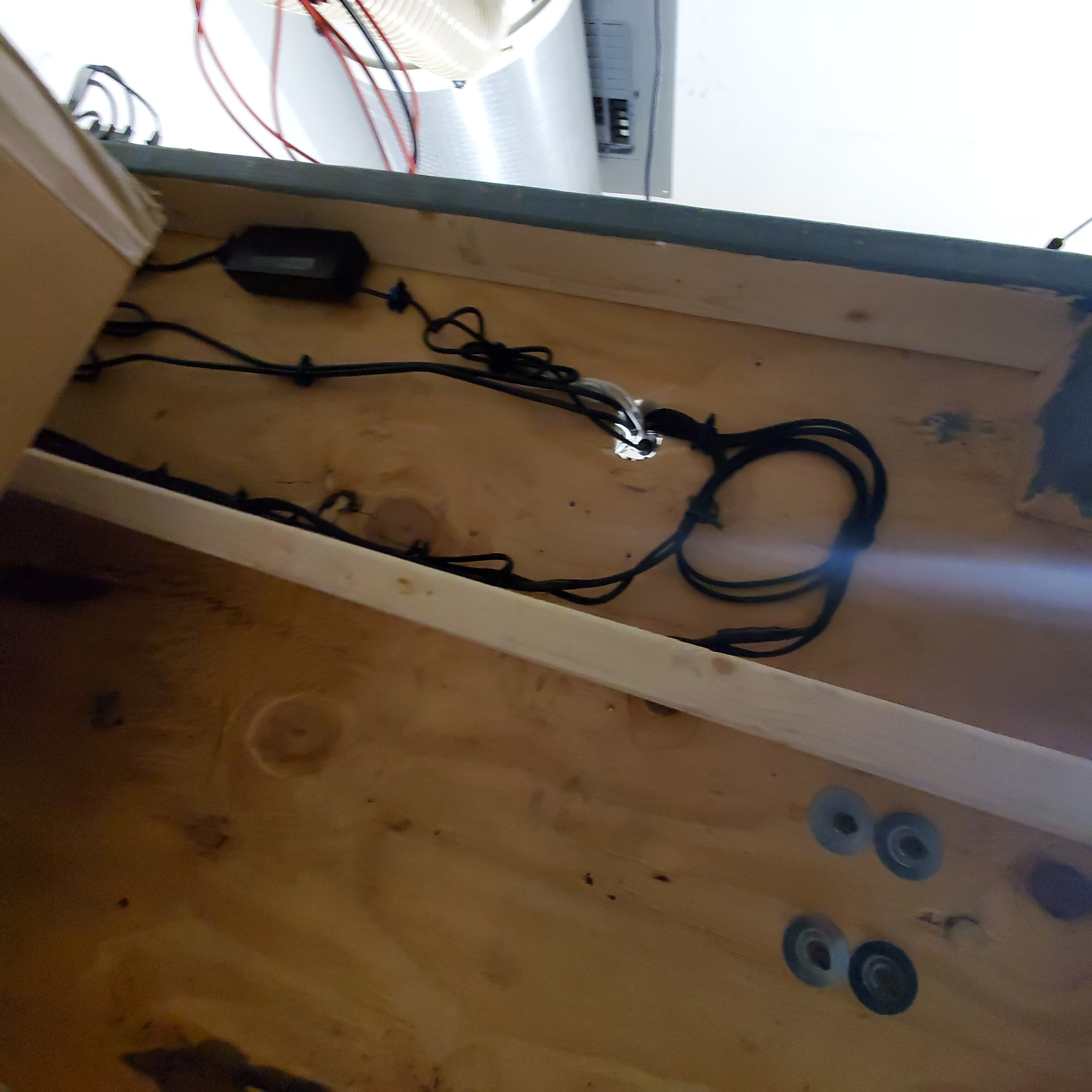

Final update on rewire
All i can say is what an amazing company!!!
The few little issues I had in completing this process was greatly supported by Onefinity.

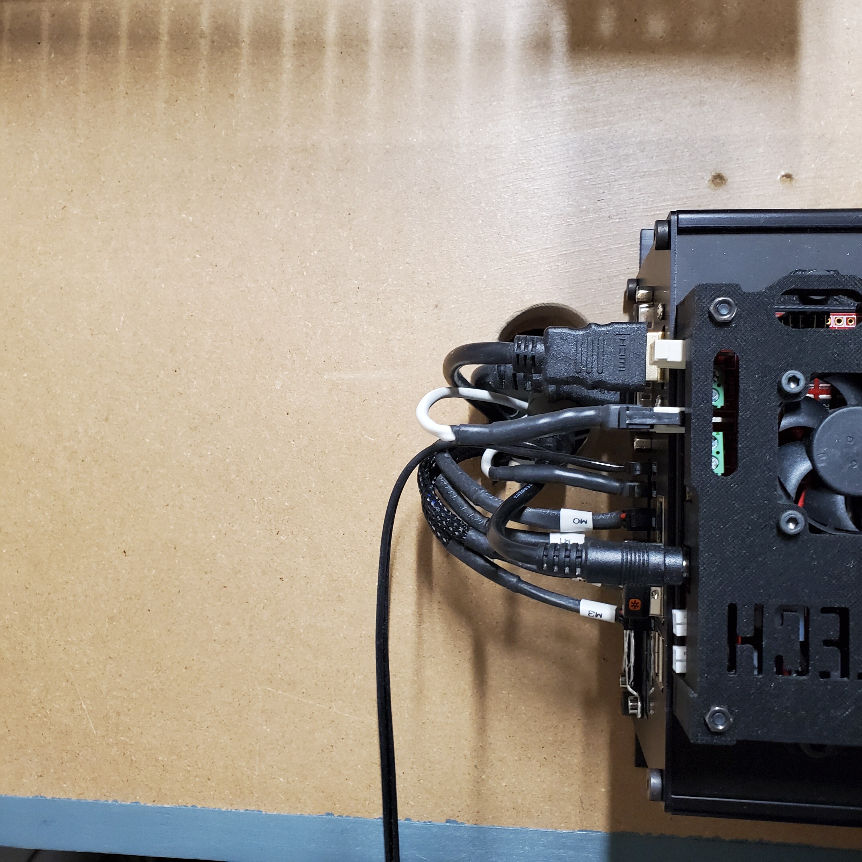

The results amazing only connectors are at the control itself everything else has been soldered, heat shrinked and cable wrapped. Everything routed neatly beneath the unit table have to love OCD lol. The machine has not skipped a beat or any homing or jerky issues. Now time to do some projects.
Excellent news - would appreciate seeing some images of your - OCD - I mean, handy work.

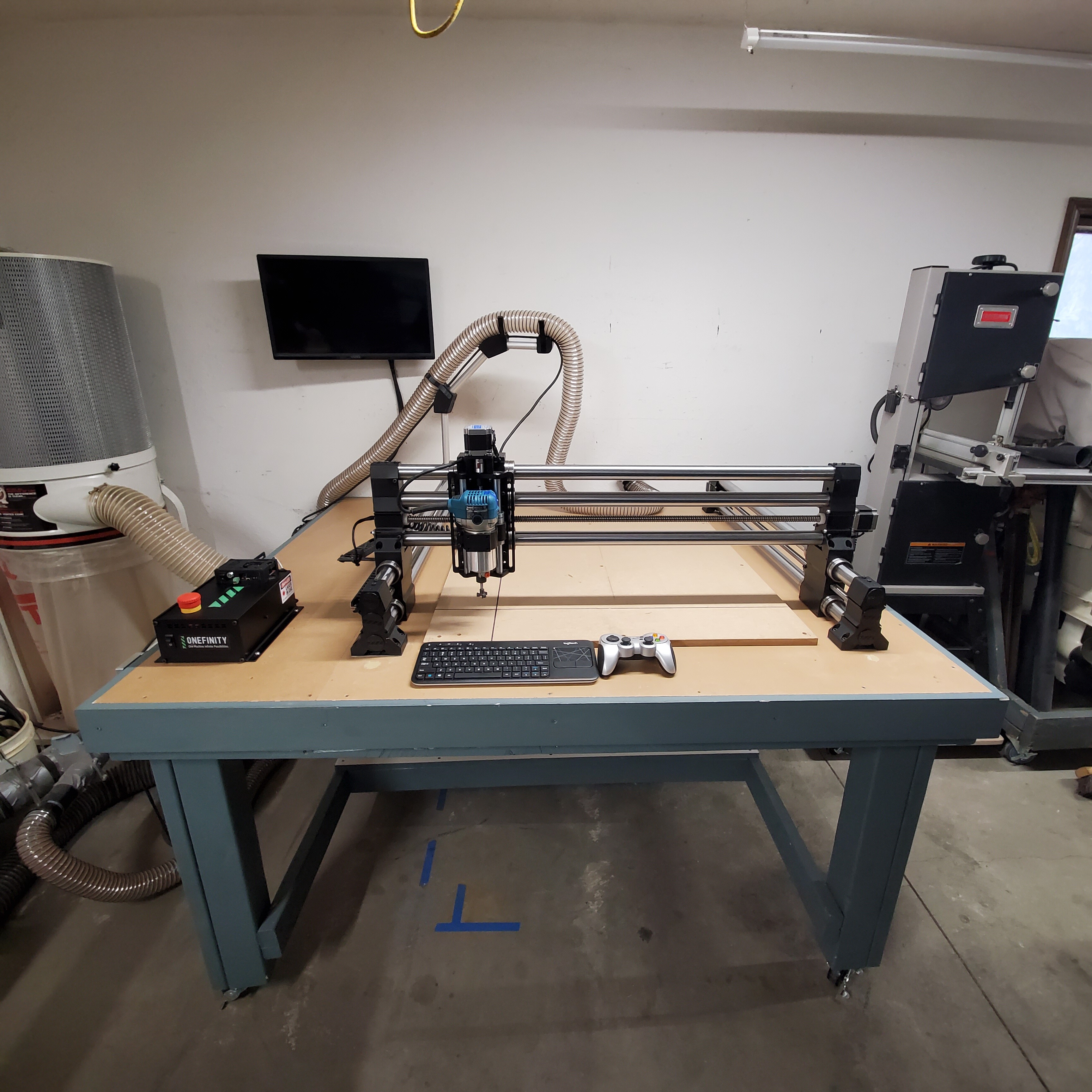

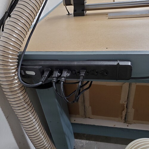

Pictures Added as Requested
I used Rowdy Roman’s end caps just to keep dust out of the tubes
I appreciate your time and effort, as this is one modification I was also considering.
cool my table is painted the same colors lol
Mine is pretty close to the color too!

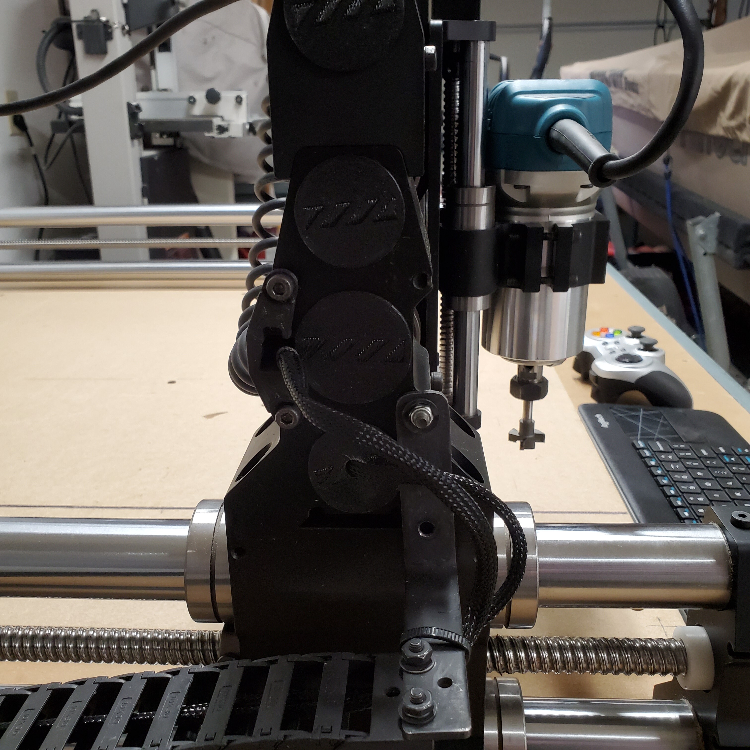

Not having a 3d printer (and wanting to solve this myself) I used aluminum angle, some corner brackets and machine screws.
Jus added the wire extensions and took the security tag bumper off the router cord.

They were each 1 meter but I did adjust them by popping off pieces. I believe what I removed from on I added to the other. Ordered 2 of these
