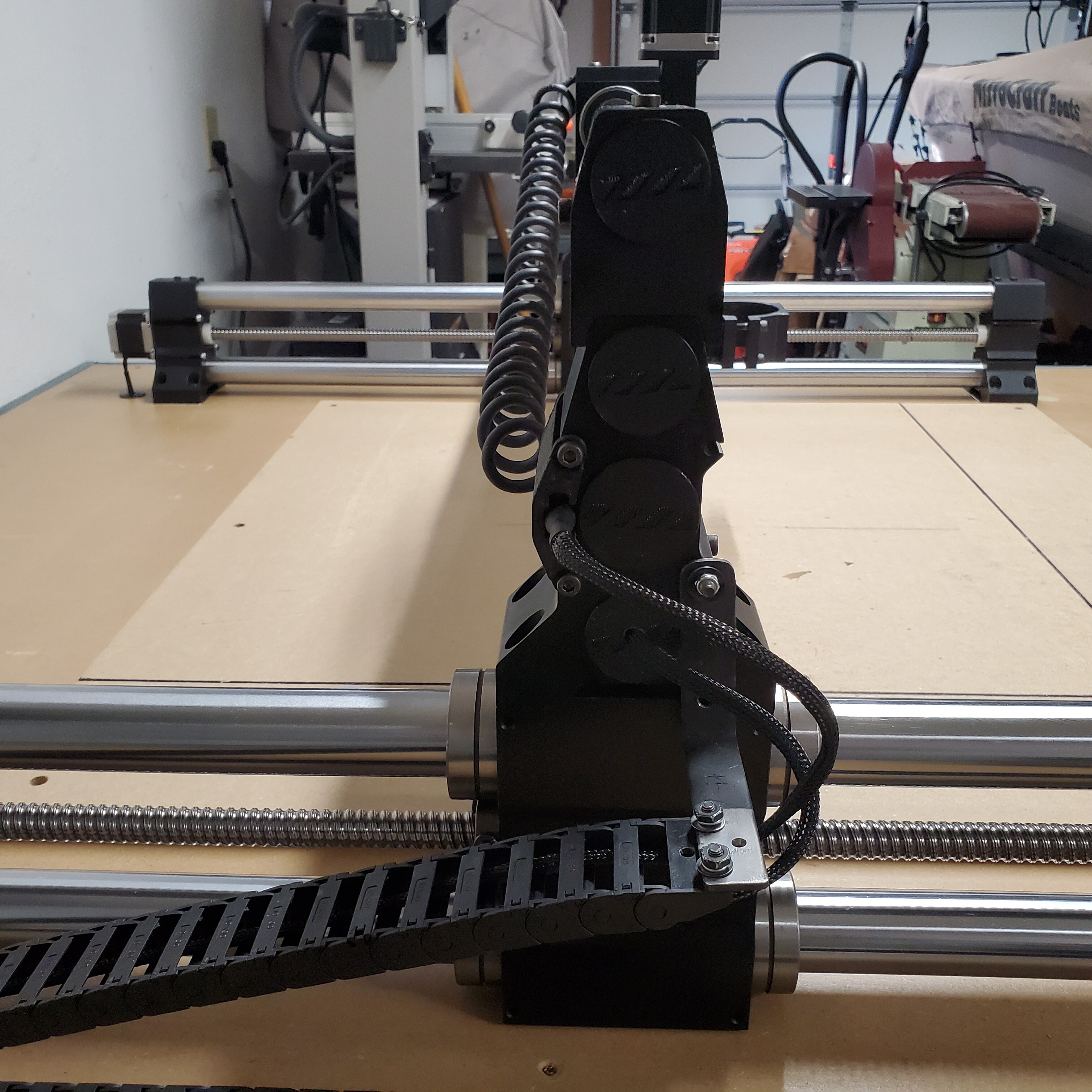

Thank you for the info above it has helped a lot and the bonus is they have a distributor in the UK so I am well happy.
I set my machine up everything went great,
homed in on all axis but then I set up drag chains and used the extension cables Onefinity supplied and it all went a bit wayward.
The Z won’t home and sounds like its grinding (probably a loose connection)
So I have decided to make my own extension cables in one length as opposed to having connectors in between
Can I just ask is it 18awg wire that is used?
For now, I am going to revert to the original set up until parts arrive
Thanks again for your help
Paul
Hi Paul - I believe they are using 18awg - it looks bigger than 20 or 22 to me, and the outside dimension is ~0.064 which is consistent with 18 gauge (though outside dimension is a poor indicator of wire size). I believe someone on the forum said it was shielded “alarm wire” – a quick google of alarm wire turns up many hits. You definitely want stranded wire, and I like to solder the wires into my pins when I can. I know they are “crimp” pins, but solder can’t really hurt and ensures a good connection over time. If it matters, solder directly to the pin after crimping, don’t tin the wire and then crimp - that makes a connection more likely to fail than without solder.
I actually asked 1F support and they said they belive the wire gauge is 22 AWG.
I originally ordered 18 but I canceled the order and went with 20.
I was afraid that 18 would either be too big for the pins or wouldn’t be flexible enough. I was afraid 22 wouldn’t carry enough current. So I compromised at 20AWG
I asked the same question and they spec out 22 gauge, which is what they actually sent me a link to the wire they recommend from Amazon. I have recieved all my items finally, in process of wiring the machine up with no connectors except at the controller itself. Once I get things rolling I will post pics of progress and results.

Good to know. The pins are rated for 18-24 I think, but it does depend on the specific item number. 20 awg seems like a good compromise.
Update on the rewire, I have removed all plugs rewired all motors with direct wiring, still need to add the new connectors to the controller. Once completed will run some tests to see how it runs hopefully this will eliminate the connection issue’s I was having.
Nice work Kurt. Took me a little while to figure out what you did with the Y-axis wires, but I got there. I might do the same - it never occurred to me pull them straight down instead of through the axis.
Yes I did pull out of the tubes as well as removed a the connectors from the wires and extensions to make them one continuous wire. I have to finish the connectors that go to the controller and then test to see how well it works with no connector extensions.
If you are new to CNC - like me - and are building a drag chain system pay attention to the bolt pattern for the ends.
Of course the chains I received a few minutes ago are exactly opposite of what I needed. Sigh… :grinning:
At least Amazon has free returns.
I just discovered this same problem. I may keep the drag chain and re-design the brackets from @muddyfeet since my power cord is slightly larger and my cooling tubes are slightly smaller. I might also look at printing new ends for the chain. Too bad there is not a standard for the mounting ends.
