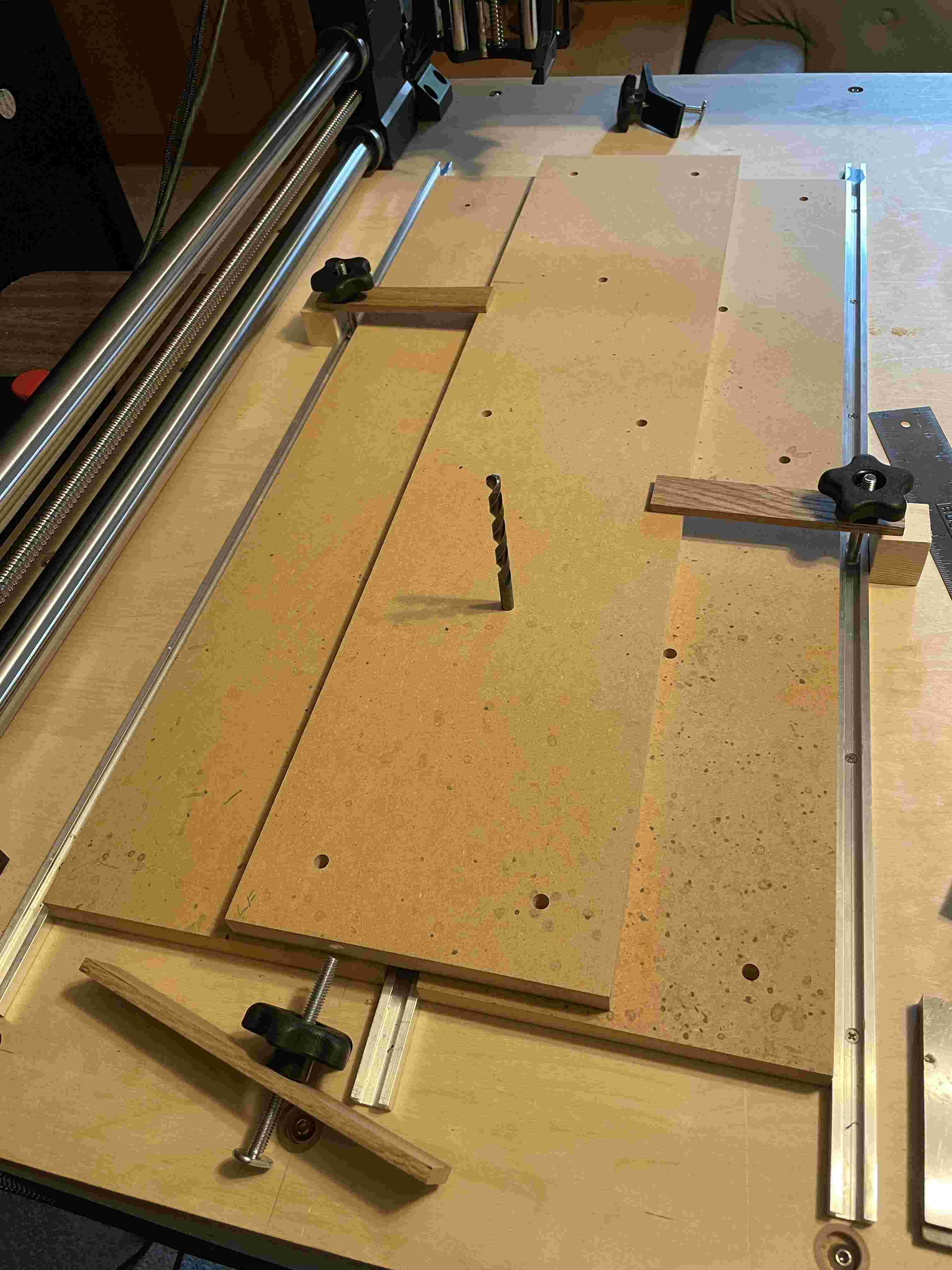

My first attempt resulted in holes that were off… Not much… but were off. I assumed I didn’t have it lined up correctly so I went to much more trouble on my second try.
My spoil boards are 7.5" wide and have been cut very accurately. To make sure my second try to be used as the drill template was as parallel with the Y-Axis as possible, I used another spoilboard butted against the Y Rail as a guide to clamp my work piece in place.
Careful measurements afterwards showed that the board was as parallel as possible. The picture was taken after most of the clamps had been removed.

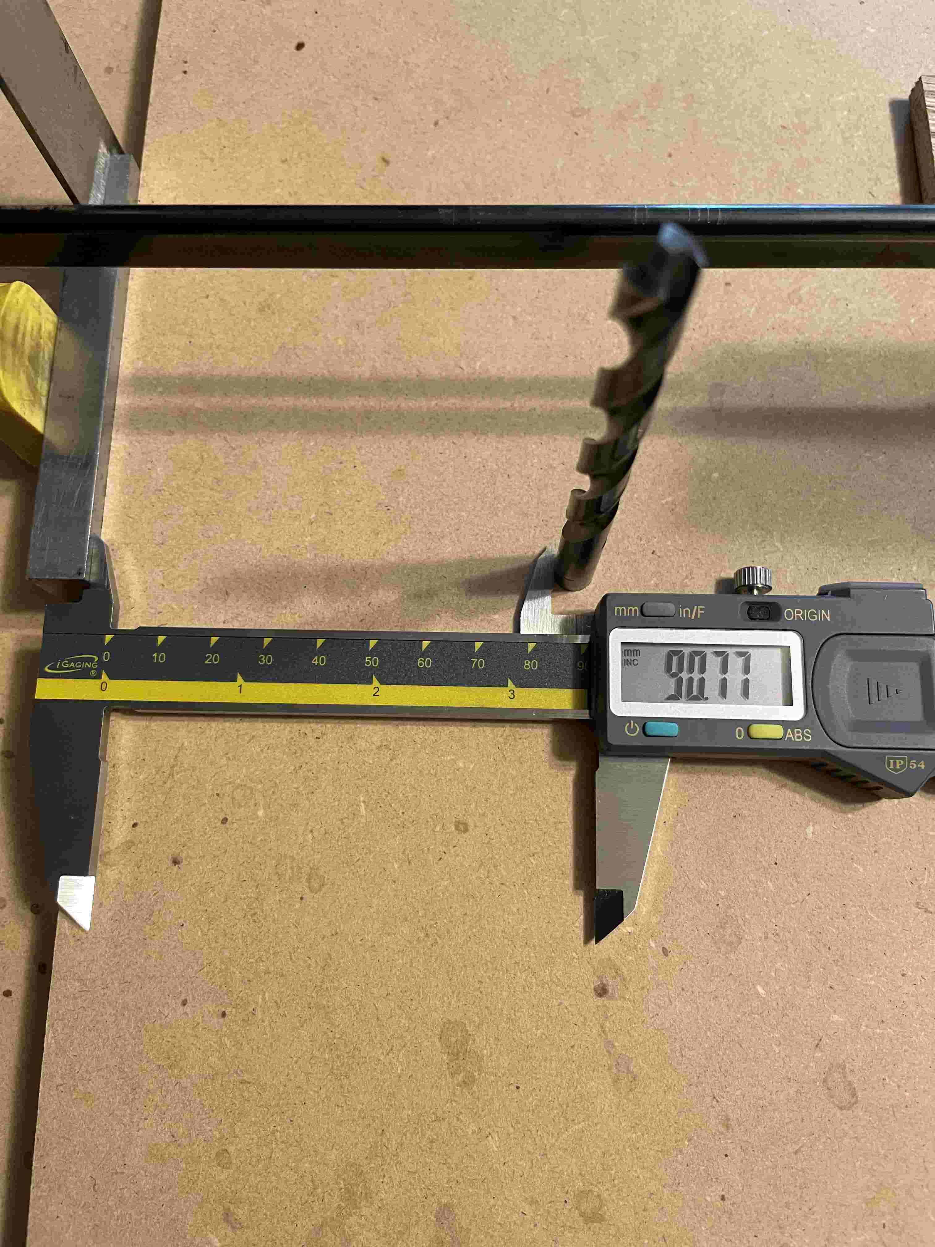

The holes are 5/16 and are quite accurate. Pushing a 5/16 drill bit into the hole actually causes a little pneumatic push back and a pop when removed.
The holes are still off. Not a lot… but too much to be used as a template. They are almost the exact same as on the first attempt.
According to Fusion, the corner holes should be 34.125mm to the edge. The hole in the middle position should be centered. (91.275mm from the edge.)

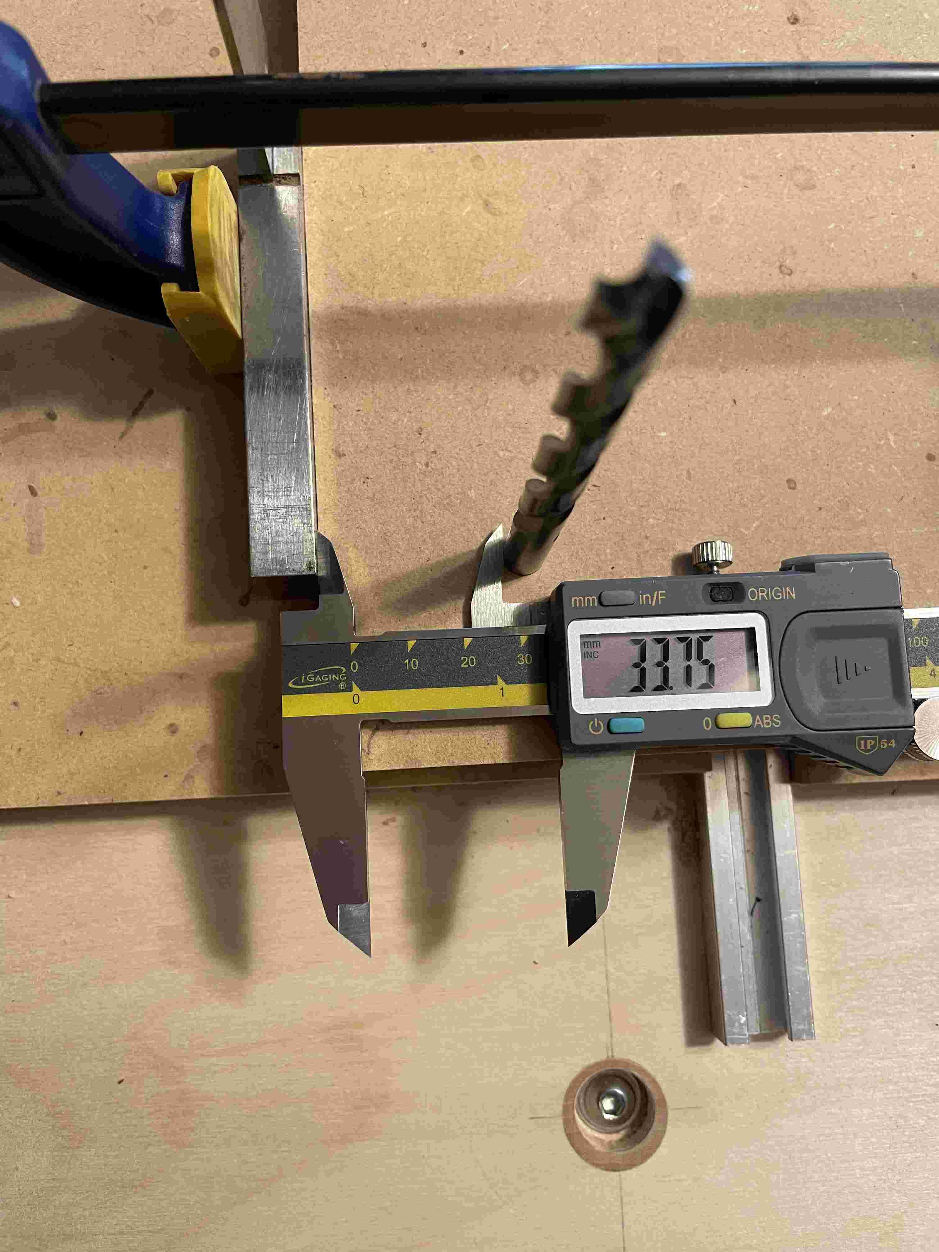

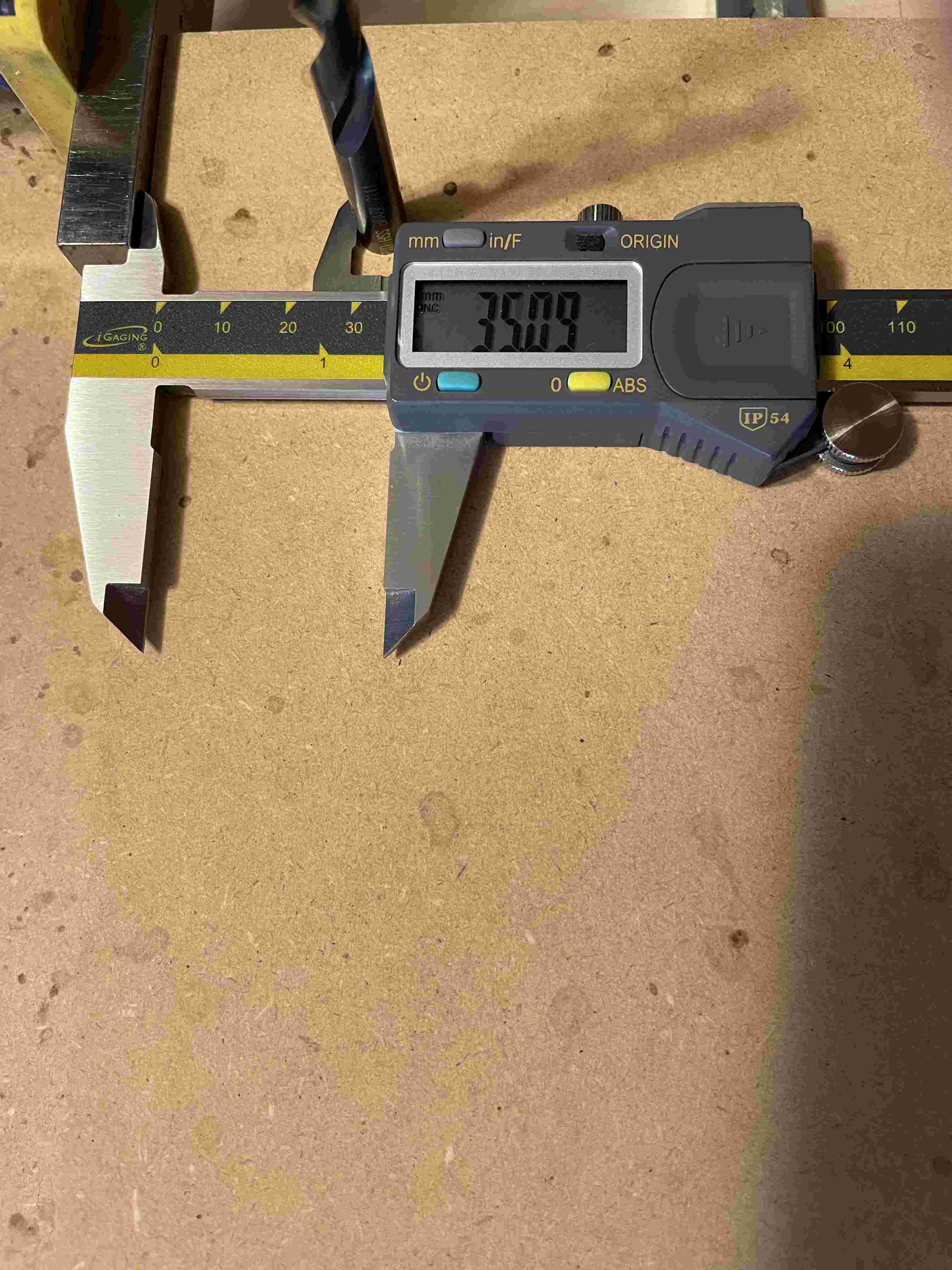

The pictures below show my measurments.
Left Side Edge
Right Side Edge
Left Side of Center
Right Side of Center

Hi Ziggy - based on your Fusion file, the center of the bottom left hole is 38.10mm from the side, or 34.125mm from the edge to edge as you indicate, leaving 0.375mm difference. That’s not huge, but certainly not within the specs I would expect.
Have you calibrated your X and Y axis to ensure they are traveling the proper amount? For a 5/8" hole the error would not amount to a lot, but the further you travel, the more the error. Though I will admit 34mm is not a lot of travel - I mean my machine was off by ~1.58mm over 812mm, which would be 0.066mm for 34mm–completely imperceptible by the eye.
Second - are you 100% sure your stock is 190.5mm wide? That is what your setup says.
Recommend making a few fixed size cuts using a v-bit if you have one - something like 100mmx100mm to see if you are getting the correct size regardless of position.
Let me know and we can dig further.

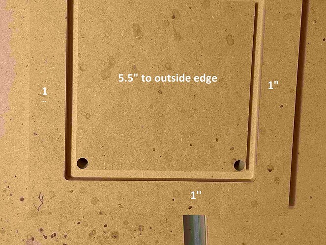

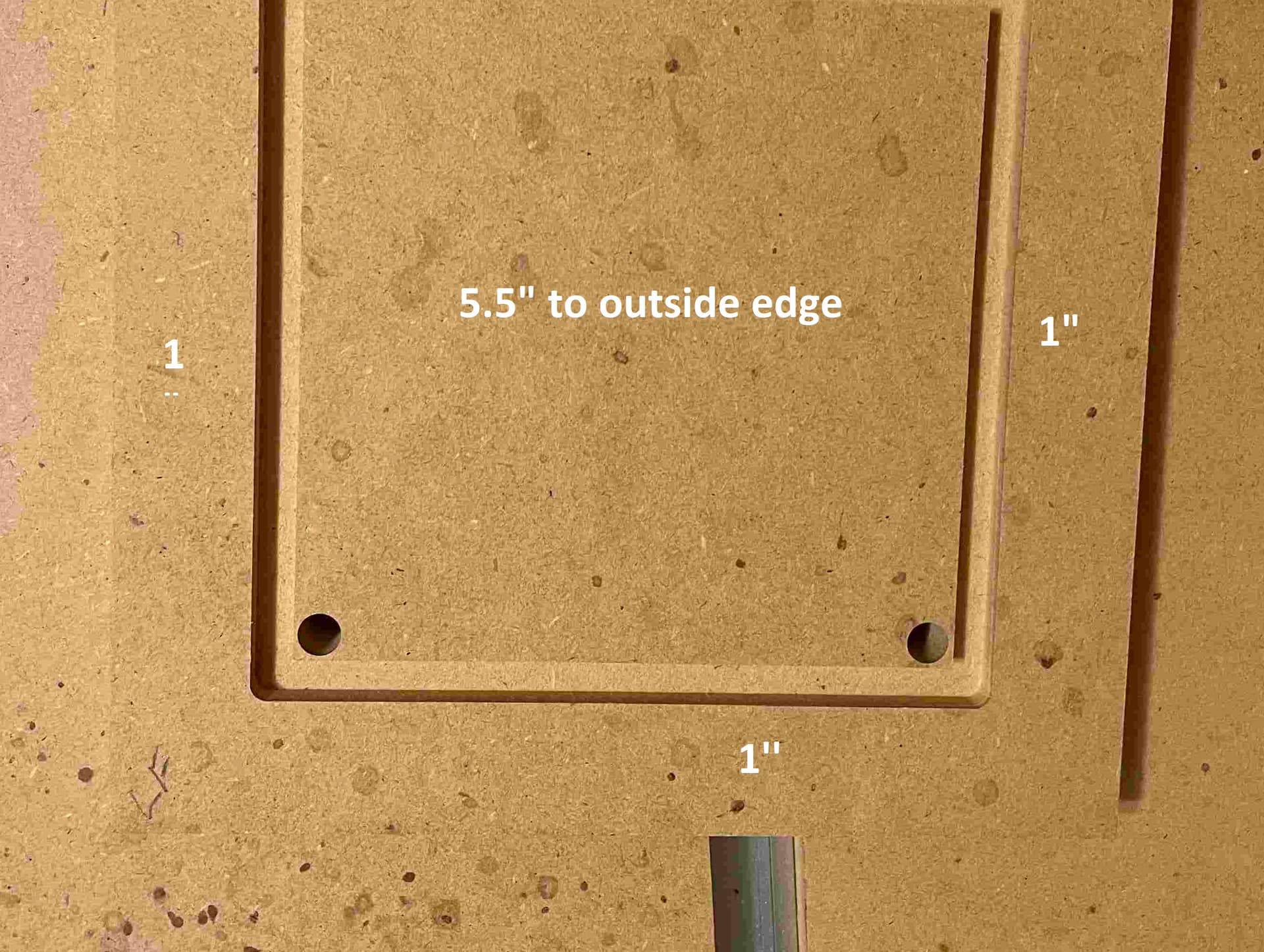

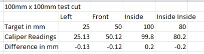

Ok… I created a few test cuts. Here is what I found.
The first cut was done in imperial. I basically cut a 5.5" square, 5/16" wide 1/4" deep trough. The pattern should have been one inch from three edges since the MDF is 7.5" wide.
The measurment on the right may be a little off because I have been using a ruler to cut my boards rather than a caliper. Maybe the board is slightly wide.
(The bottom edge is hard to see.)

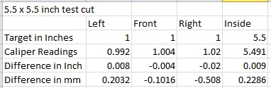

Here are my measurments:
inch test

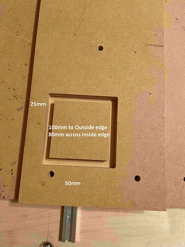

I also did the same type of thing in metric. This time it should have been a 100mm square, 10mm wide, 5mm deep trough.
mm test
There two crazy things about the metric test. First is that instead of the bit ramping into the cut like the imperial test, it immediatly plunged the full depth. (Probably a CAM difference??) The second thing is more troubling. It plunged 12.5mm rather than 5mm. I assumed I screwed up the drawing but I checked it and it does indeed show 5mm.

@Ziggy are the test cuts in the same board? If you are going to be using different boards and want to repeat something precisely then I would suggest creating some jig boards along the left and bottom of your spoil board that are perfectly square so when you put a new piece of material in the jig two sides will always be in the same position. If you just try and clamp a piece in the same spot you will have small variations in the position of work piece from piece to piece. Not that this is what is happening but just a suggestion. There is a peg jig system that works just the same. The idea is every board starts in the same spot so you do not need to repeat the x and y probe between projects.
Also when probing x and y its a good practice to hold the block down carefully while the probe is touching the block. I have actually seen the bit move the block as its probing when my material surface was polished.
Thanks JDog.
I was referencing off of the Y - rail with another board to get these parallel.
I slowed my movement down to 50 on the probe and I hold it as well.
