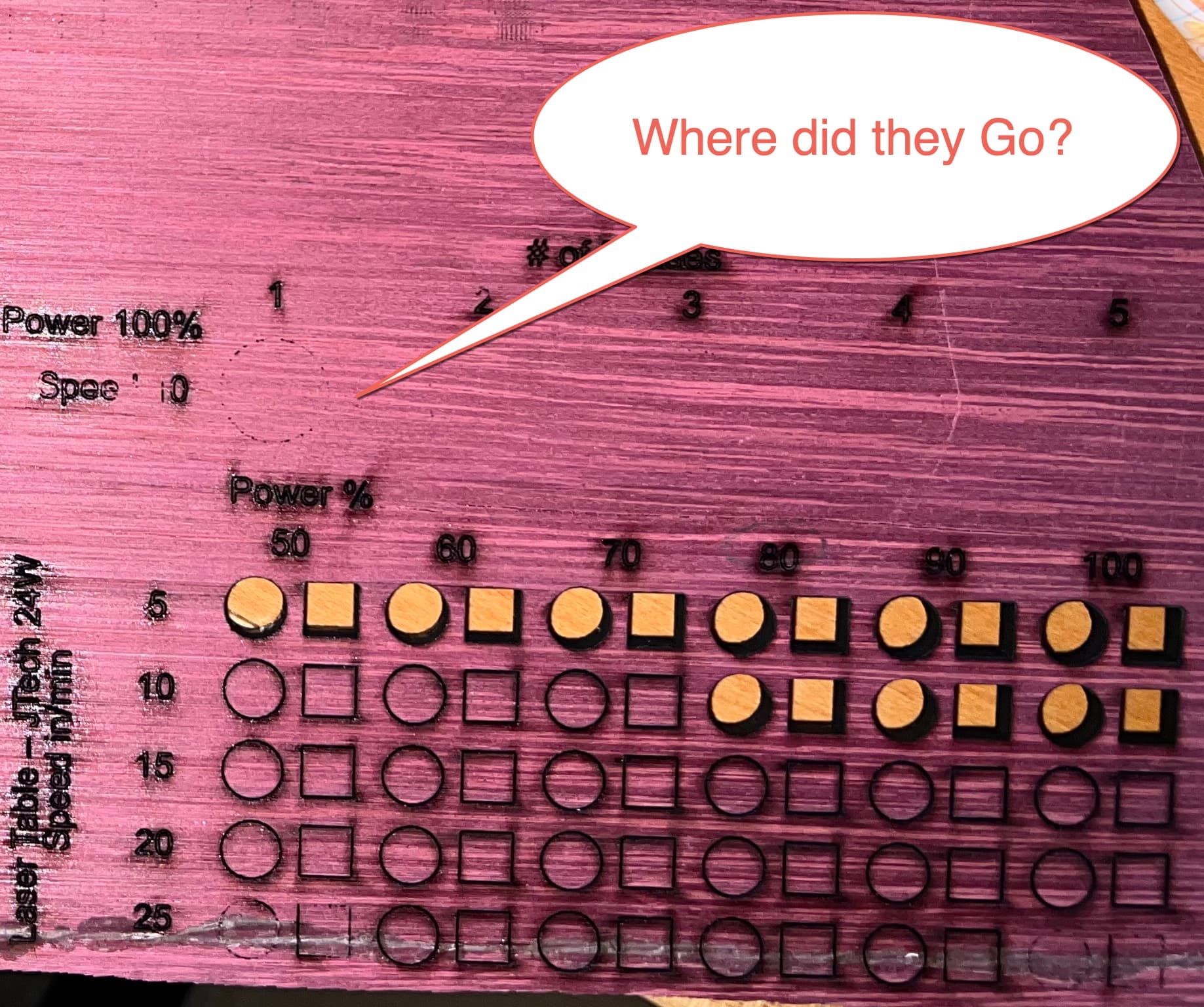

I’m new to forums and don’t usually participate, but I am baffled and in need of help.
I have had some second thoughts about the JTech 24W. When I first set it up it would not fire until I got up to M3 S13 and then it would flicker. I noticed it would be consistently on if it was not moving, but when moving on the 1F it would flicker. I increased to S20 and still a flicker. Any think Higher and it leaves a mark, so I stopped at S20.
I then did some test gradient cards. The first two came out just fine, so I thought that the glitching may just be how it worked. Odd, but whatever. I then did a test piece to see the power, speed and number of passes it would take to cut. I make these files so I can just run on the wood type I am using when I need them. The laser did what was expected, but missed some of the labels, then just stopped working when it got to testing the number of passes. I stopped the G-code and turned off the laser controller for about a minute and then tried again. It worked fine. I Thought, meh, maybe a one-off-thing. Nope.
Below is a picture of what I am talking about.

Did you use a small screwdriver to turn the Potentiometer up a little higher? It can cause inconsistency if it’s set too low.
Thank you for your suggestion. I just adjusted the potentiometer so that it was not glitching at S1 like I had with the JT7w. I have ran two successful projects so far. Fingers crossed it stays like that.
