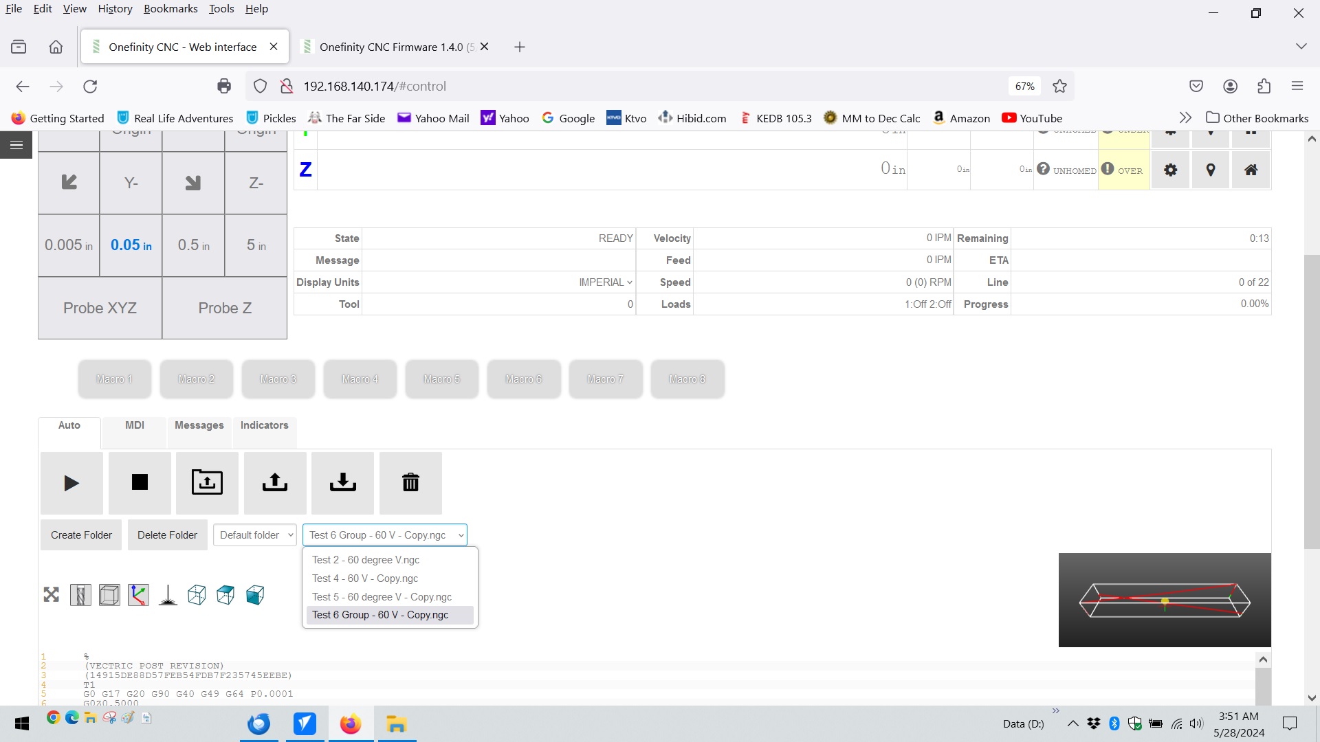

I discovered that if you have a degree symbol (°) in the filename, the BB controller will not recognize the name and gives you a blank entry.
Pony
Hi @Pony , Thanks for the feedback. Do you have sample file which you can send here? So that, we will investigate from our side and update on next release. Thank you!!
Here’s a little test file that I just made up this morning to retest what I had found.
The zip file contains the original file and the 3 toolpath files (1,2,3), it also contains copies of those 3 files which I renamed out of the CAD system to remove any degree symbol as a 2nd test (4,5,6).
Upload the 6 files to the BB controller and see what you get (if you upload a file with the degree symbol first, it will act as though there is no file, yet you will see cutting time).
I get all 6 files, but only 4 filenames (the 4 that have no degree symbol), yet if you delete them 1 by 1, you’ll have 6 files to delete, but 2 will have no name, but will have a long blank name which will NOT show up until named files are deleted. Those are the 2 that have the degree symbol.
