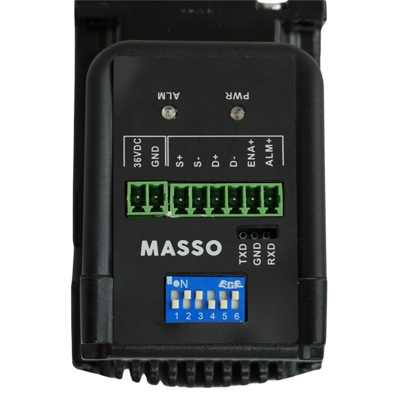

Wiring diagram
  • 36VDC = Positive Power - Red Wire
  • GND = Ground Power - Black Wire
  • S+ = Step Positive - Yellow Wire
  • S- = Step Negative - Orange Wire
  • D+ = Direction Positive - Gray Wire
  • D- = Direction Negative - Black Wire
  • ENA+ = Enable - Green Wire
  • ALM+ = Alarm - Purple Wire
Dip Switch Location:
Dip switches are the white switches numbered 1-6 in the blue portion of the motor.
Dip Switch 1 is Down/Off
Dip Switch 2 is On/Up
Dip Switch 3 is On/Up
Dip Switch 4 is Down/Off
Dip Switch 5 is Down/Off
Dip Switch 6 is On/Up
Switch 1-4 adjust resolution.
Switch 5 is the rising or falling of the clock edge of the step signal.
Switch 6 is motor direction.

Status LED & Alarms
The motors provide two visual indications of motor status.
A Green LED indicates that the motor is powered.
A Red LED indicates that the motor is in an alarm state.
Alarms can be caused by any of the below reasons:
• The enable signal of 5v to 24v is not received by the
motor.
• The motor received STEP signals that have acceleration
or top RPM higher than the motor can support. This
will also be affected by how much load is on the motor.
• The power applied to the motor is less or more than
the motor’s specifications.
• The current required to work under load is not enough.
• The motor is not able to complete requested rotation
due to external mechanical issues such as the machine
axis hitting something or getting stuck.
Motor Light Meanings:
GREEN: Motor is powered
RED: Motor Alarm
GREEN / RED Alternating: The alternating Red Green motor alarm indication shows loss of position.
