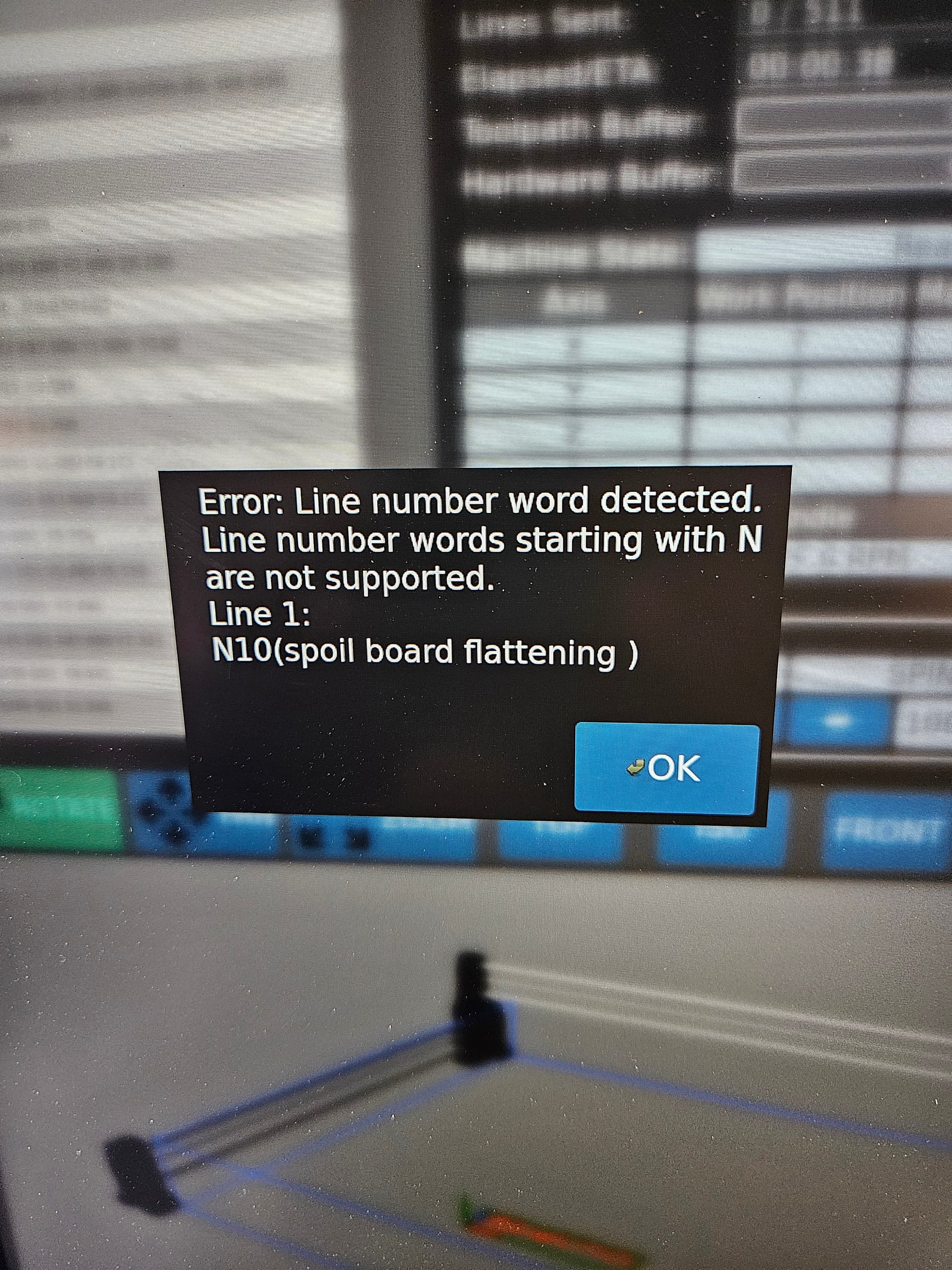

I finally got my new early adapter redline cnc together, I tried to run a spoilboard flattening file, I import it and open it and it gives me an error. I’ll try to put a picture.
i opened and ran the test file that was already on the machine and it worked fine.I use carveco, the file format is onefinity elite (inch)*nc . Has anyone else experienced it?
Your using the MASSO post processor (update your Carveco for your post processor to reflect that)

That was it, thank you very much, I wasted a lot of time on this .
