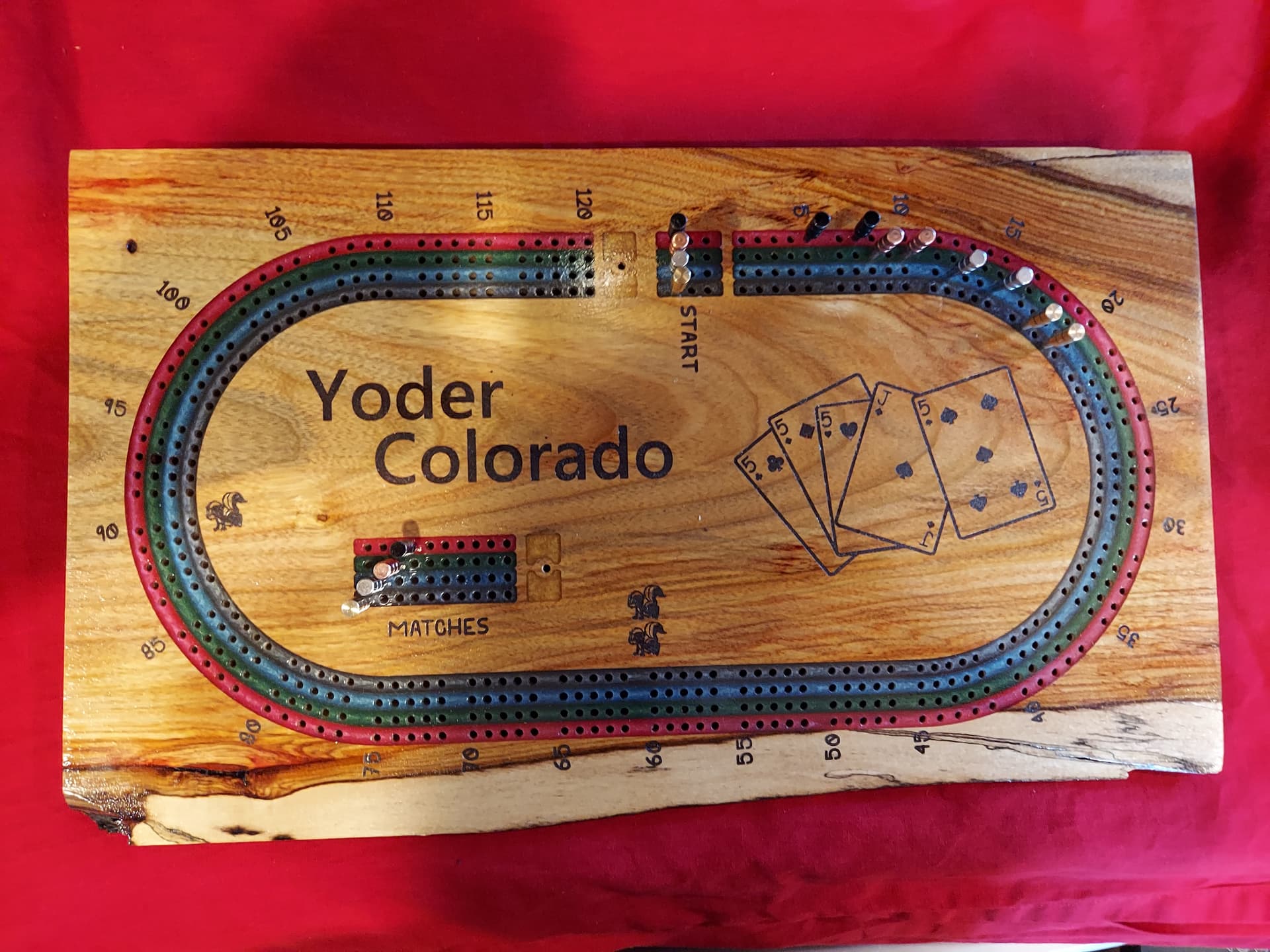

Epoxy inlayed, laser engraved cribbage board
much easier now days with the cnc cutting it out for sure, but still plenty of assembly, sanding, and finishing work. but also very enjoyable doing it, and can’t wait to see the look on her face when I give it to her!

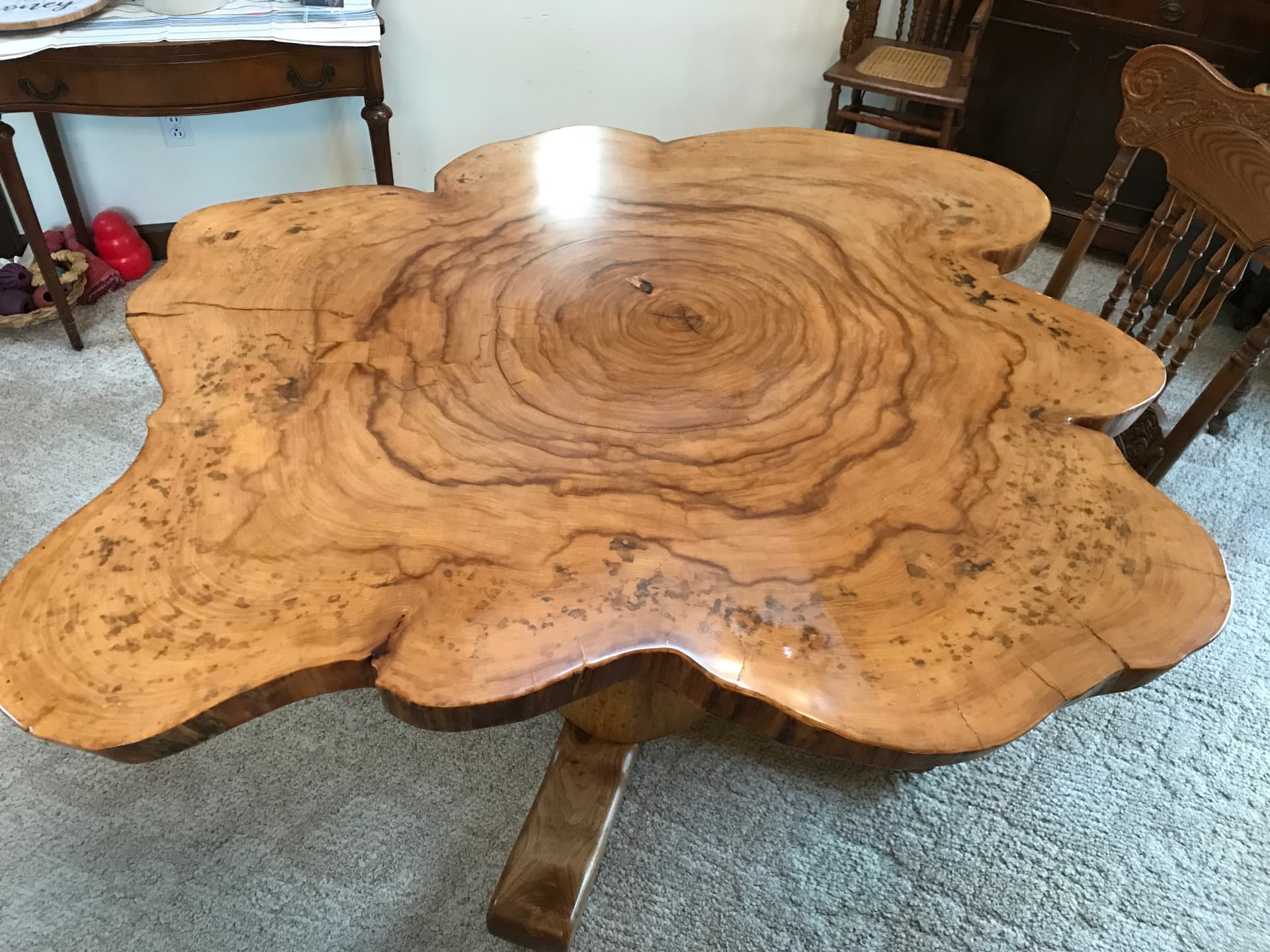

This is my last epoxy job
It is a cross section of an American Elm tree that was cut in the late 1950’s
To give some scale the top is 68ā€ across
So another tip is doing a seal coat when epoxying wood, shell or rock. I paint on a thin coat over the wood and rocks and give it around 12hrs to get really tacky and then pour my flood coat. The first thin coat will trap any air into the wood or rock and keep it from releasing into the larger pour. I let that get hard then sand it down flat with 180 grit sandpaper. After its perfectly flat I pour my final coat with countertop epoxy.
