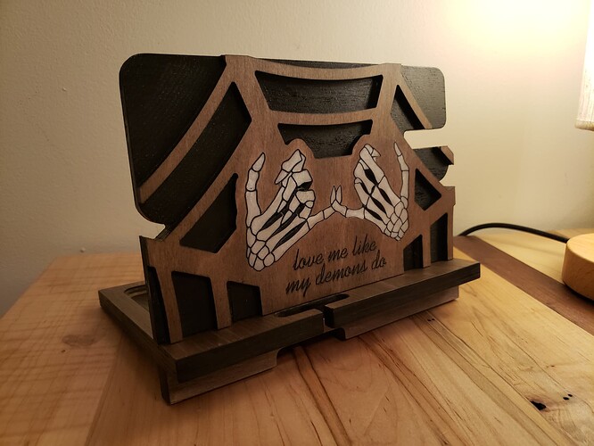

Been making some phone+watch docks.
Variations on a theme. All customized for the customer.
