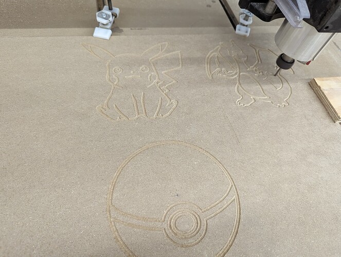

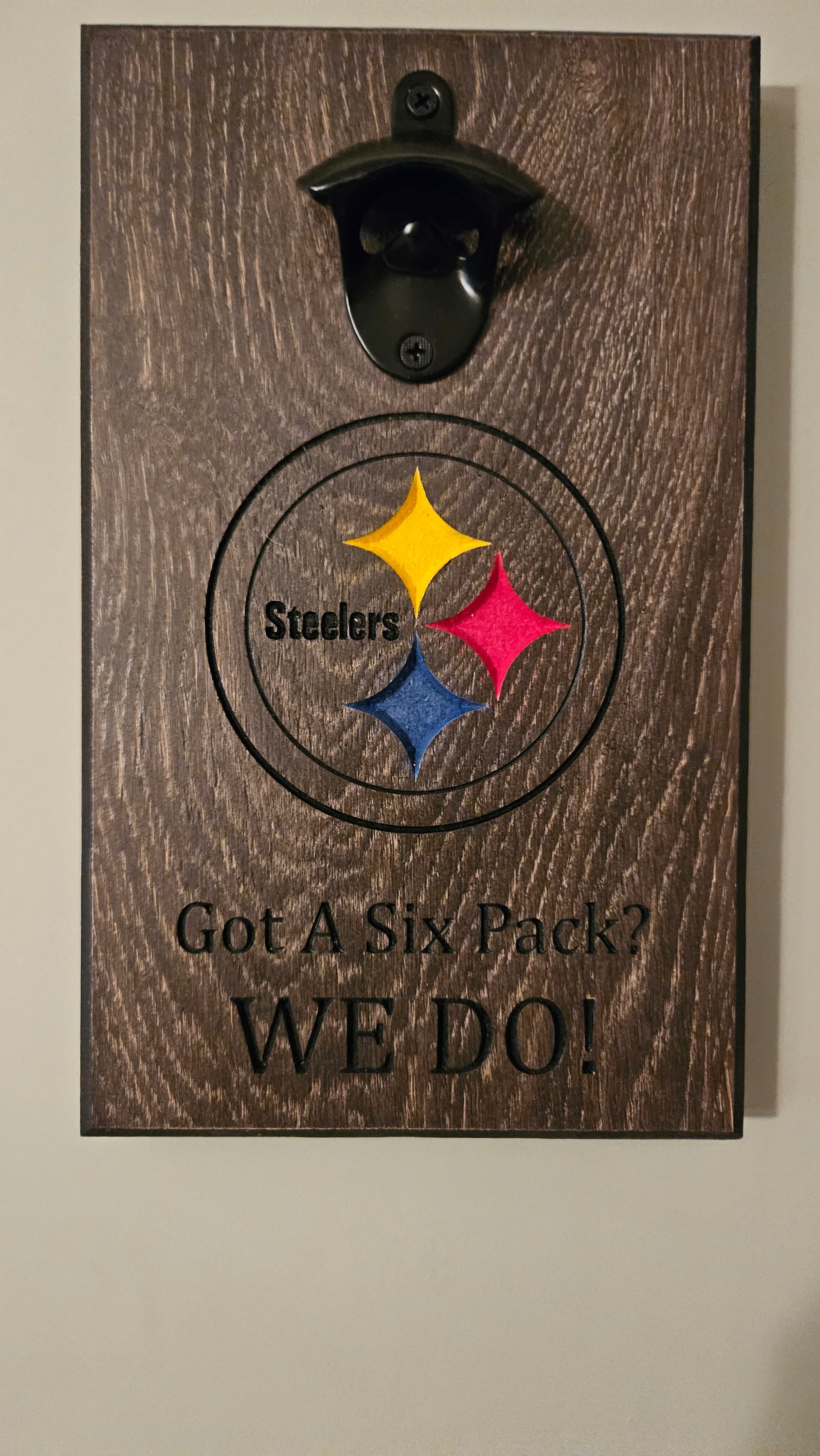

I used a simple 30 deg. V-bit I got off Amazon. Pretty much my go-to bit for most engraving jobs.
But the technique is very important to get it to come out this clean.

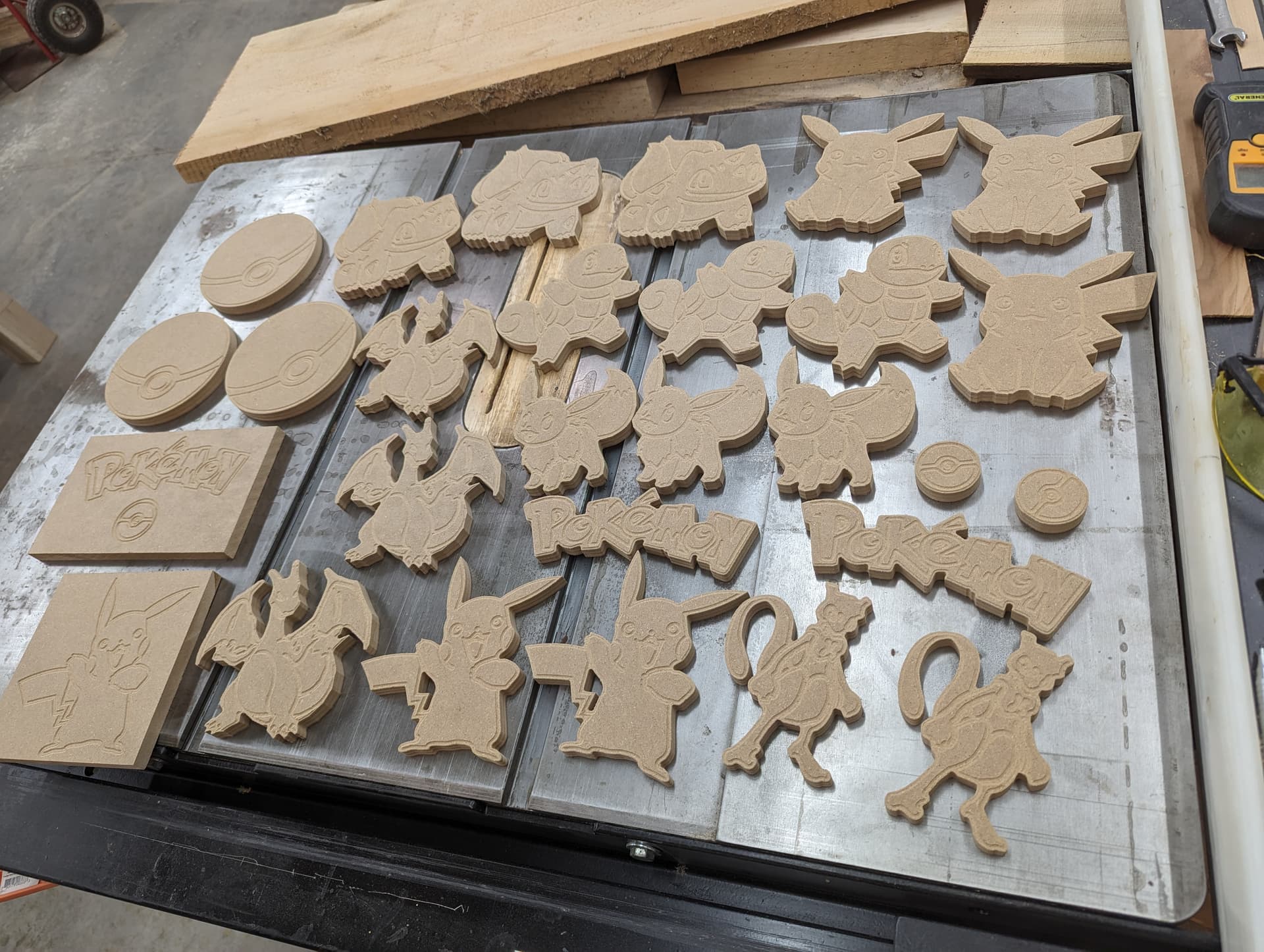

Tried something a little different with this piggy bank. Need to knock a couple more out before Christmas.

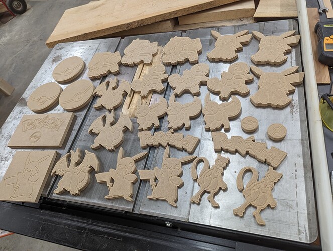

Firends kids are into both painting and pokeman… Figure this will keep them busy for a while.

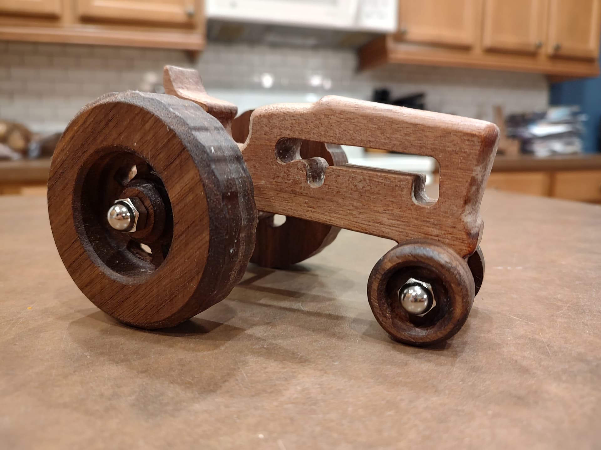

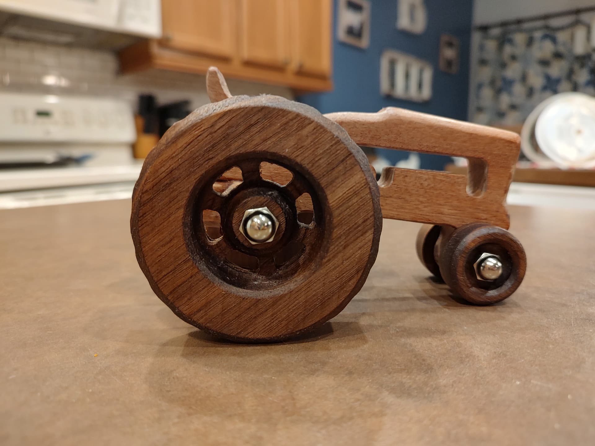

The 1F make such awesome toys and toy wheels. Knocked this one out this afternoon. Farmall H cartoon scale. The tread on the tires make such a satisfying rumble sound.
Couple things I’ll change on grain orientation on the next one, but good enough. Sapele and walnut.

A big smokestack and a rollbar and it’d be ready for a pulling contest!
Pony
IH has always been a family favorite. I thought about a smokestack, but thought it would be too delicate at this scale.

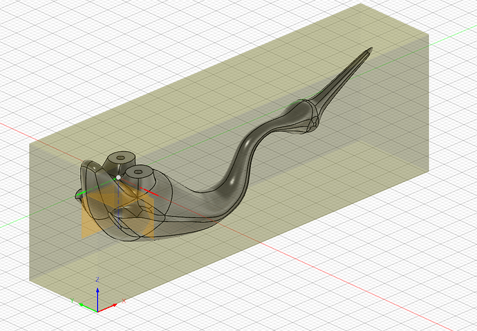

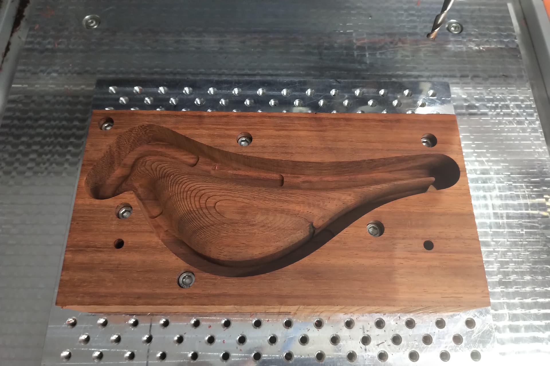

Some 3-sided carvings of Herons in Walnut. The third side (bottom) was to get the area between the legs and drill out mortises for the leg tendons. I printed the legs and feet to go with the bodies. For the base I made a random shape with tapered edges and used a picture of sand ripples off the web to create the 3d top surface effect.

I’m trying to understand how you did these. I assume left and right sides are the first 2 as per a normal 2 sided project but the bottom seems like a challenge. Do you do the 2 sides then put the bird in a jig of some sort to do the cutting on the bottom? How to you manage to do it without breaking off the neck? I’m assuming if the bird is laying on its back, then the neck is pointing up well into the danger zone of moving machine parts.

@SkyKam I really like these. I have been perfecting my 2 sided 3D carves using F360, and have a system now that allows me to make my ‘Eames House Bird’ inspired carves with greater efficiency. I appreciate the work that you put into these, and the use of the 3D printed parts. I used mine to make a jig, based off the bird body, that enables the precise drilling of the holes for the stainless steel legs.

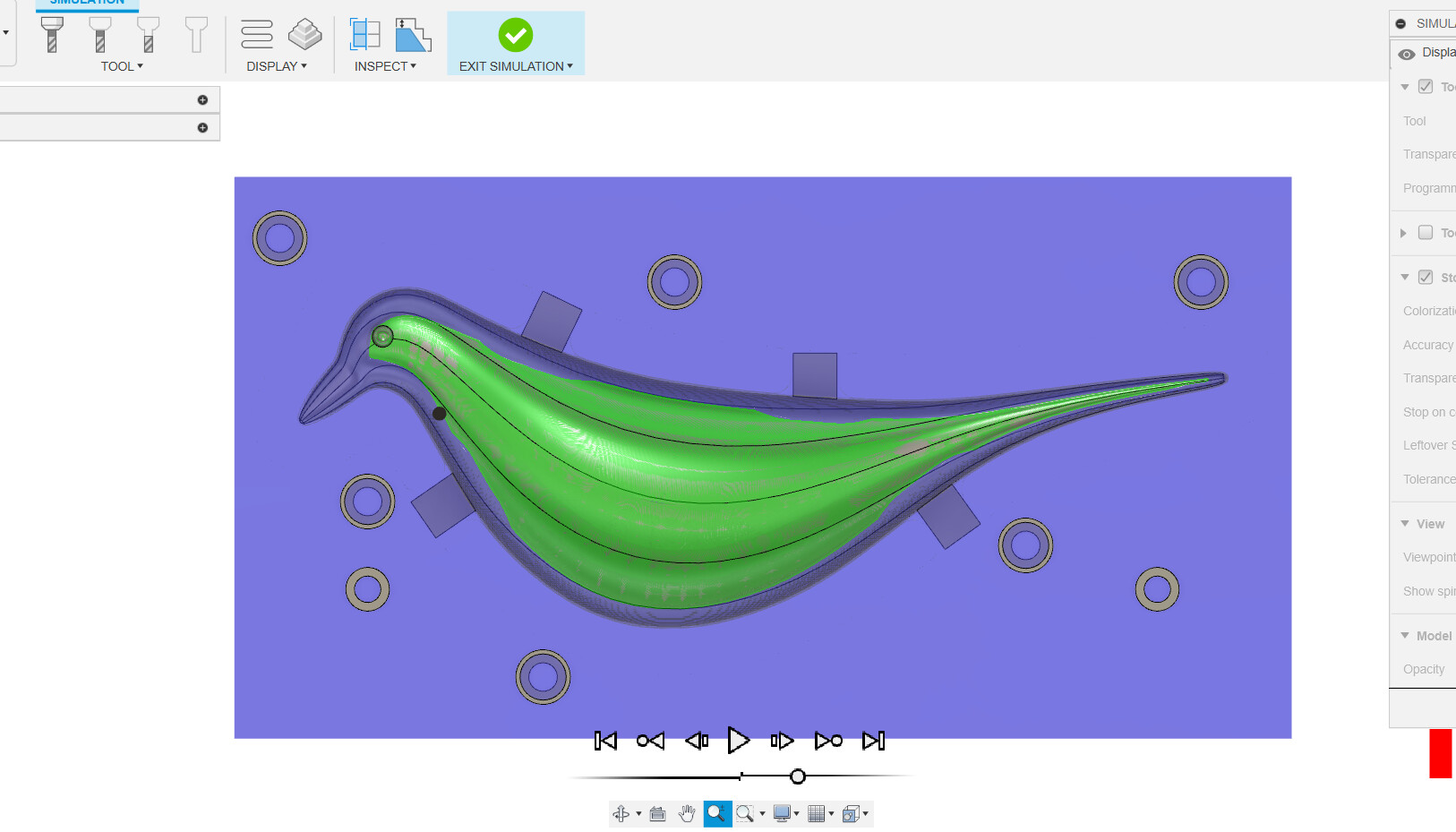

To help you understand, I arrange the body of the feeding heron in the stock like this.
The bottom left corner in the screen shot is always used as the zero point for all three setups. Each of the 3 setups orients the stock to place this corner in a right-angle fixture. I only need to probe once for the inside corner of the fixture to set x and y zero for all 3 setups. Z-zero changes from being either on top of the stock or the bottom. You can see from the next screen shot where I put tabs to fix and suspend the body relative to the stock. The tabs are trimmed and sanded by hand after the carving is complete.

Is the bottom machining done first or last?
Do you cut the tabs with a saw for bird removal?
I finish my tabs by hand as well - I am able to use only four in total - and hope the sanding I do completely eliminates any clue to them being used. I have found that using a very sharp knife to shave the remaining tab as close to the bird as possible is helping, however I am still a bit anxious doing it.
I for each of my sides I use an adaptive clearing with a 2 flute 1/4" flat end mill, followed by a scallop toolpath with a 2 flute 1/8" ball nose endmill that goes just above the tabs. The last tool path is the same scallop but from just above to just below the tabs/bird centre line. I found that when I had just one scallop toolpath, it was referencing the tabs from the very beginning, which caused a much slower carve and the endmill not following the form of the bird as nicely.

I am pleased in how they turned out. I machine the bottom last. For one thing I can cut away part of the stock that is just in the way and don’t need extra tool paths to carve it. There is just a little bit of carving between the legs that doesn’t take long.
I cut the tabs and remaining stock carefully at the bandsaw then use a Dremel to do some initial sanding of the bumps and finally hand sanding. I might be able to get away with fewer tabs, but I haven’t tried.
When I do my scallop finishing tool path, I use the avoid surface option with a .01-inch clearance to not machine the tabs. The tabs are a separate component from the bird model and are not in the setup model. It seems to go around them fine.

I made the tabs part of the model, but may try a new scallop path where I try the avoid surface option. I was thinking of using a rotary tool as well, but was worried I might gouge the body. Thinking about it, it can’t be any more stressful than me trying to avoid slipping with the knife and taking out a slice of the body :smile:

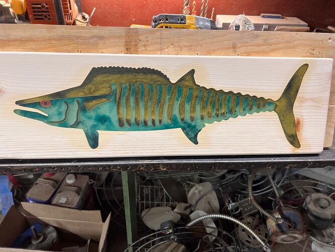

I particularly like the (last) two-tone fish.
I tried a single scallop toolpath with tab surface avoidance, but the simulation shows the same problem I had with the tabs causing a change to the path. Was worth a try. My 2 scallop toolpaths do not really add extra time, as I can post them as one with the free F360 version given the same end mill is used.
