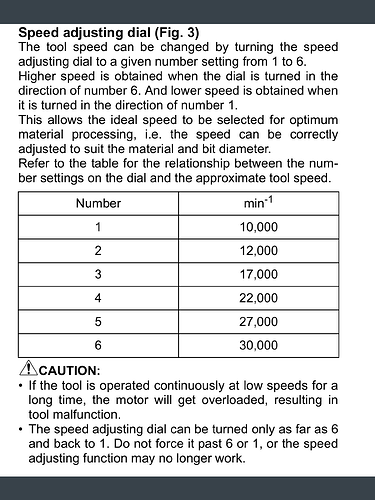

What speed should my spindle (Mikita router) be running? As I noted before, this project has burnt up a brand new bit after only cutting about half of the holes.
Hi Rob - your DOC seems good to me (~0.096”). I usually ran my Makita at 2-3 all the time. Anything over 4 and it would vibrate my workpiece off the machine!
Generally, “burning up the bit” as you say probably means it’s going too fast (RPM) relative to the feed rate. I’ve found 16K RPM great for Cherry and 18K for Hard Maple; walnut doesn’t seem to care too much :wink:.
Now that I have a VFD, I do play around with the RPM to dial it in based on the sound the machine is making. Any high pitched squealing means the RPM is off relative to the feed rate. It’s far easier to change RPM than feed rate mid cut.
General guidance on the Makita:
Hope this helps!
