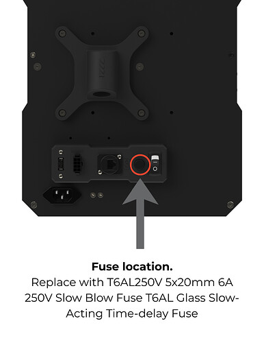

The Redline Screen HMI Fuse Spec is:
10Pcs T6AL250V 5x20mm 6A 250V Slow Blow Fuse T6AL Glass Slow-Acting Time-delay Fuse (3/16 in x 3/4 in)
They are common and can be found on Amazon: Amazon.com
