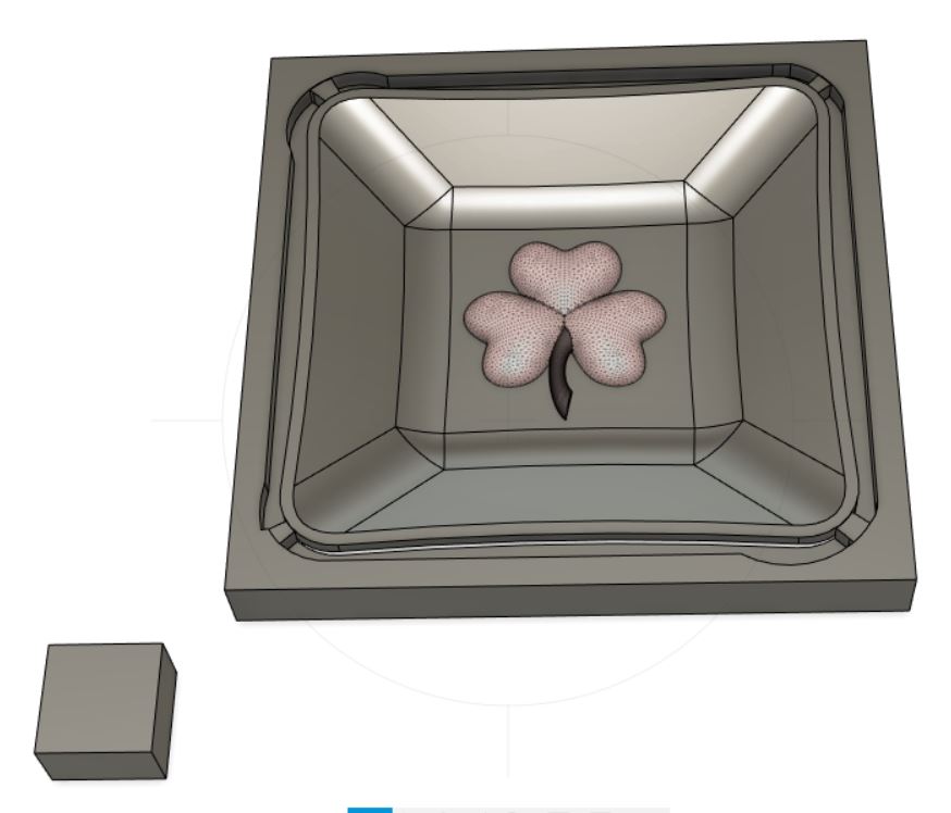

A much better solution would be to screw a separate block that you can zero off of onto the spoilboard. A block that doesn’t get machined. When you create your g-code it’s offset from your work position would be included. The other option is to just not shut off the controller.
Zero is based off of home. With stall homing is very close I don’t think it’s exactness is repeatable enough. You could try something like the “stock to leave” option in 360 so when you stop for the night there’s enough material left so if the new zero is a little bit off there’s enough material left.
Hey Dan,
you are right to bypass the known inaccuracy of stall homing by using the Three-axis Touch Probe, many people do it, e.g. like shown here.
As Alex already mentioned, you could use a block of wood that is permanently fixed somewhere on your workarea, but away from your work, where you can put the probe on, or you could also use a jig for the same purpose, like shown here.
