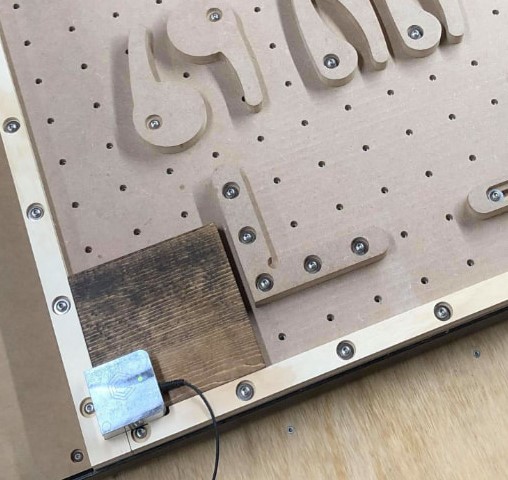

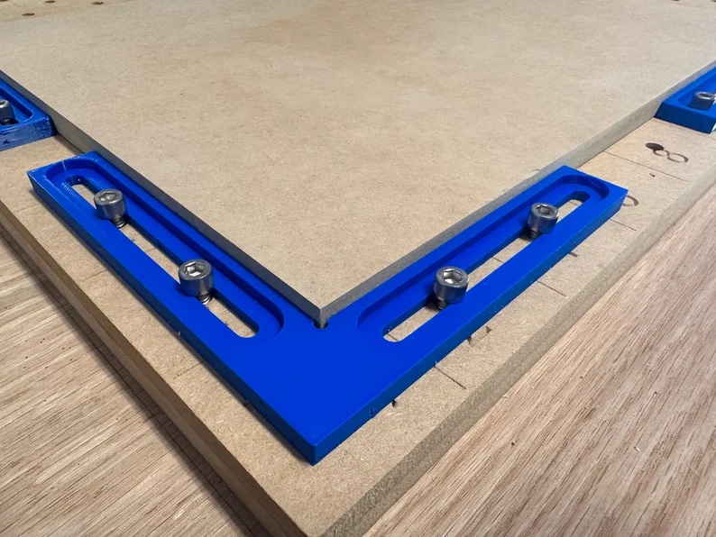

If you use a corner fixture like one of these. You can create a starting spot that you will only need to zero x and y one time then all the following pieces will only need to be z zeroed. This keeps two sides perfectly square every time and you only need to apply side pressure on two sides to hold a piece of material in place. This has been my go to setup for turning out lots of different projects in one day.
