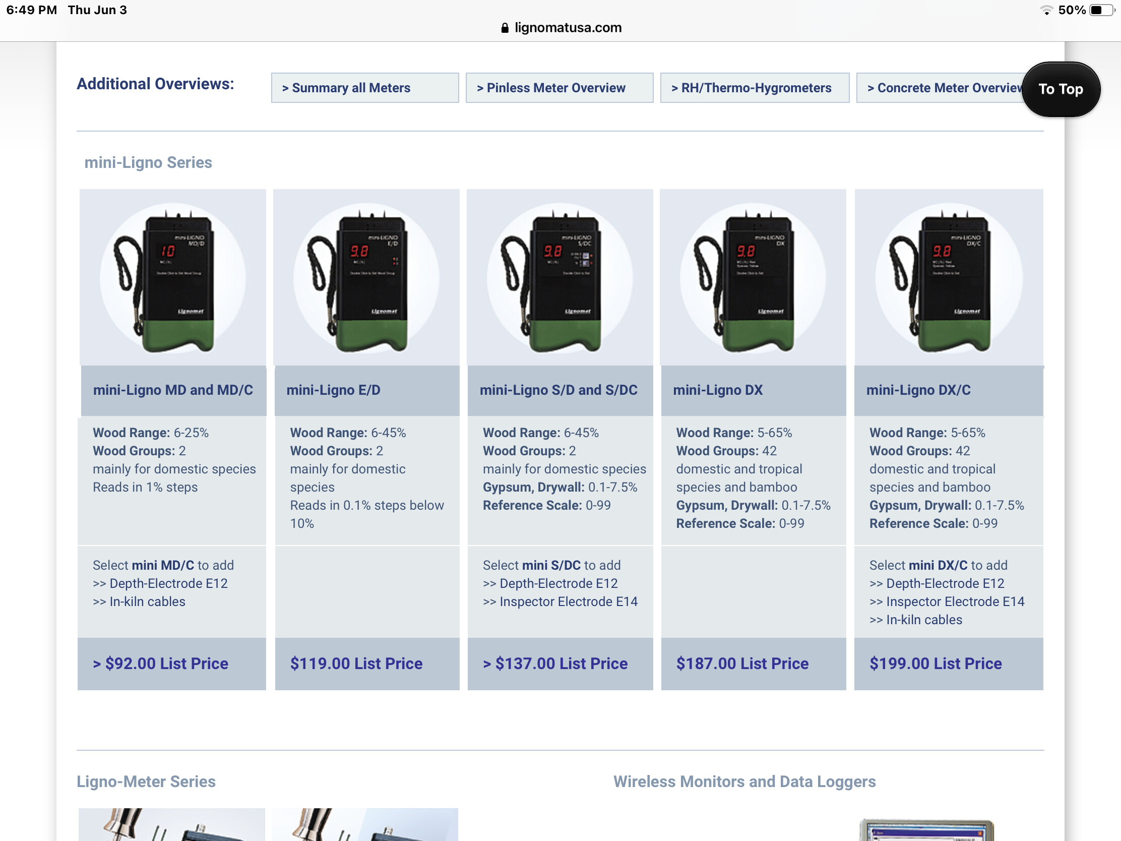

What is the thickness of the material and the size of your project typically? Do you have a moisture meter?
Here is a few options. I use the DX and find it very repeatable when you rough cut your material to size program the meter for the species of lumber and push it into the end grain in the middle of the board. Your goal is to be at 6 to 8%mc for furniture up to 12% mc for single board projects . When you achieve this, cut your project and seal it on all 6 surfaces.
