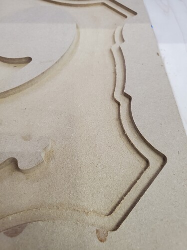

Tram or witness marks?
Again, new and just messing around.
Waiting for hardware to build spoilboard. I haven’t even trammed yet.
Just curious, are these marks because I need to Tram? Or are they “witness” marks?
Obviously not the big marks.
Pictures really don’t show them. My bad.
General rule of thumb - if you can feel the ridges with your fingernail, you need to tram. If not, then no big deal.
