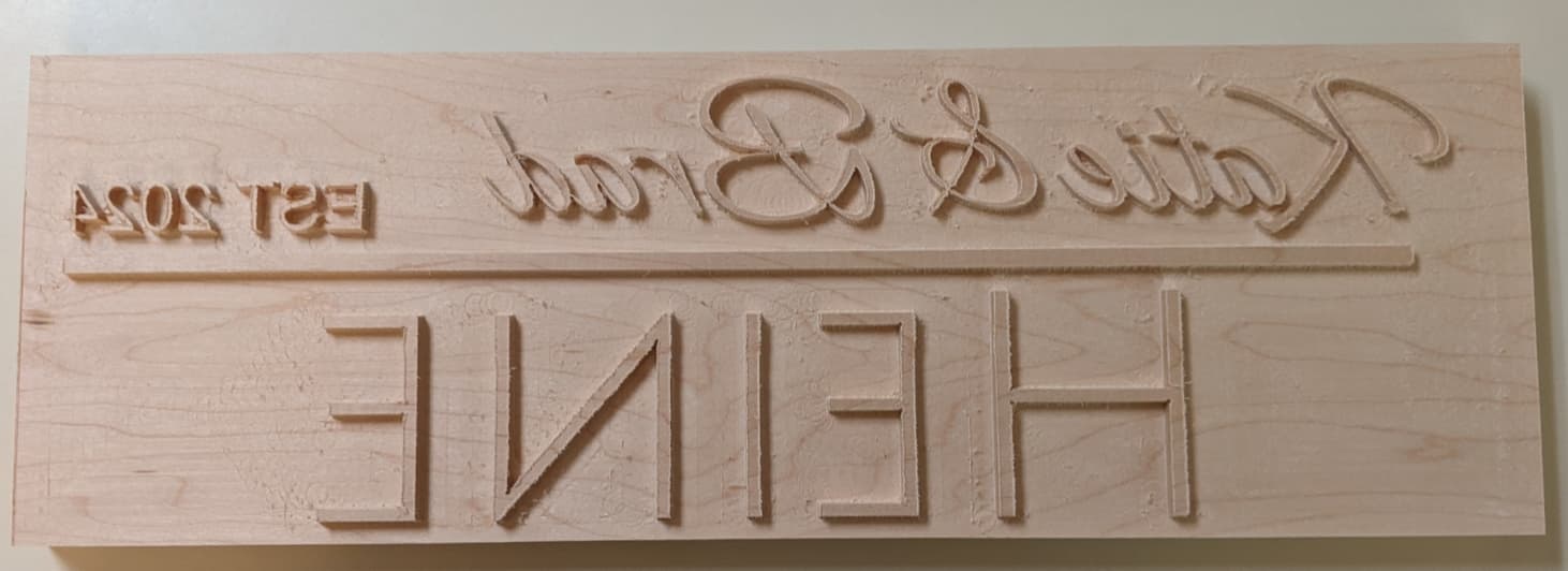

Male:

Both the male & female carves went well. Using the taper bit VCarve actually stepped down in Z, not taking the entire depth in one pass … a good thing.
There were lot’s of artifacts left behind after the carve … these little slivers had to be knocked out with a dental pick. (about 1 hr. for both male & female clean up)
I messed up somewhere and did not re-sync the female and male sides after a geometry tweak … so male and female pieces did not fit together.
