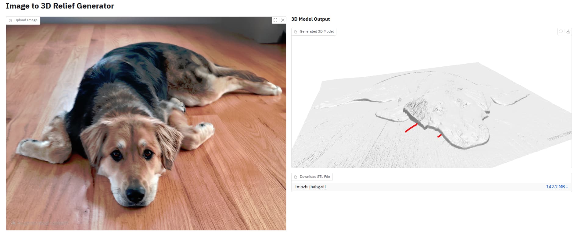

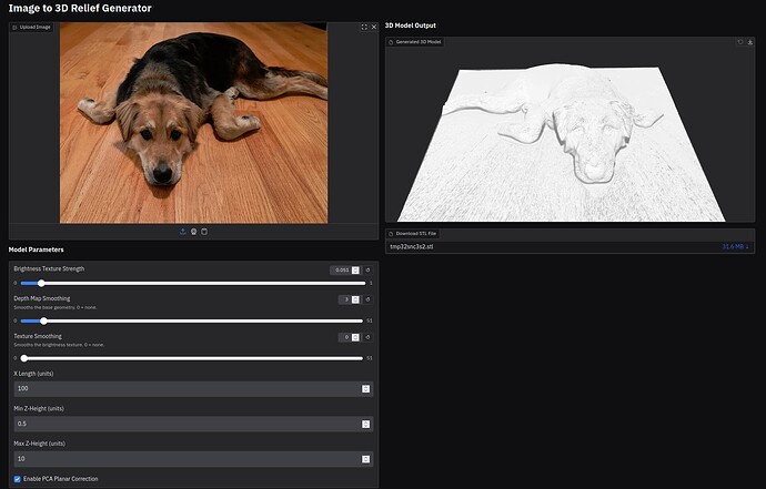

Good evening project. Monocular depth estimation + brightness and some filtering. You can use it for free here.
I’m playing around with this. Very nice. Do you know if there a way to smooth the edges out?
Could you describe what you mean by smoothing the edges out?
Hi, Yes here is a picture. Talking about the edges where I have the red lines. Also it seems like its flipping the image when it does the relief.

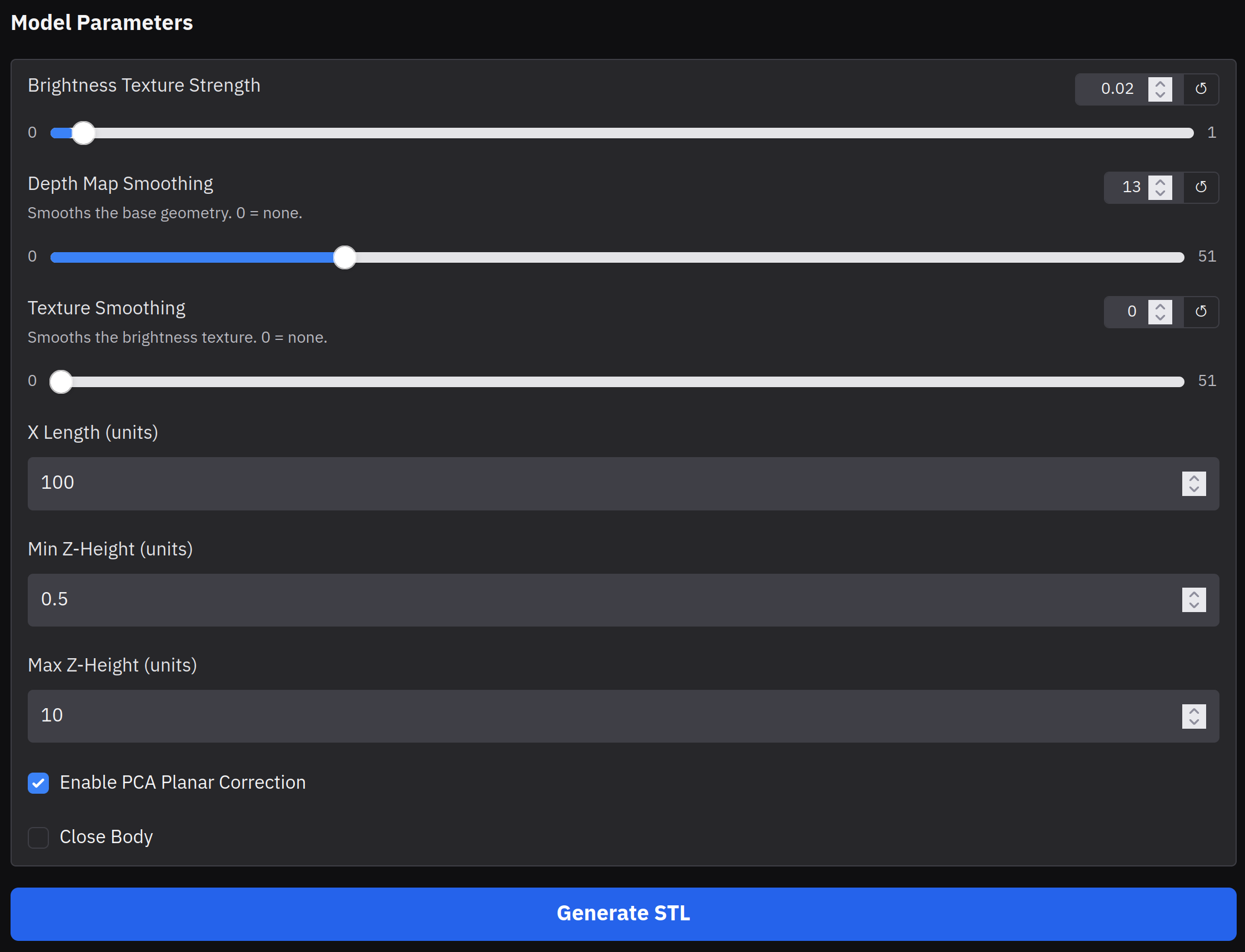

I think you’re referring to the “pixelated” look that you can see in some of the sharp transitions. Try increasing the depth map smoothing slider. I got a result that looks like this with these parameters.
This will also be affected by the resolution of your image.
The image flipping is, I believe, an artifact of the embedded 3D viewer. When I viewed the downloaded STL, it matched the image orientation. Worst-case scenario, you could always flip the image.
