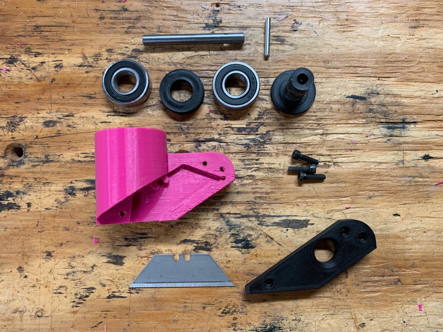

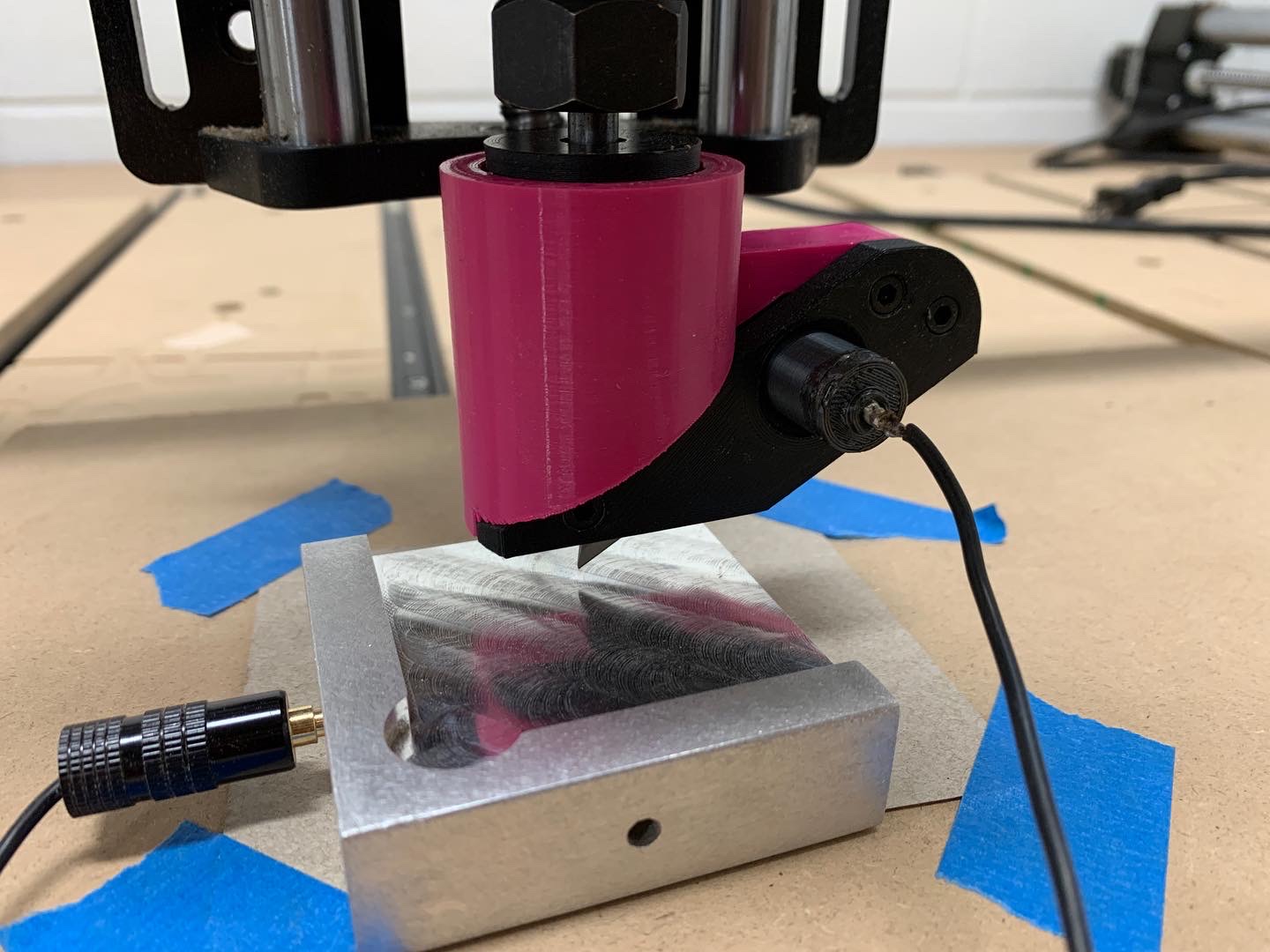

My first go at a drag knife. I have to work on cutting paths and other details, but it seems to work well enough. I’m able to use the touch probe and standard utility knife blades. There isn’t much room below or in front of the Z carriage, so I may modify this to use a smaller blade so it won’t crash. For the time being, I’ll ensure the clearance, retract, and feed heights are well below. I’m using Fusion 360 and am considering purchasing an extension to modify the gcode to include the offset loops that Aspire and others do.
I thought to share. Please drop tips and learnings from your drag knife journey.

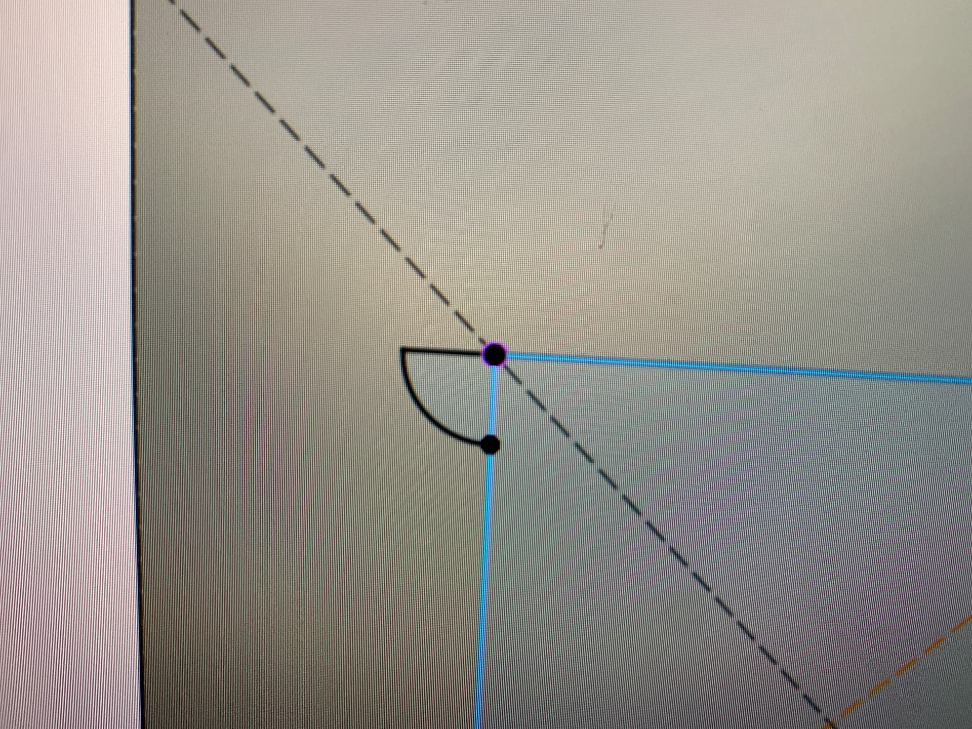

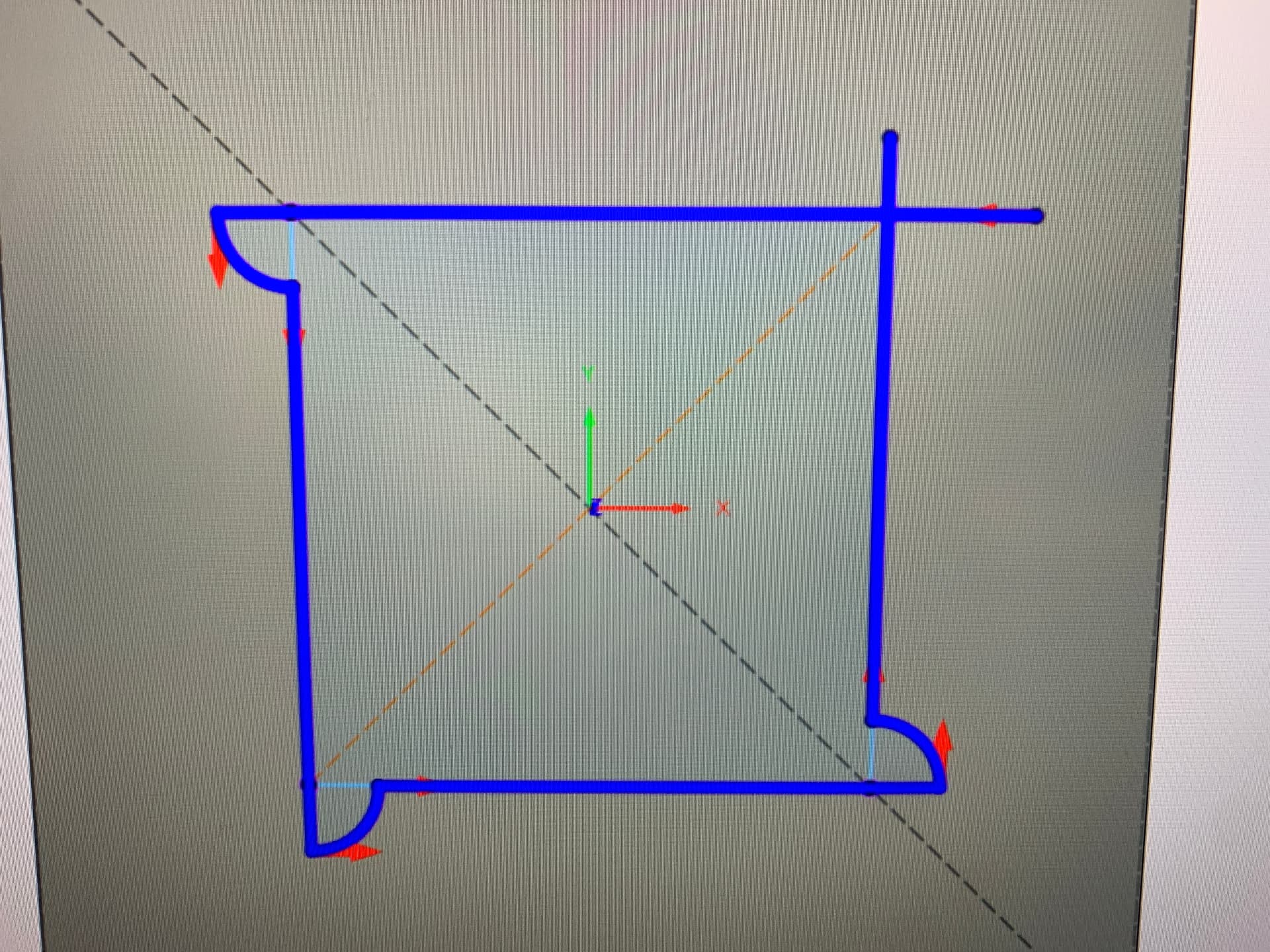

These are the offset loops I mentioned above. This is what a square looks like for a knife with a .125” offset. I hope it makes sense.

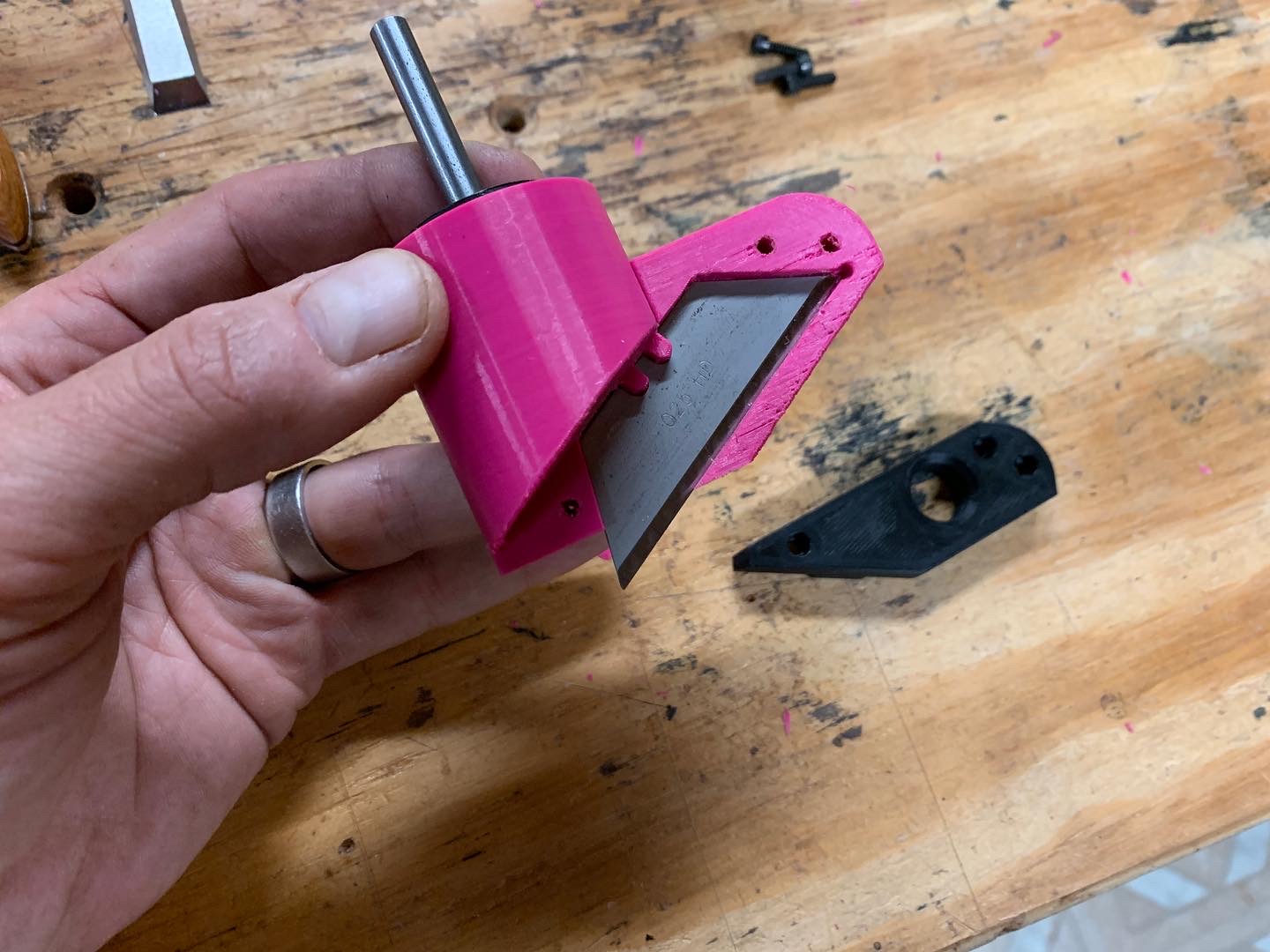

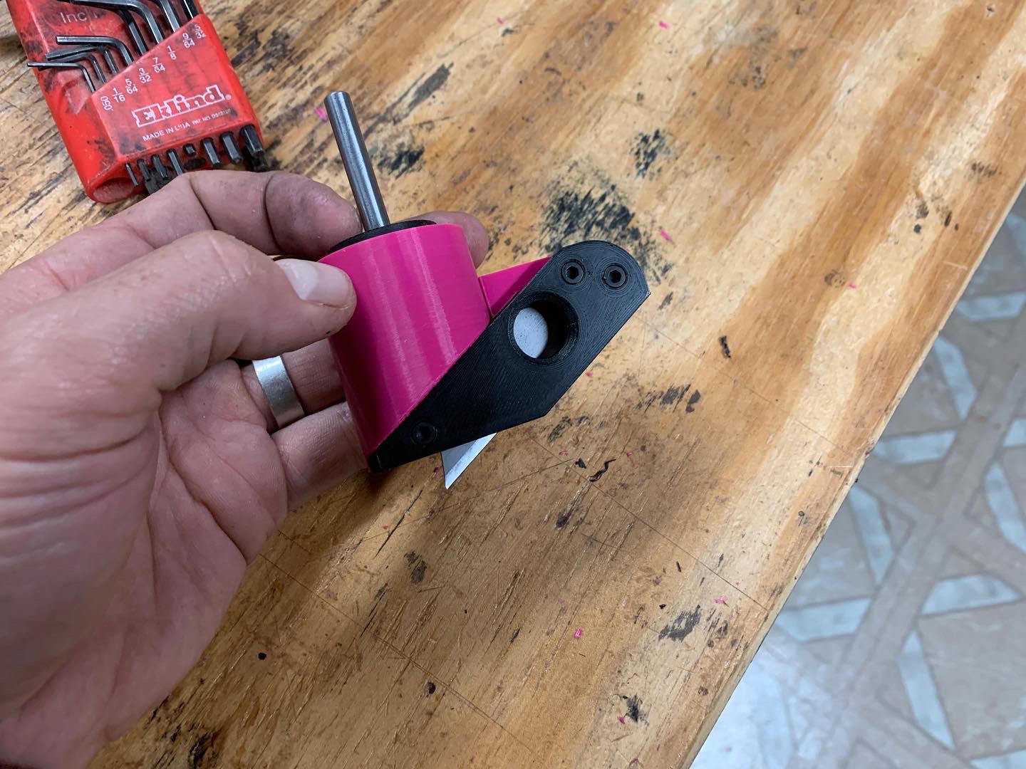

Version two complete. It now clears the z carriage and no worries about crashing. My only rub is I have to cut the blades in half but it’s no big deal.
Oh and I purchased and downloaded a drag knife extension for Fusion 360 and it’s amazing. Well worth it.

Hey excited try this with our school CNC, can you tell me a few things? What size length is your shaft, is it standard, where’d you source it? are you using M3 nuts and screws or…? bearing size? I tried to reverse from your Fusion file measurements but I’m new to this so thanks for any info. The 3d printed parts worked great!
@jiff182 I used a 1/2" diameter shaft (2.5" long), and the bearings have a 1/2" ID and 1.125" OD. Link below. The shaft has a hole for a pin drilled in it but I’m not sure it is completely necessary.
The CAD calls for 6-32 Thread Size, 1/2" Long. Here is where you can get them. I usually pick them up at my local hardware store.
Hit me up if you have any other questions. Good luck!
