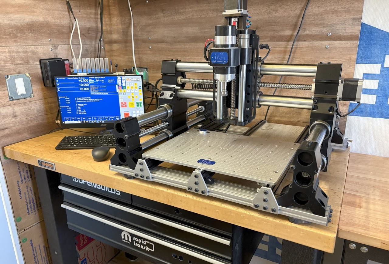

Sorry to hijack, I just noticed your profile picture Bill, and that looks like you have some shields blocking your Y rails from your cut area? How effective has that been for you?
Kyle, it’s been very effective so far, and much easier to work with than my previous setup. It was just sort of dumb-luck that they quite literally fell into place the way they did. I only had to add a couple small brackets to the wood backstop piece to hold the 1/4" vinyl plank flooring pieces into place. The were just a couple scrap pieces I had left over from doing the floor in my shop. Was very recently thinking that I might make them a couple inches taller to better shield the screws & upper Y rails.
(Note that dust collector mount portion of steel Z axis support plates have been removed.)

reviving an old post, walk me through your extrusions you have there. I have a similar setup but I am curious what you went with.
@Calvin That was my previous machine. My new machine has a very similar setup, but not exactly the same.
On the one in the pic above, my front & rear extrusions were 40x60, while the front-to-back extrusions are 20x80. Somewhere in probably an older thread, I’ve got much more detailed pics of how it was put together.
My new(er) machine uses 20x60 extrusions front & rear, and 20x40 extrusions front-to-back. Overall, I like my new frame better. Both were good, but the new one is just a cleaner, better designed build.
Very cool setup. I have 8080 running front to back under the Y rails and then 4080 side to side joining them. I went a bit bigger then you since I have the foreman I was worried about rigidity.
