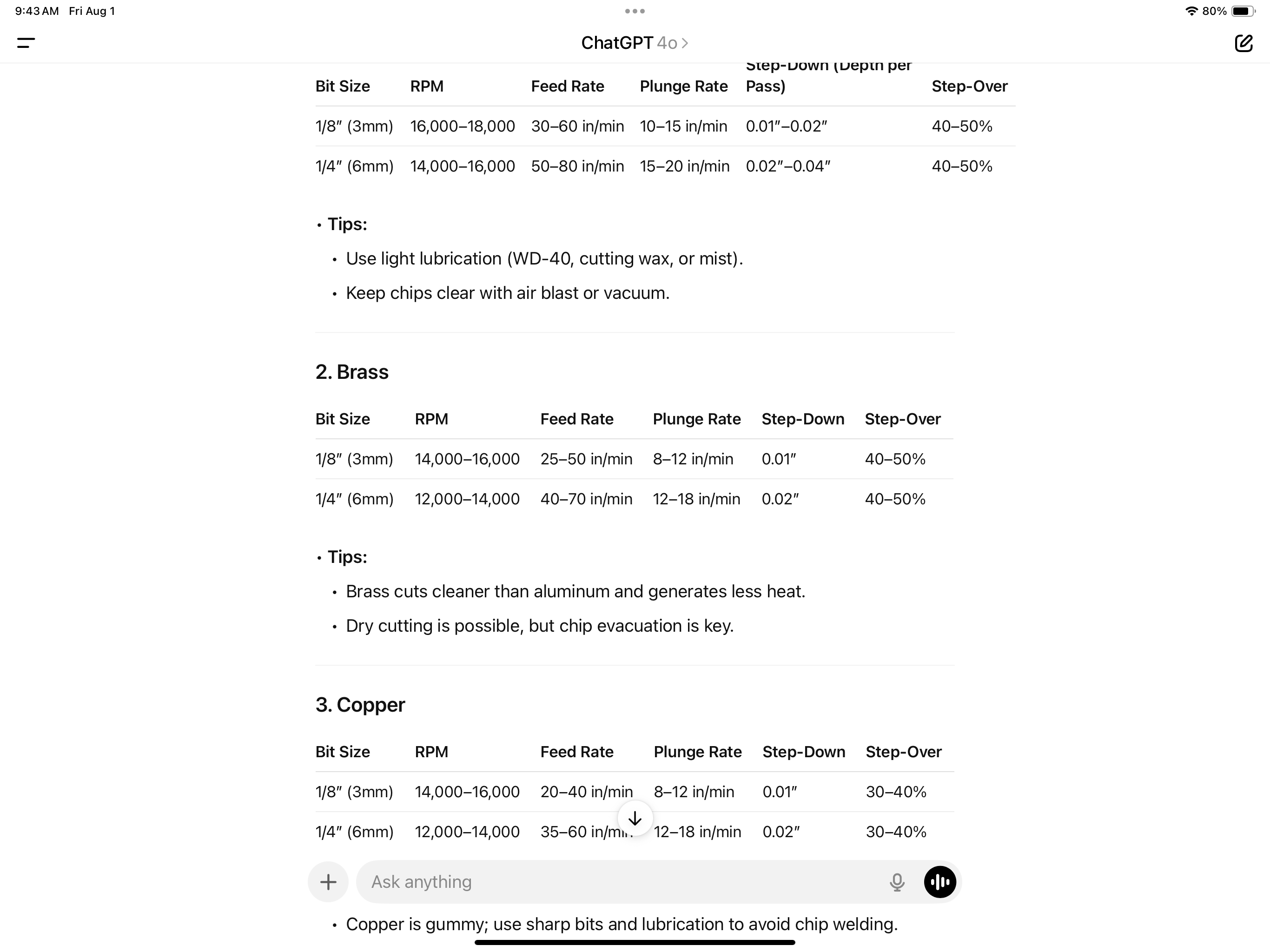

Hi I am investigating the feasibility of cutting soft metals. I offer you this from ChatGPT.

Here’s a recommended feed, speed, and step-down chart for cutting metals on your OneFinity CNC with either the Makita router or a 1.5–2.2 kW spindle.
These values assume 1/8” (3.175 mm) or 1/4” (6.35 mm) carbide end mills, single or 2-flute, and proper clamping.
