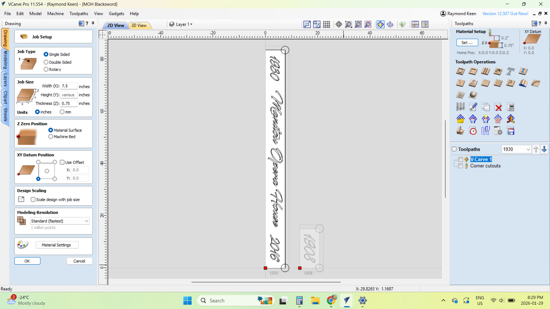

Change x,y origin when Tiling toolpaths
Can I change my X,Y origin away from 0,0 when tiling a v carve project?

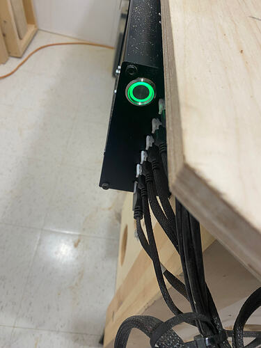

My control box is in the way for long material along Y at X,0. I would like to feed thru along Y, but at X,20.
I keep getting the message, “Toolpath Tiling can only be used on jobs with the X,Y origin set to the bottom left corner”.

Hi Jim,
This screen shot will TILE as no XY Datum Position has been set, and the project sits at 0,0 on the 1F Spoil Board.
The next screen shot with a XY Datum Position of X20, Y0, will not TILE and creates the error message.
Are we on the same page?
As we talked about earlier, I could position my project on the 1F Spoil Board (without an XY Datum Position) and then use the XYZ Probe to set the physical position of the project on the Spoil Board. Is this the workaround? Will this setup TILE?
Thanks again,
Ray
Leave the origin at the bottom left 0,0 in VCarve like it wants you to. Put your workpiece wherever you need to, it sounds like that’s X>=20. Then, either probe or manually zero your machine at the bottom left corner of your workpiece. That’s all you have to do. Every tiling operation will start from that same zero position as long as you don’t lose the zero by restarting/rehoming the machine (not sure what controller you’re using). Between operations, you just need to make sure that you’re shifting your workpiece by the right distance and keeping it parallel to the Y axis.

No. What we’re trying to do is tell the machine where the project thinks 0,0 is. So in VCarve your datum is 0,0 but on the machine you move it to X20,Y0 and then hit the Zero All (or zero each axis and you’ll need to set Z zero separately) or use the probe to zero all.
Now when the software says to the machine, go to 0,0 it will go to machine 20,0. As far as the software is concerned, that’s 0,0 - it doesn’t know anything about any space to the left. (Technically, you could go to X-20 and it would move to the left because there’s enough room on the machine’s plane to do that, but X-30 would throw an error because that would be a machine coordinate of X-10 and the X can’t be negative for the machine.) In G-code terms you’re setting a Work Coordinate System (WCS) variable that the controller will then use to translate movement commands to map to physical machine locations.
