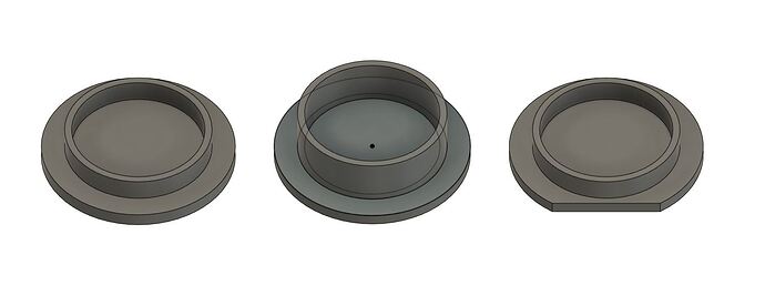

Could you share the file for those who can 3d print them? Better than several I have seen.

@Dustydave - I posted mine on Thingiverse if you are interested - I can print some for you if you want; though they might not be as ‘sexy’ as @rockytoptim’s :wink:

I just posted the 3D printer file on thingiverse. I only used supports on the bottom of the circle. I did have to do some light sanding on the bottom of the circle where the supports were to get it to fit into the mating onefinity hole. I have only printed these in ASA so adjustments may need to be made if printed in another material.
https://www.thingiverse.com/thing:4886321

How about those end caps? I see one file for one of the holes on another model but they’re different sizes aren’t they?
I can post file on thingiverse for the caps tha go into the x and y rails. There is actual three types. The ones on the y rails where the stepper motors are have a clipped circle to clear the stepper motor.
Here is the link to the end cap files on Thingiverse. There are 3 files. The one with the clipped bottom goes on the y rails where the stepper motors are at the rear of the machine.
(Onefinity End Caps by rockytoptim - Thingiverse)
