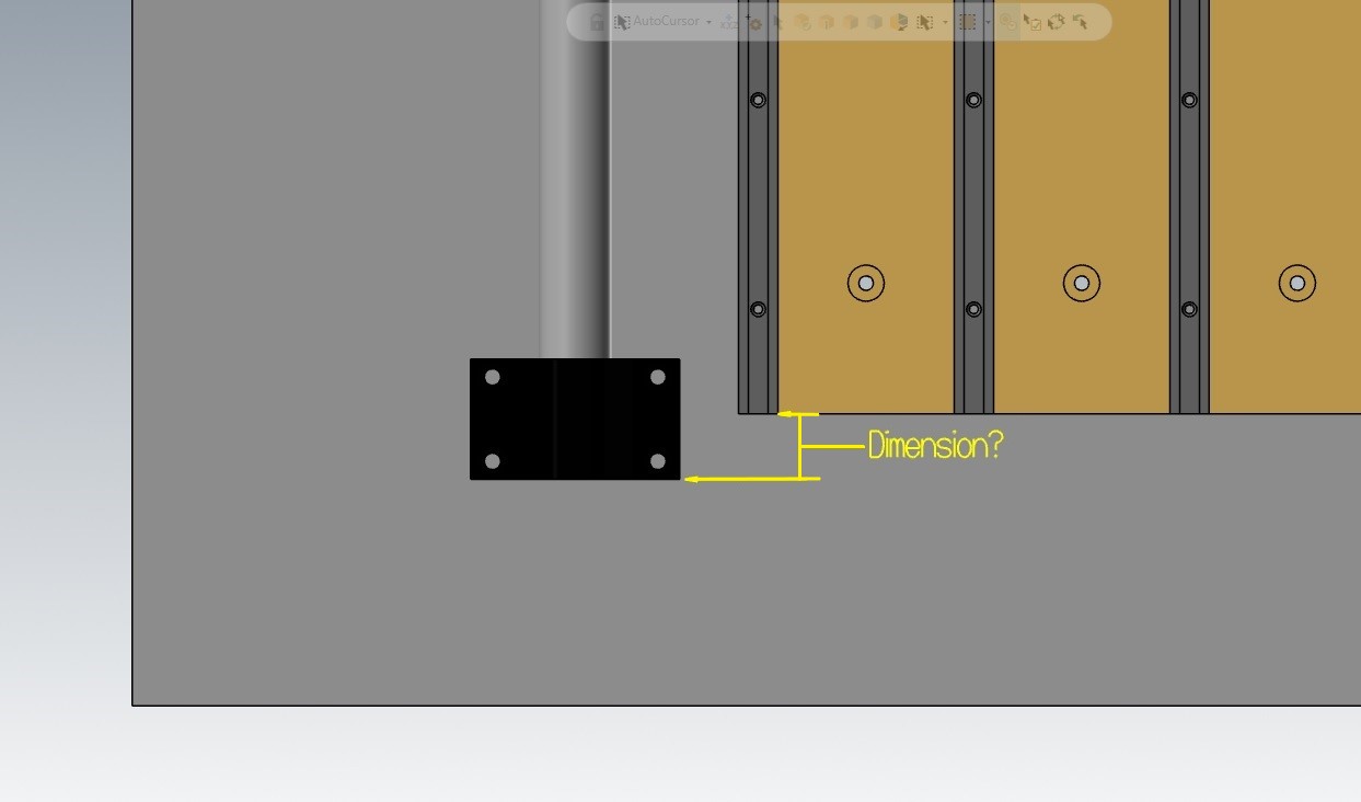

Can anyone get me a dimension from the front left foot mount to the corner of the waste board?
@Techrise I got 1 29/32"
Thanks @rockytoptim. I was actually for the Y dimension. Sorry, my picture is a little deceiving.
Sorry for the wrong measurements. I remeasured and got 1 1/4"
Awesome @rockytoptim! I am designing my table with an removable insert and needed to find the location of the cutting envelope. Thank you.

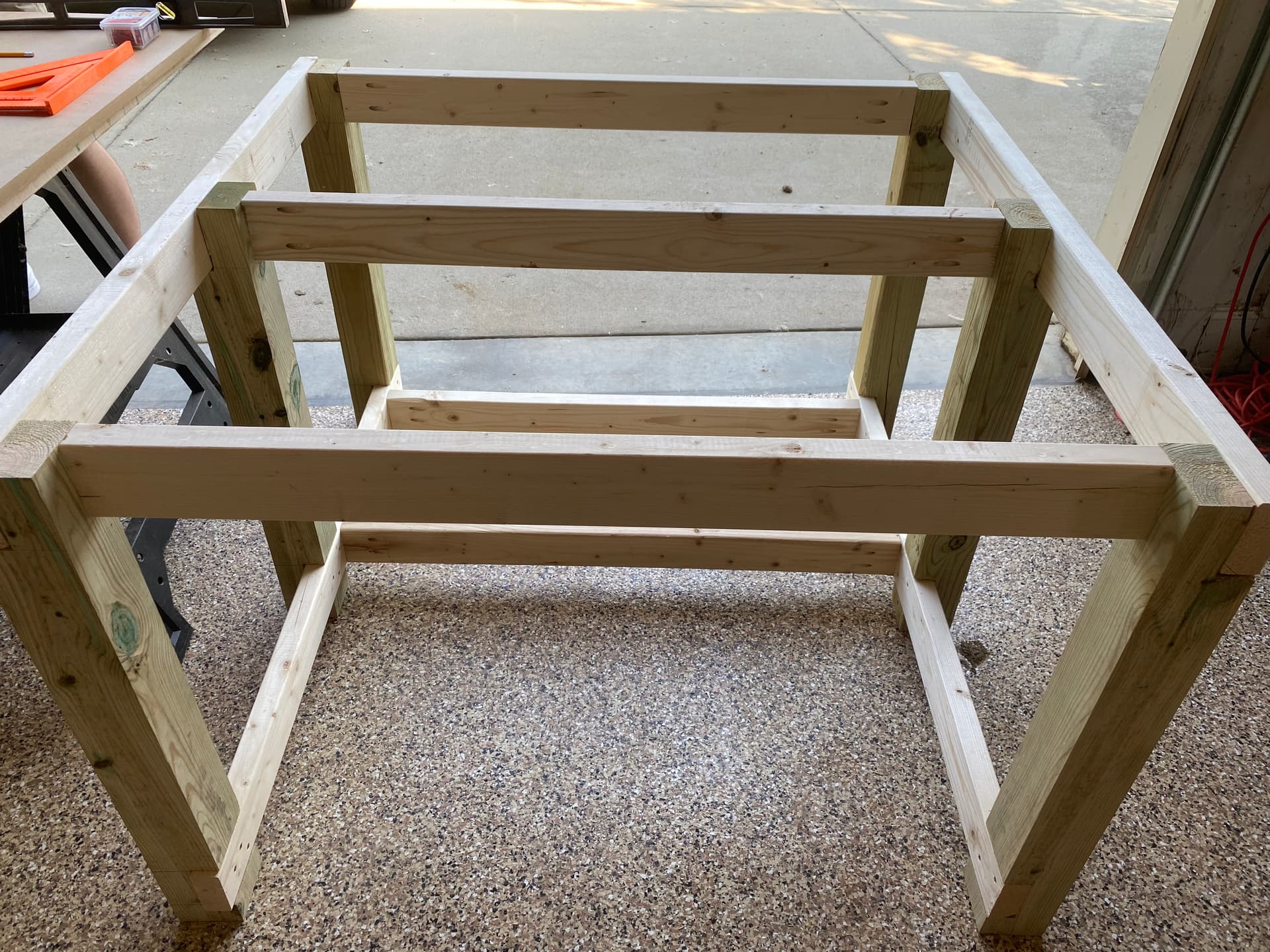

My order won’t be here until mid-September, but I have my son home from college right now, so I’m taking advantage of the help in building the table and moving things around in my workspace.
My plan is 4x4x30 legs (3 on each side), 2x4 framing (flush with top and 3-4" up from bottom on which I’ll place a shelf - likely 3/4" plywood), 48x48x3/4 MDF top (doubled up, so really 1 1/2" thick) and then 3/4" MDF spoil board which I’ll do when the machine arrives so I have exact measurements and can use it to drill out the t-nut holes every 4" in all directions.
I’m not planning to move it around, so I likely won’t get casters.
Anyone see any issues that should be addressed with the above plan? Will this be rigid enough? Should I add another 4x4 to the middle of the back? I want to leave the front wide open for access to anything underneath. Any suggestions will be greatly appreciated.
Ok, so I got the table put together today. Still need to attach the 2nd MDF board and bottom shelf (only the back half, similar to Brudaddy’s build).
Very anxious for the 1F to arrive, but I’m studying, reading this forum, and getting done what I can so I can hit the ground running.
Used the dado stack for the joints and connected cross pieces with pocket joints. Very excited it is all level on my garage floor in its own corner. The top is 48"x48", 4x4’s are 32" tall. Neglected to take a picture of the cross pieces, but you can sort of see it in one of the pics - the trashy looking 2x4.
