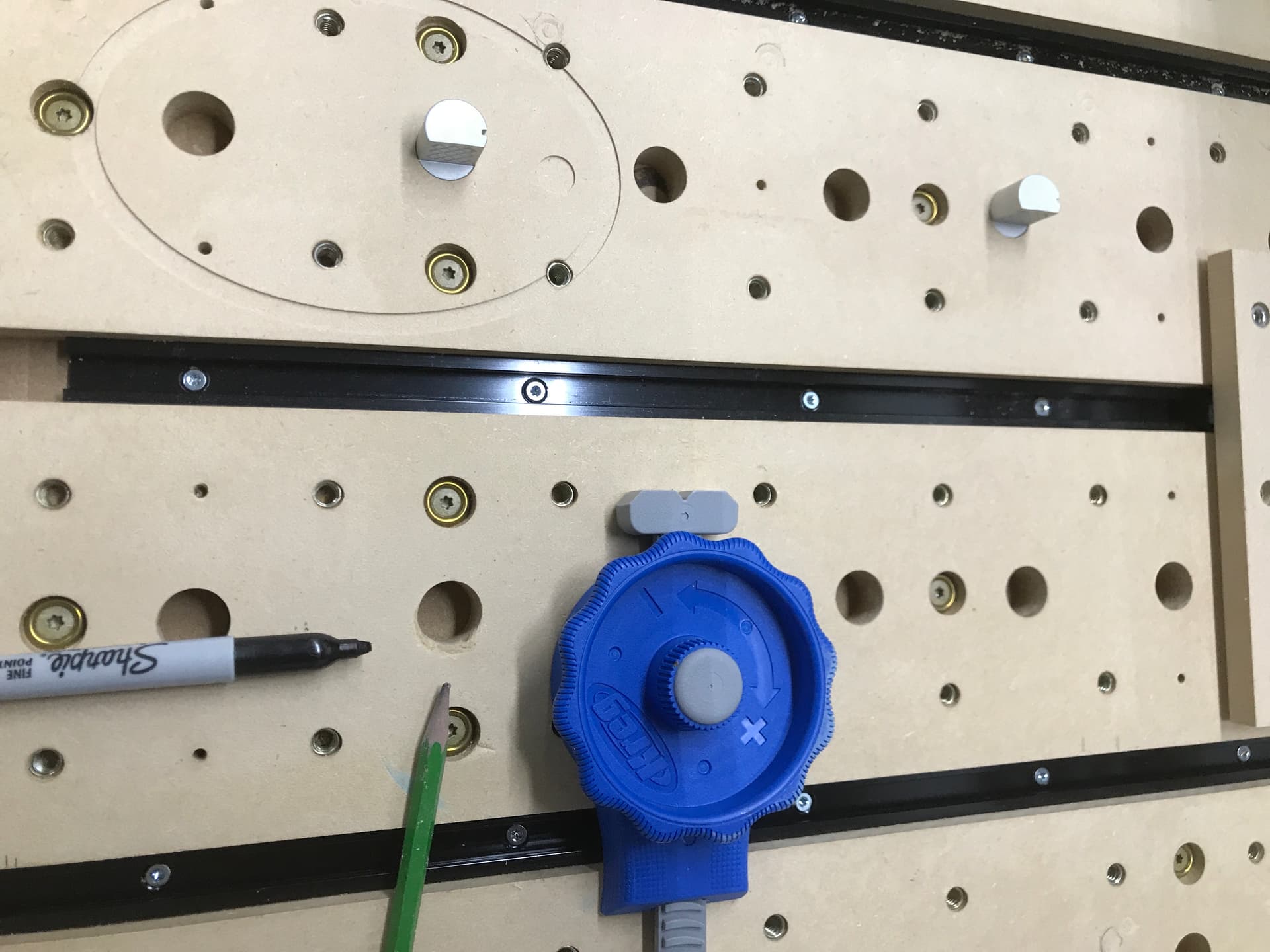

Regarding dog holes, a guy at our Makerspace added some schedule 80 PVC blind holes and short pieces of PVC for locating holes in our makerspace CNC. Naturally, cheap AND will not trash bits that plow into them!
I have this on my table setup and it works great.
I am using 1/2" SCH 40.

Thanks so much, I used mdf for my spoil board and find that the dog holes are becoming mis shappened from clamping against them.
I was wondering if your dog holes are 3/4” deep or did you cut into the table top aswell
Hi David,
I did not do it (on my own machine, yet), it was someone in our Makerspace that did it to our community machine. FWIW, he used 1" pipe, and I’m quite sure he said it was schedule 80. It went into only the spoilboard, also MDF.
The larger diameter and wall thickness seems to have stood the test of time…
See attached.
If you get your tolerance right, you can use them as the center point for your cam clamps as well.

Thank you so much for the follow up. As I look at you set up,I think I too much clamping pressure. I have dog holes as well but the 3/4” mdf does not support enough . The dog is pushing up and they hole is becoming out of round. I was wondering if folks were drilling into the table as well, so the dog would be 1-1/2” into the hole for more support.
In my opinion you need to keep the hole tight very tight. I use an awl and the hole thru the dog to twist them in and out. I am using lightweight MDF so it is weaker than what you are using but i haven’t had any issue.
Mine is light weight as well, so I think when I redo my wasteboard I will use the standard mdf possibly 1” and also bore into the table at the same time. I have yet to use my t track for hold down. So I must be missing something , it just is never in the right place. I also think the next waste board will have varied spacing between the track if I add it again…
