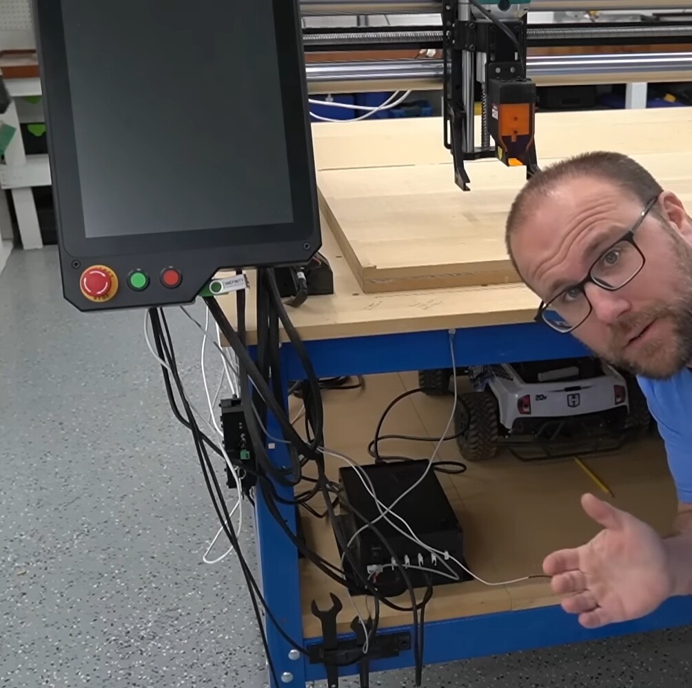

Hi. Do you know if it is possible to relocate the controller so that it would be outside an enclosure for an Elite Journeyman? And if so, are the cables already long enough? Thanks.
I am hoping there are either extention cable options or the cables are already long enough to do this. I plan on moving my controller to the side.
I guess we will find out once it arrives.
There was mention of this in the first look video, from the setup it looks like there is not much extra cable but it is a pre production model.
From this shot it looks like the cables from the power supply to the controller are decent. The way my setup is planned these will be pretty close together. I have high hopes this will work for me if production models are close to this cable length.

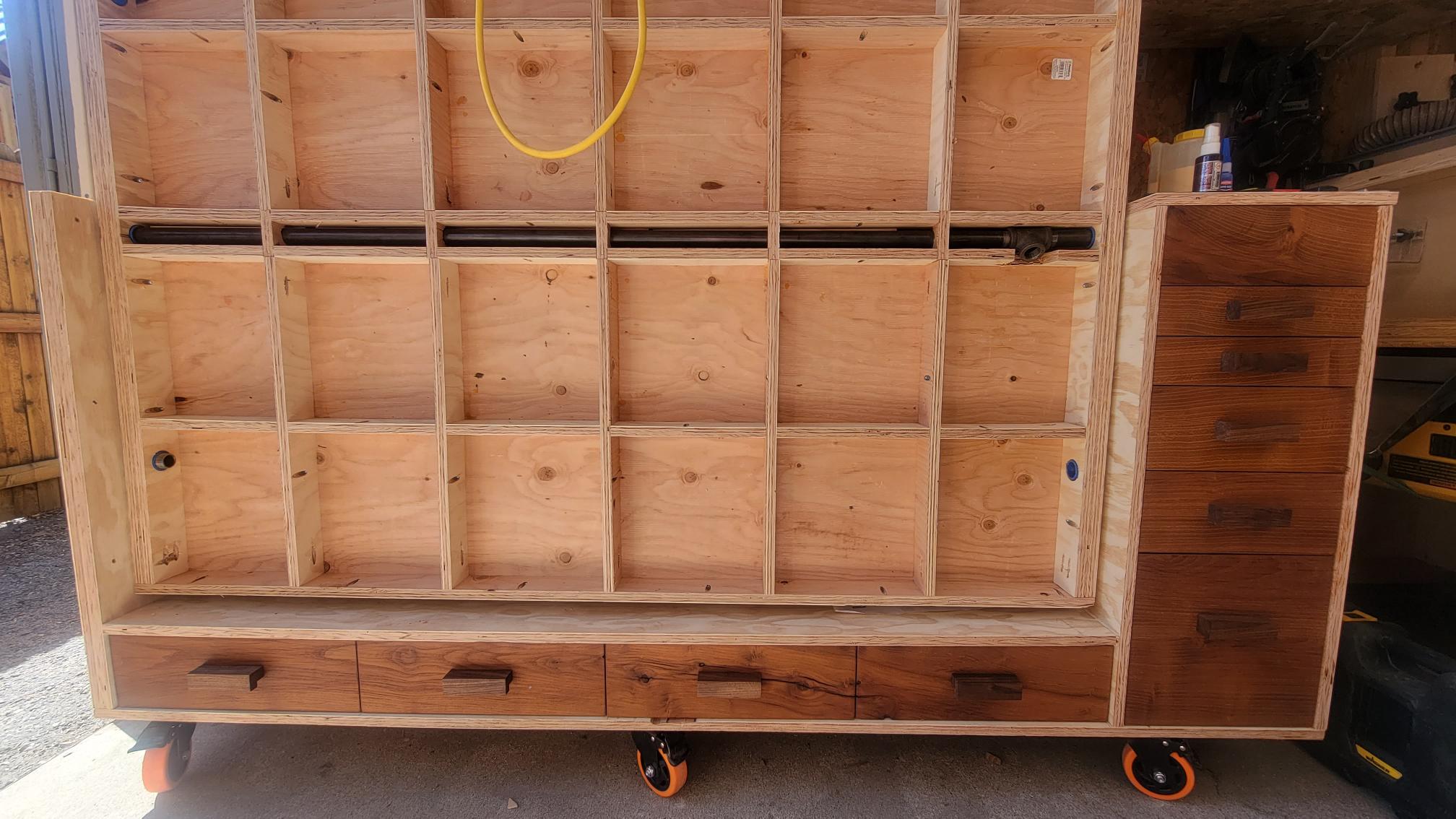

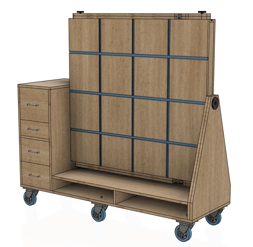

@RockingMallet are you going to be selling the plans when they are complete? I will hopefully be purchasing my elite table soon and would love to build your table for mine. Working in a two car garage is tight and that would be handy.
@forrestkrhoads i have no intension of selling the plans, even though they are custom for my needs, my plans were heavily based on a couple other plans around, but mainly from fishers shop
i purchased Drew’s plans when i started, but then modified a majority of it to what i wanted. they are good plans and easy to follow and i believe are only 10 bucks which is reasonable for a well put together how-to as well as a good video.
i changed the side of the cabinet, the number/construction of the drawers, the pivot location and no table legs with a different way of locking the table into position - no legs needed (at least until i see how she performs with the cnc running… TBD on those) i also made it deeper. and added 4 drawers to the bottom.
i really like the offset i did on the pivot point which allows for 2 ‘upgrades’ to Drews plans.
  1. as i mentioned doesn’t require legs - but will see if that is true when i start using it and see how stable it really is. but i really like the ability to lock in the table without legs and have been using it as a worktable until the 1F gets here.
  2. it offsets the pivot point and builds in protection to the gantry when in the vertical/store position - this was the main reason for offsetting
the thing is i don’t know if the size it correct yet, i think it will be, but will be close. if you do plan on using Drews i would make the flip table more like 66+ inches.
here is an updated photo with the drawers. still waiting on the cnc to arrive before putting on the bottom side.
good luck with yours

How deep is the base? This is what will be crucial for the stability when the machine moves (especially when also using a heavy spindle). I would have assumed that for getting rid of the foldable legs (which I would consider as an advantage since you will get rid of twisting because of uneven ground), you would need a much deeper base.
you and me both!
i was going to make it 30" but ended up backing it back to 24". i believe Drew had his plans at 22" - so not much but figured a couple extra inches would add the weight, give me a bit more storage in my drawers and provide additional protection to the gantry/spindle when folder/stored.
i have tried tipping it over when its locked in and put a couple hundred pounds of wood on the edge and it didn’t budge, so hoping for the best. I more worried about it just rocking than tipping, but the base is a beast.
and thanks. i am happy how it has turned out. as long as the thing fits on the table!
