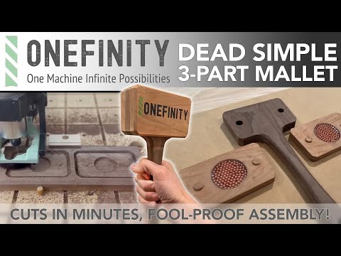

If you work with wood, you probably use a joiners mallet. Most woodworkers make their own, and there are a million different designs out there, so here’s our take on it. This mallet is made of just 3 parts that can be cut out on your CNC in just a few minutes.
If you want to brand your mallet, or personalize it for someone else, this video will explain how to do that with this design. Assembly is even easier - the three parts nest together to keep them properly aligned while gluing them together. Simple, elegant, and effective!
Free Vcarve files with pre-programmed toolpaths are available on the Onefinity user forum HERE, as well as DXF and SVG vectors for non-Vcarve users.

Quick question. I didn’t see any vectors for the alignment pins or weight cavities for the toolpath files in for the mallet sides. There are only vectors for the engravings and, of course, the profile. Am I missing something, or do we need to import the .dxf file to complete that portion of the project?
I am with you on this. Wondering if it missing.

Does anyone have the toolpaths please for the handle as they are missing in the download. The sides are present in the download just missing the handle toolpaths. Thank you

It’s this file, just filled with leds instead of bb’s.
