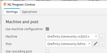

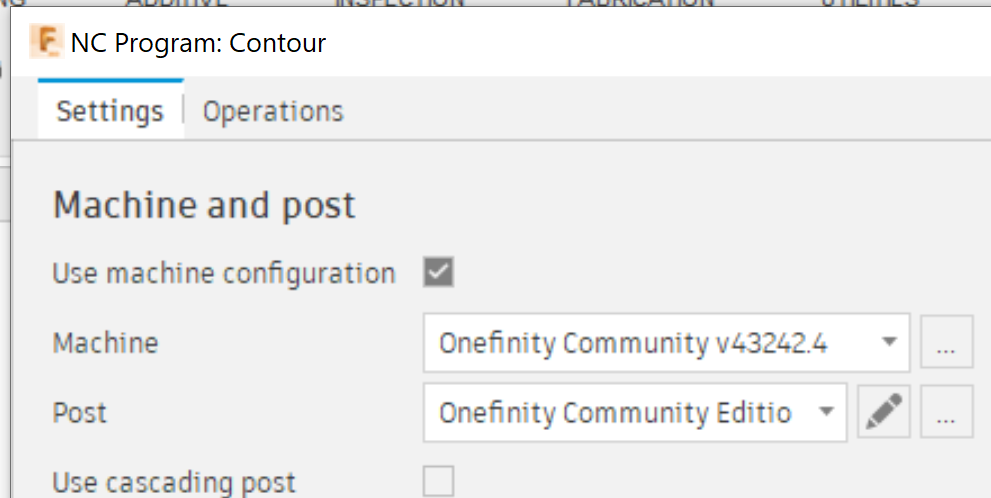

To edit, click the pencil from your NC Program config,
In the post processor code you will find something like,
function onClose() {
  setCoolant(COOLANT_OFF);
  writeRetract(Z);
  setWorkPlane(new Vector(0, 0, 0)); // reset working plane
  writeRetract(X, Y);
  onImpliedCommand(COMMAND_END);
  onImpliedCommand(COMMAND_STOP_SPINDLE);
  writeBlock(mFormat.format(30)); // stop program, spindle stop, coolant off
  writeln("%");
The line you want to change is this one,

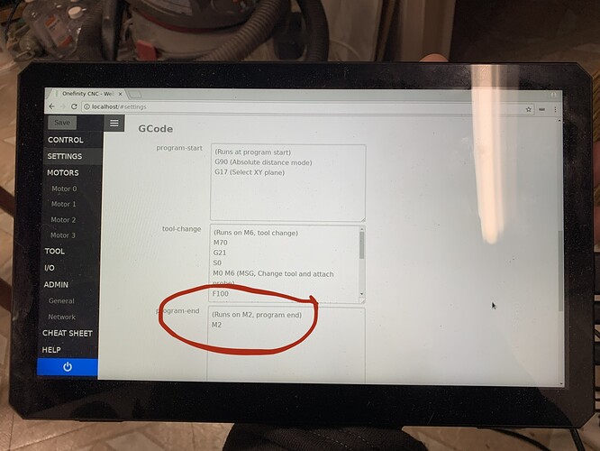

Thank you. I looked in the controller settings and it looks like the Buildbotics looks for an M2. The first program I ran restarted itself and it was a close call.
