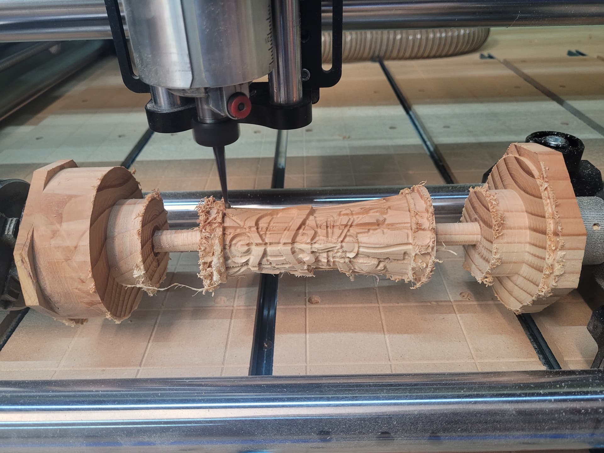

  • I own the 1F Journeyman Pro (BB controller on version 1.6.4, unit of measurement is millimeter) running with Vcarve Pro. The blank is secured with 1” screws.
Question: How do you go about increasing the offset along the X axis? Goal is to avoid hitting the screws that are securing the blank in the chuck.

I think I see the confusion. I am having the 1F automatically set my XYZ. @Ken5 was mentioning to manually set my Y in the center of the blank. That was not my ultimate goal.
My work around is to create a couple of vectors on both sides of my image. The vectors will be pockets and that will create a stem for my piece.
